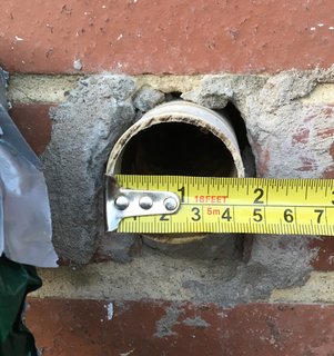

I can’t work out which compression elbow has been used. I’ve only removed the sink waste elbow, but it revealed a 45mm pipe - 1 3/4 inch-ish I guess. All I I can find, though, are McAlpine ISO 1 1/4”, 1 1/2” and 2” elbows.
I’m a bit stumped, to be honest.
Any help would be appreciated. Thanks.

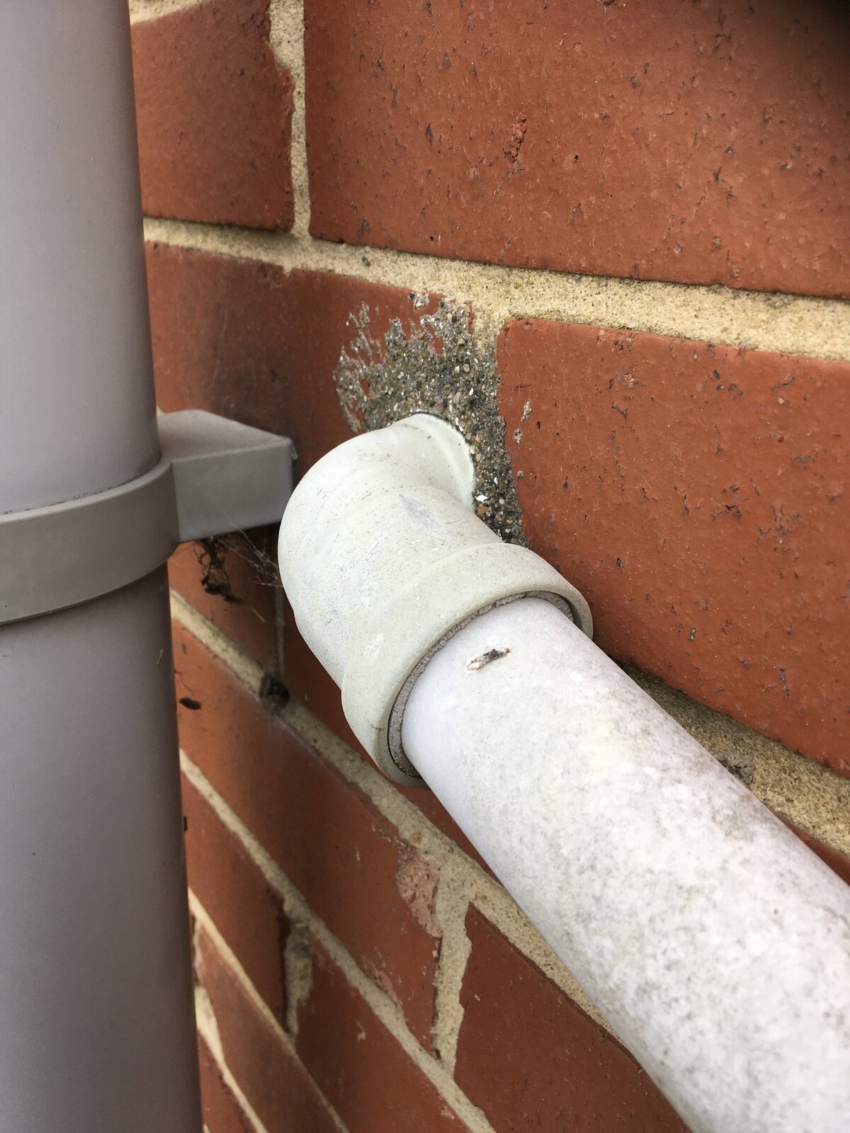

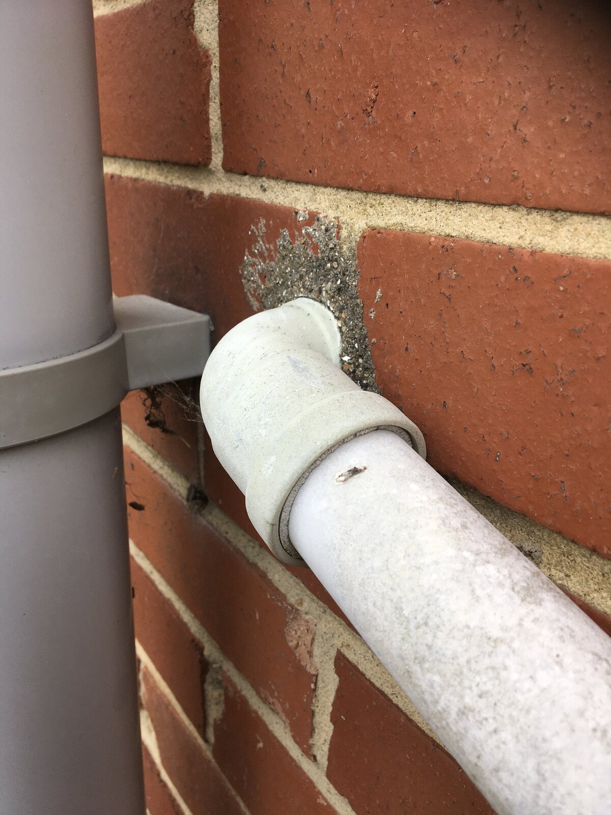

The elbow in your pic isn't a compression elbow ,it looks like a push fit. Did you just pull it off the pipe ?
Show us pics of fittings internally on that pipework.

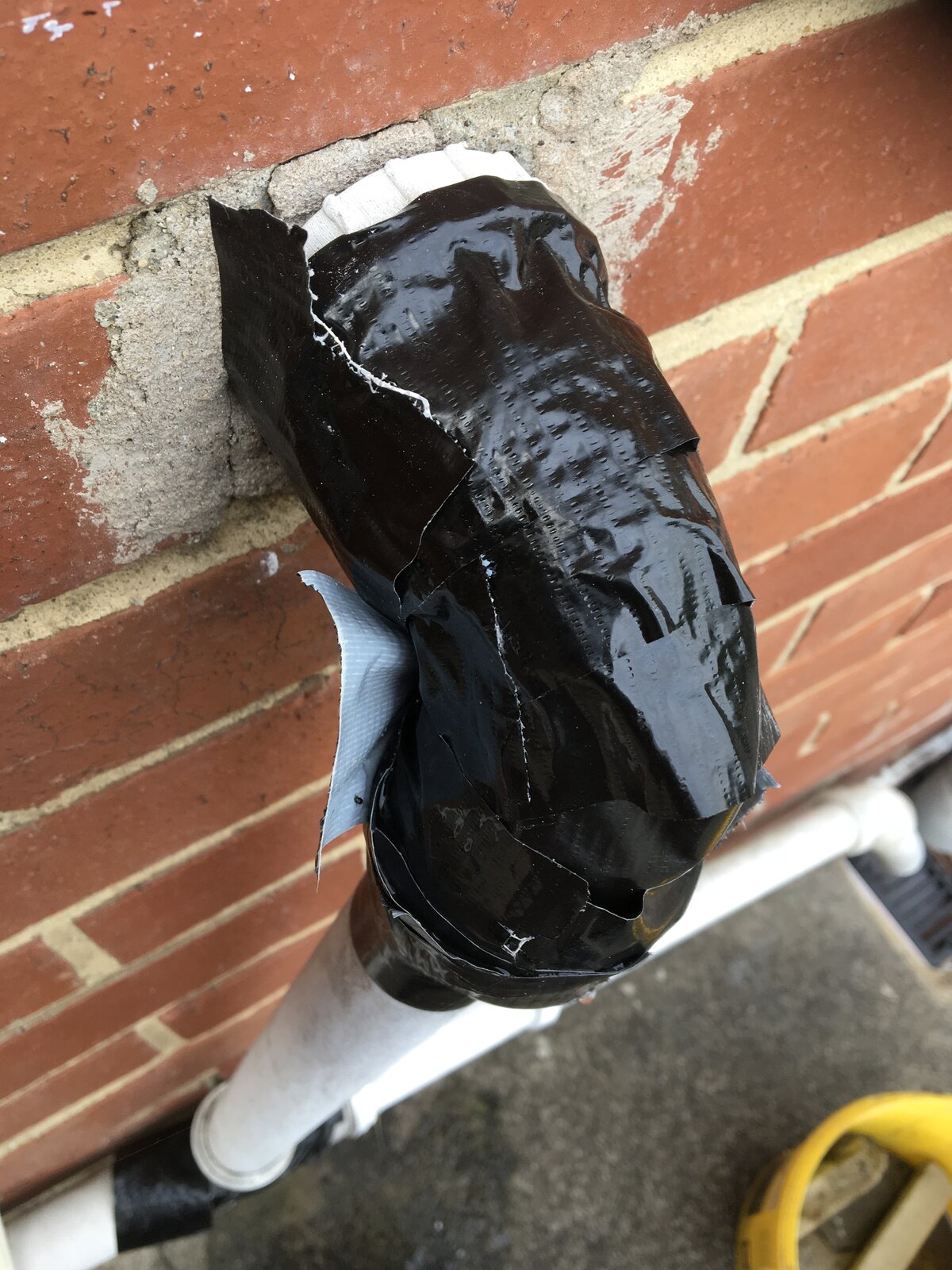

I’ll have to take off the tape-covered one tomorrow (the only one being replaced), as it’s too dark now, unfortunately.
I put the replacement push-fit FloPlast, that I had intended to fit, up to the outlet pipe, but it was far too small. I hadn’t realised the outlet was bigger than 40mm. I liked the idea of all the pipe work being one ‘style’, before I discovered the compression fitting was there for a reason. That’s when I started looking at ‘reducer’ fittings and found this Screwfix thread, with a similar ‘45 to 40mm’ problem. He solved it with a McAlpine MT4 ISO, but I don’t see how.
The collar around the fitting definitely looks like a compression collar, but I’ll have a better look tomorrow.
I know I shouldn’t have pulled it off (gently), but because it’s so brittle, I wanted to use the least mechanical force, in case it had to go back on.

Sorry about the photo, but it is the best I can do. The bag and tape are holding the everything together. I assure everyone that it is a compression elbow.
Your original pic shows a fitting without any tape ,that doesn't look like a compression elbow. The one wrapped in tape is a compression elbow.
It looks like the pipe is 1 3/4”, though, unless I’m mistaken.
All solvent weld (SW) waste pipe in the UK is either 32mm (36mm OD) (11/4"), 40mm(43mm OD) (11/2") or 50mm (56mm OD) (2"). That pipe isn't 50mm, it's 43mm by the looks of it.
Pushfit OD sizes are the standard 32/40mm but both push fit and SW will fit into a compression coupler.
