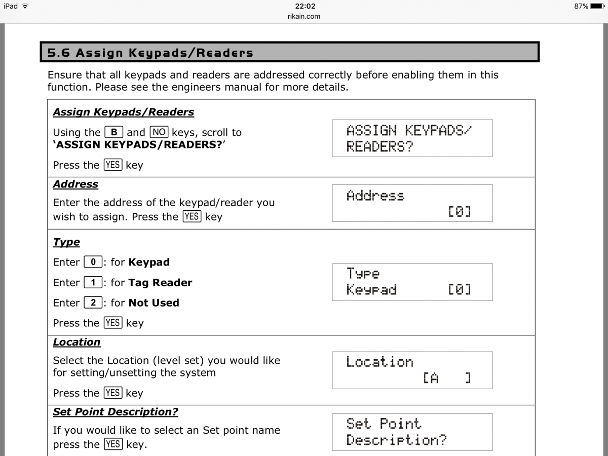

I've gone into ASSIGN KEYPADS on the panel and set to ADDRESS[0] (only have one key pad) and set the same on the external keypad. When I come out of engineer mode, I get a panel alarm and "485 Bus Fault".
Prior to this, I am able to go into the external keypad's menu option (holding down D) and set everything up.
Am I missing anything?
Assign keypads & readers menu, make sure adress 0 & 1 are set to keypad.
Press & hold D on the extra keypad & set this to 1 then exit. Press & hold D on panel and make sure this is 0. Go in & out of eng mode to save changes.
Blimey that was it! So Address [0] is the internal kaypad built into the panel? All working now thank you
Spoke too soon! The keypad works fine, but if I go into the keypad's Security Menu (holding D), whenever I exit by pressing A, I get "485 Fail Kpd" and the internal alarm sounds with the yellow triangle. Same as if I do this on the panel's keypad. The panel's keypad is set to [0] and the extra keypad set to [1].

In panel menu is keypad ( address 1 ) set as a keypad ?
Yeah this does seem to happen, after exiting the keypads internal menu you get a 485 Coms lost then it comes back online. I wouldnt worry about that. As long as both keypad panel are working.
