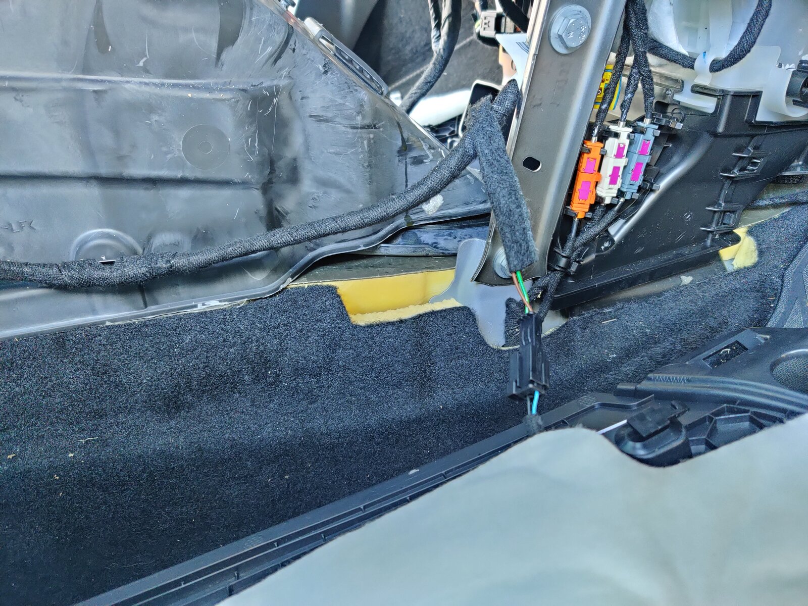

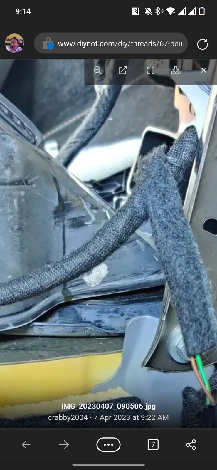

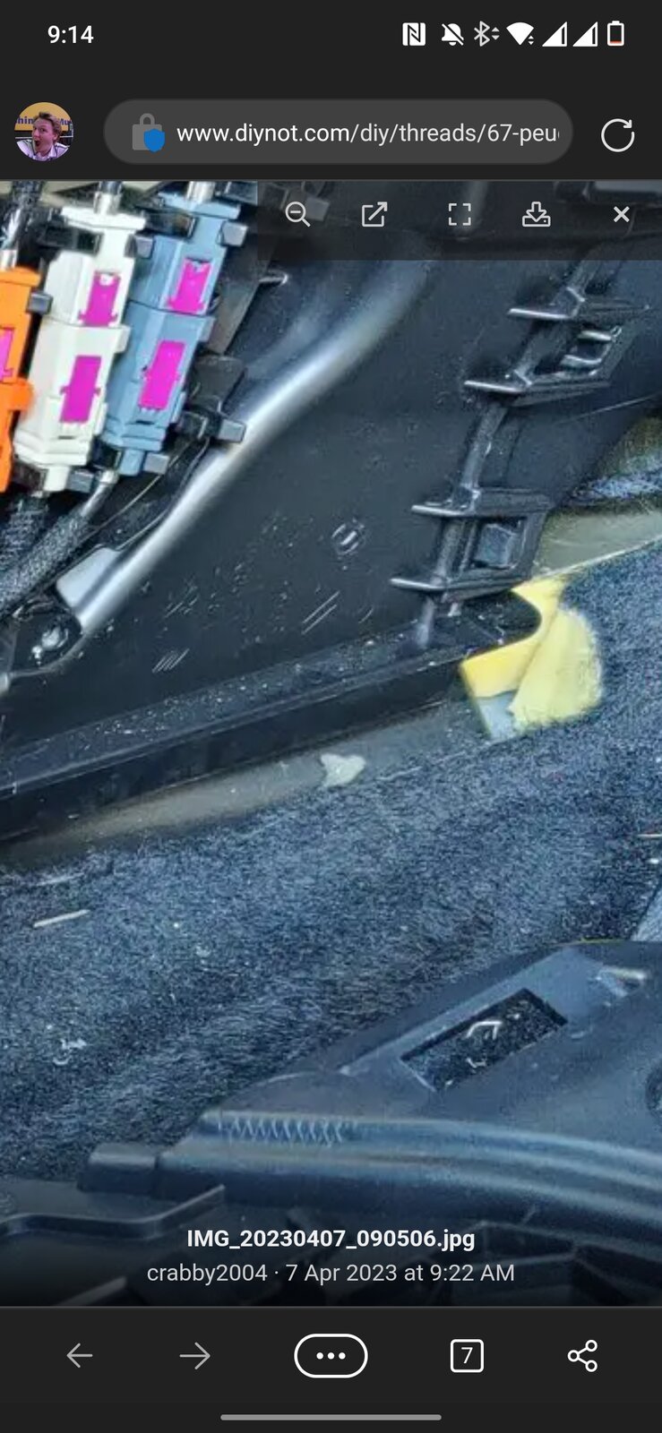

First half hour today has identified the square root of F all... Found some more foam when I removed a few of the panels, but still haven't identified the source of the foam (pic attached). Anyone got an idea what this light grey foam could be? There was a pretty substantial amount in the footwell before I vacuumed it (maybe 30 or so of these size pieces).
Haynes manual has been pretty useless so far... I know I need to get to the airbag control unit and that's somewhere between the front seats - but it provided literally no information on how to get to it. Regarding the signalling lights, there's no electrical diagrams just a statement of what the DTC is which I already knew... so with only half the puzzle I'm no closer to knowing where the two sets of cables "meet"... Which means I'll just keep pulling until I spot something I guess.
I can't see any evidence of foam attacked by rodents in that picture.
Are you sure its not just an electrical issue? It is French. Do you have evidence of rodents?

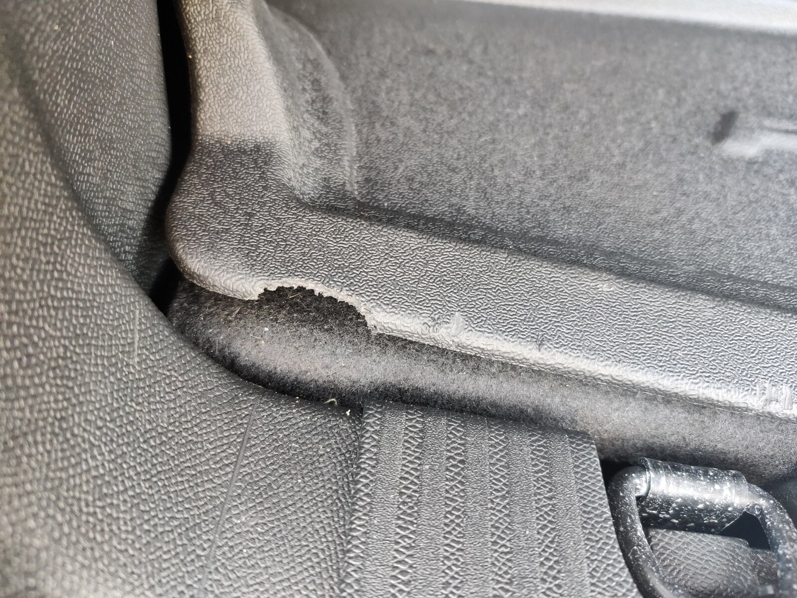

I've attached some zoomed in pics of that photo... You see the little grey foam spots? They're just bigger than a pea and these are the ones I've found behind the paneling but there were loads in the footwell before I cleaned up. I've also attached a picture of some nibbles on my boot protector.
Have you caught the mouse?
Nope...but I did leave all the doors open for the following day, followed by multiple mouse traps and a fully cleaned car... No more alarm issues and no errors on that system so no I eternal movement since and it's been a couple of weeks so if its still there it's probably dead - no bad smells, no further activity in the car. Of course if I end up pulling the dash and finding where this foam has come from I'll be pretty confident because it'll either be vacated or I'll find a body.
Next task then... Figuring out how to remove the vehicle wide panel from the dash :(
