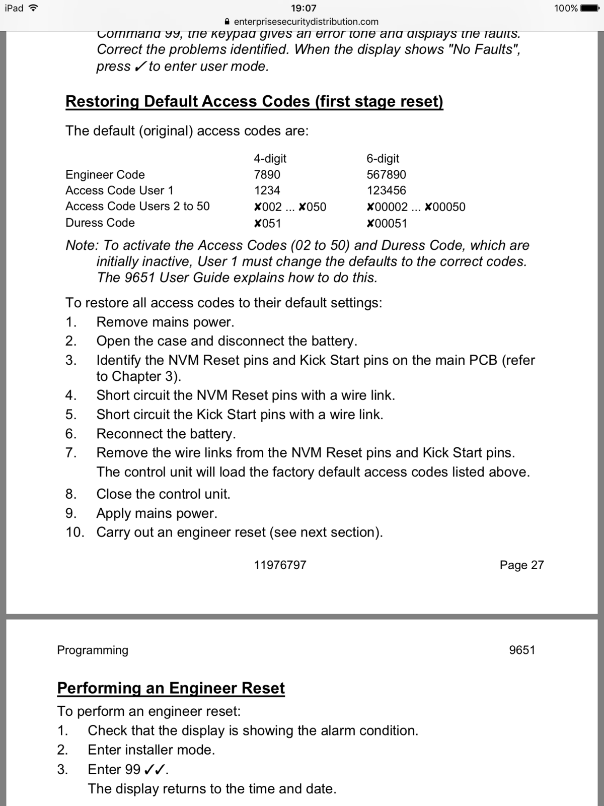

Hello all,
Just moved into a new flat with a 9651 wall panel but no prior access codes. Anybody know how I can reset the system so I can choose and use my own codes?
Alternatively give me a number for a qualified and reasonably priced engineer in SW London!
Thanks in advance.
J
IMG_2180.PNG Google 9651 manual
