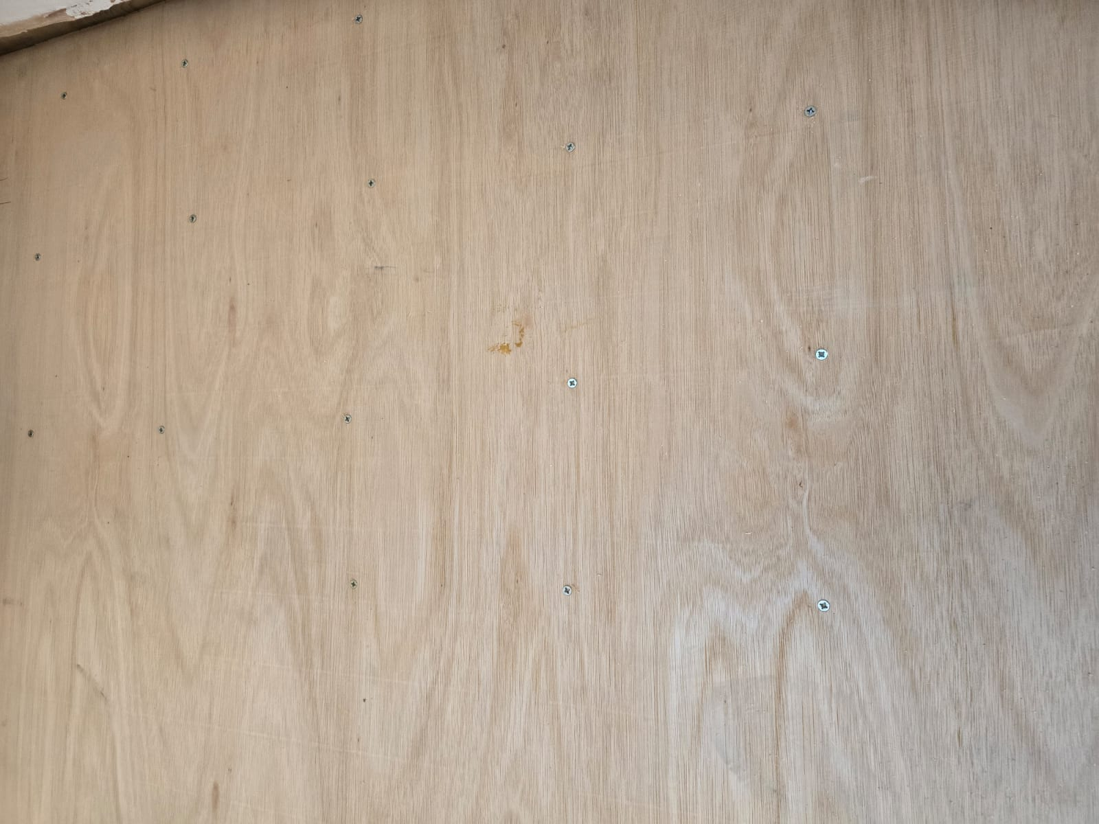

Hi All.
I have just installed 9mm plywood on floorboard ahead of the installation of LVT glue down. from my reasearch, I understand one needs a feather finish to level the floor and the joints. Here is my question, does it have to be a product like ardex feather finish or a levelling compound ?
Thanks in advance.
Feather finish won’t level the floor. You put that on 1mm to hide joints and screw holes.
Fibre screed goes on 3-6mm thickness. You can do some levelling with that if needed.
