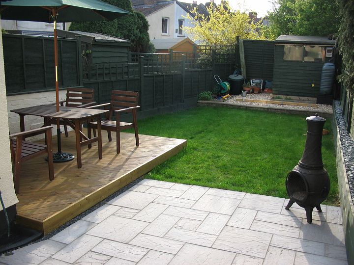

Hi. Well I think the short answer is decking is easier, but since the area you have is quite small, I'd personally prefer to go with Patio unless there is a cosmetic reason for decking. I decked the area at the back of my house a couple of years ago because it was quick to do and cost a tenth of slabbing it. A good excuse to show a photo! Its got better with age, I don't oil it just leave it natural and clean it with jet wash every spring. Its now gone to a natural white look which we like.
Personally i only do decks anymore for sloping or problem sites. They are cheaper but 95% of them look shabby after 2 years and downright awful after 4/5. Not to mention they can be horribly slippy when damp.
I try to advise people towards a patio as it will obviously considerably outlast decking and is generally much more useable but even a basic patio will come in at nearly twice the price.
If the area in question is in full sun and gest good air circulation it may be ok but if its at all shady or damp definately steer clear of decking.
Nice job, I love decking.
Be careful tho, make sure you use an oil based preserver, I used Cuprinol rollable and it is rubbish! Peels and cracks and wears. Lasts 9 months.
I'm in the process of removing it and oiling it.
