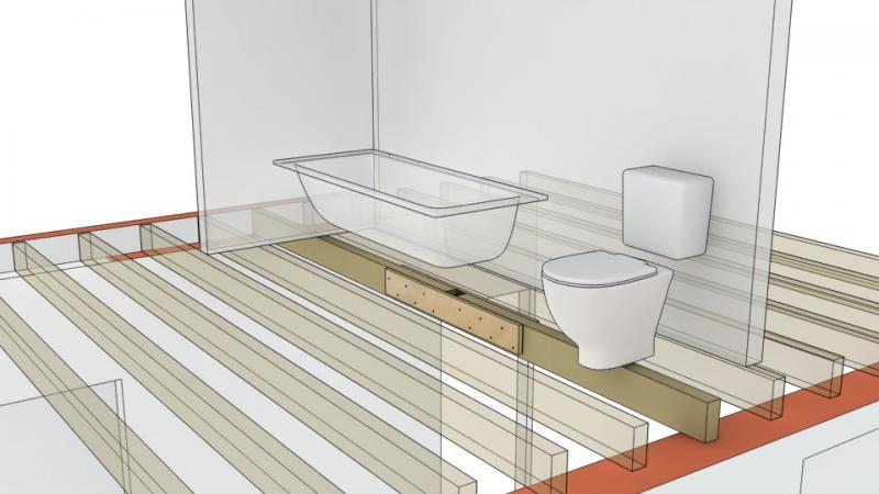

Pictures describe it a lot clearer.
Total run of reinforcement, 600mm either side of the notch. Depth to match joist depth with a small clearance at the bottom for plaster.
I suspect that although only 28mm thick in total, the lamination will at least match and hopefully exceed the stiffness of a single thick piece of timber, and being relatively thin have the advantage of being more easily manoeuvred into the floor void ripping the bare minimum of floorboards which, as you say, are helping the situation a lot.

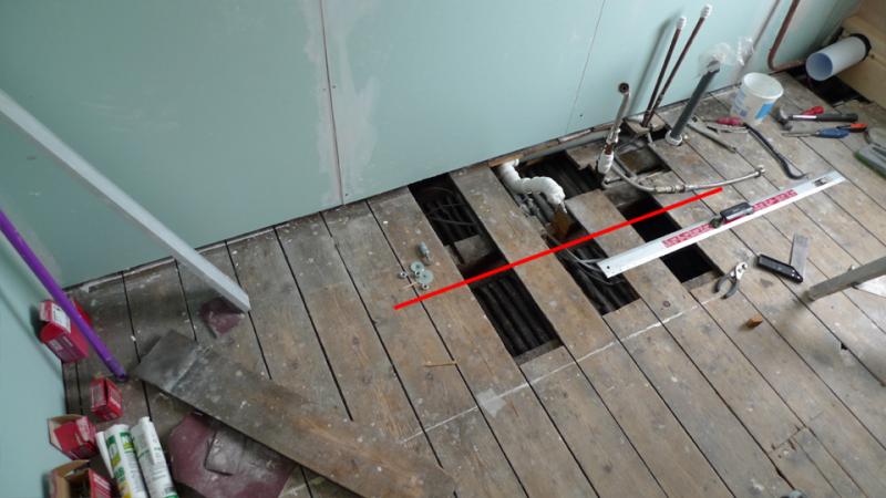

The picture shows the bath footprint area, to the far left is the return wall with the bath standing in that corner.
Red line is the extent of my intended reinforcement, 1200mm.
The bathroom and adjoining room were originally one single large space which was divided roughly half and half. The partition was evidently fixed directly down onto the existing boards, which do span both rooms. Some of the boards were cut for plumbing way back, I have not disturbed a single intact span thus far.
Of the three existing gaps in front of the damaged joist I created only the right hand side one, the board which covered it in any case didn't span the joist, just rested on it - the section behind was cut for the pipework. The left hand gap is an existing trap, covered by a board which wedges back under the partition at its end.
My own sentiment was to cut as little as possible and I'd appreciated that the floorboards were helping to support the joist, but I realised I still needed to get in there.
Provided I can get the materials into the floor void as is perhaps I should look into trying to work within the existing access space as it is: lights, mirrors, rig up a webcam even which I've used before to investigate various tight spaces. The board to the right of Gap 3 is already compromised, I could relieve that one enough to get the gear in.

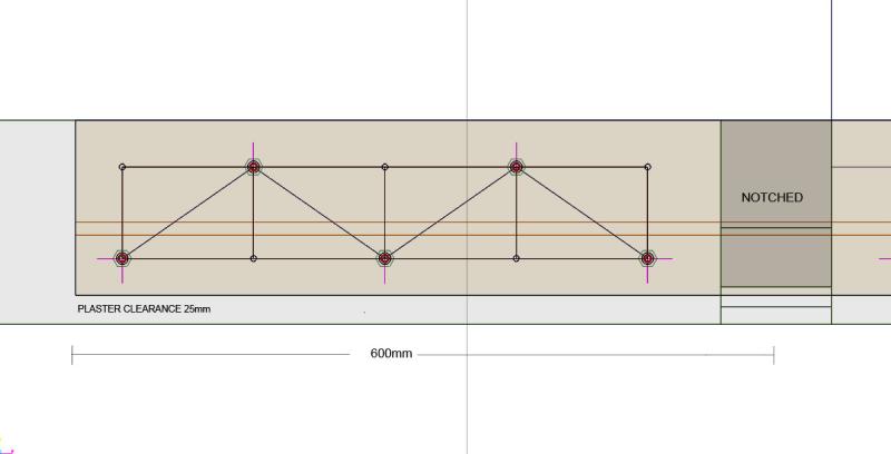

Before going ahead, it would be good to run the intended bolt pattern past the jury.
10mm holes for M10 bolts, staggered. The gap at the base to clear the ceiling plaster means the pattern is slightly offset vertically on the plates to keep all holes 2" away from top and bottom of the joist.
Having read various guidelines on drilling and notching, I don't like taking any more material out of the joist at all - but to make a repair more holes have to be made; I've opted for what I think is a reasonable distribution of smaller holes rather than fewer larger ones.

why not just bolt on an i beam from your local fabricators get them to drill a seris of holes in it and using coach screws bolt the bugger up,once joist has been lifted and leveled of course.
Your bolt spacing looks fine, but why put the steel plates in? Surely the plywood pieces each side would be enough on their own.
(Incidentally, 10mm coach SCREWS would take a greater shear load than 10mm bolts, though of course you would have to stagger the screws each side so they didn't foul each other).
Personally I think it's over-engineered, but far better that than something just cobbled together!

Re: Tony on the coach screws, didn't realise they were actually stronger in use than bolts. Pilots for screws certainly a lot less hassle than aligning through-bolts. The commercial plates specify screws too, perhaps not just for ease of installation then. I also noticed that part-threaded bolts have a smaller diameter on the shank than the thread OD - fully threaded or rod would be preferable where any play needed eliminating
As to the 'over-engineered' - when I got hold of the materials that was the first thing that occurred to me :)
Without the expertise or experience, my instincts have probably led me to exceed the requirements, but like you say better too much(within reason) than too little.
Why both in my idea? Plate steel was a lot cheaper than a set of commercial flanged plates and I thought the ply backing a good substitute for the stiffness a flange adds to a plate... though a single strip of either material does look pretty meaty by itself
