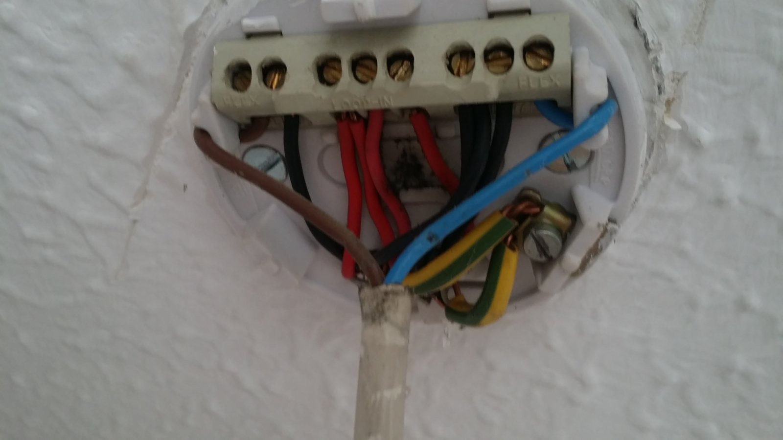

Being a novice, can you explain why I have 4 red and 4 black and 4 earth wires in this ceiling rose instead of the expected 3? There is only one light here but it can be operated by 2 switches. I thought that normally the two switches would be connected so I am wondering if in this case the light is directly connected to both switches, but this is just a novice's guess!
Could be the circuit branches off at that point and feeds two downstream lights.
Ah ok, thanks very much. Either way I have copied the wiring shown in the photo for my new light fitting and everything is working so hopefully all will be ok.
Yep - my landing light is the same. At least it was until the top of some old, reused metal conduit cut into the cables running into it. A quick trip into the loft turned into some strategic rewiring given that I don't want to take any plaster off on the landing just yet!
I've only been in the house 18 months and that's twice that a "quick trip into the loft" has resulted in an afternoon of rewiring.
