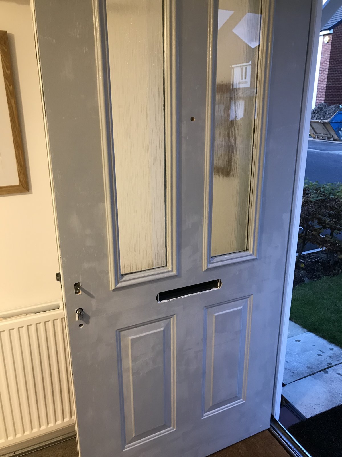

I have cleaned and keyed the metal front door and surrounding wooden frame, ready for masking and priming.
My father in law has just given it a final rub over, I believe he used IPA (not the beer, Isopropyl alcohol) instead of meths - will this be a problem?
Also, I’m priming it with Zinsser Bullseye 123 before going over with dulux weathershield (in Dove Slate) - will it be a problem if I leave the primer on overnight and do the dulux tomorrow?

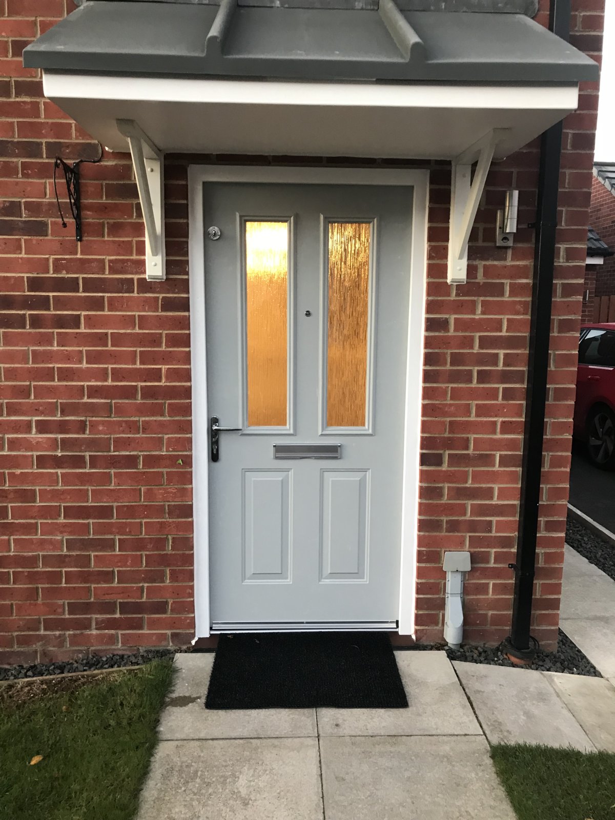

Managed to get the first coat of top coat on today, started about 10.30am. Was probably a bit cold (~5C) but by 12ish it was 9C.
Was dry enough to put the metalwork back on by about 3ish, but will definitely need a light rub down and another coat (will probs be Saturday at the earliest now).
The Dulux Weathershield Satin is quite thick when brushing it on, not that nice to work with. Can it be thinned slightly or am I best not to for the 2nd coat?

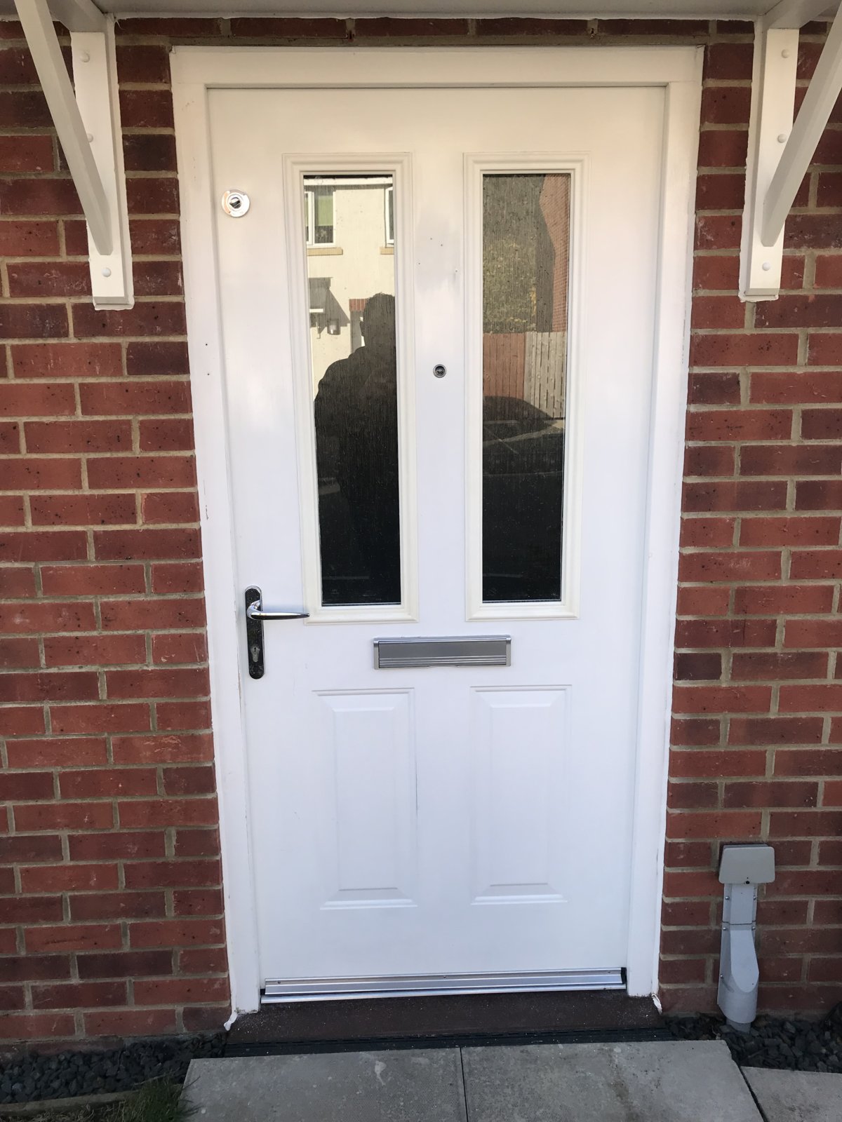

Use frog tape around the glass, I didn't and it pulled some of the paint off, when I removed it.
Did you let the paint dry before removing it? I usually take it off when still wet, and reapply if doing another coat.
But yes, used green frog tape.
You can thin the satin weathershield with a little water, floetrol would be better but it ain't cheap and you will need to buy much more than you need. You will probably find that the second coat of satin will flow better than the first. You can still thin it though.
I have no idea what the minimum temperature that it can be applied in is though. It is part of the Dulux Retail range so they don't deign to make the info readily accessible on their site...
https://www.dulux.co.uk/en/products/paint-mixing-weathershield-quick-dry-exterior-satin
Perhaps you can turn the heating up, leave the door open so that the surface temperature increases and leave the tin just above a radiator so that it becomes more viscous.
Airflow (eg a fan) will help the curing process. Waterbased paints work by letting the water evaporate and the remaining molecules coalesce (knit together). In cold weather they are far less forgiving than OB paints.
Good luck
I personally wouldn't thin it. If it seems a little thick, stand the tin in some hot water for half an hour, this will make it flow easier without thinning it or destroying its covering properties.

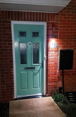

This was a black Upvc front door. Had a grey undercoat and two coats of Valspar Water based Gloss.
