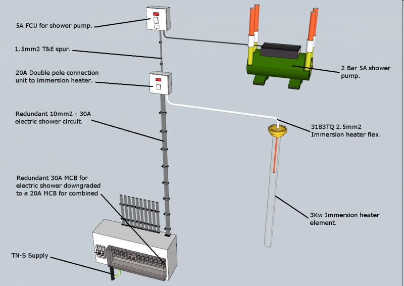

My Central heating is down at the minute so I dont have any hot water. I have replaced an old and failed Immersion element in my hot water cylinder with a new one.
Having read through the forums as to how to connect the element to a supply, I have put this drawing together to show what the setup will be like.
Basically a 20A MCB from the consumer unit will supply the Immersion heater through a 20A double connection unit in the airing cupboard upstairs.
A 1.5mm2 T&E cable will spur of the 20A double pole connection unit into a 5A FCU which supplies my shower pump, also in the airing cupboard.
The immersion/shower pump circuit utilises the old 10mm2 electric shower circuit from the consumer unit.
Here's a sketchup drawing to show what I mean:
Does this look acceptable and comply with regulations-wise?
Thanks in advance for any help.
Steve
