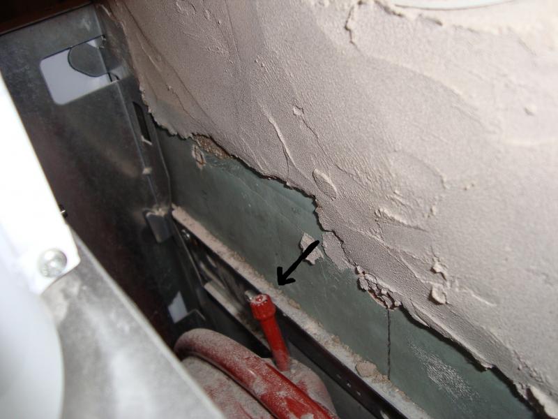

I have a Halstead Ace High Boiler, and think the expansion tank needs repressurising as there is a small but consistent leak from the air vent while the heating is in operation.
While in theory, I know how to repressurise it, and the relevant pressures, I canot see how to gain access without removing the boiler from the wall. Is it possible without removing the boiler?
Thanks.
Don't know anything about this particular boiler, but can you find a Shrader (car tyre) valve on the E V?
This image is a Vaillant, you can see the valve down the back of boiler, looking from above.
My daughter has a halstead ace high boiler and the Schrader valve is on top of the vessel.
