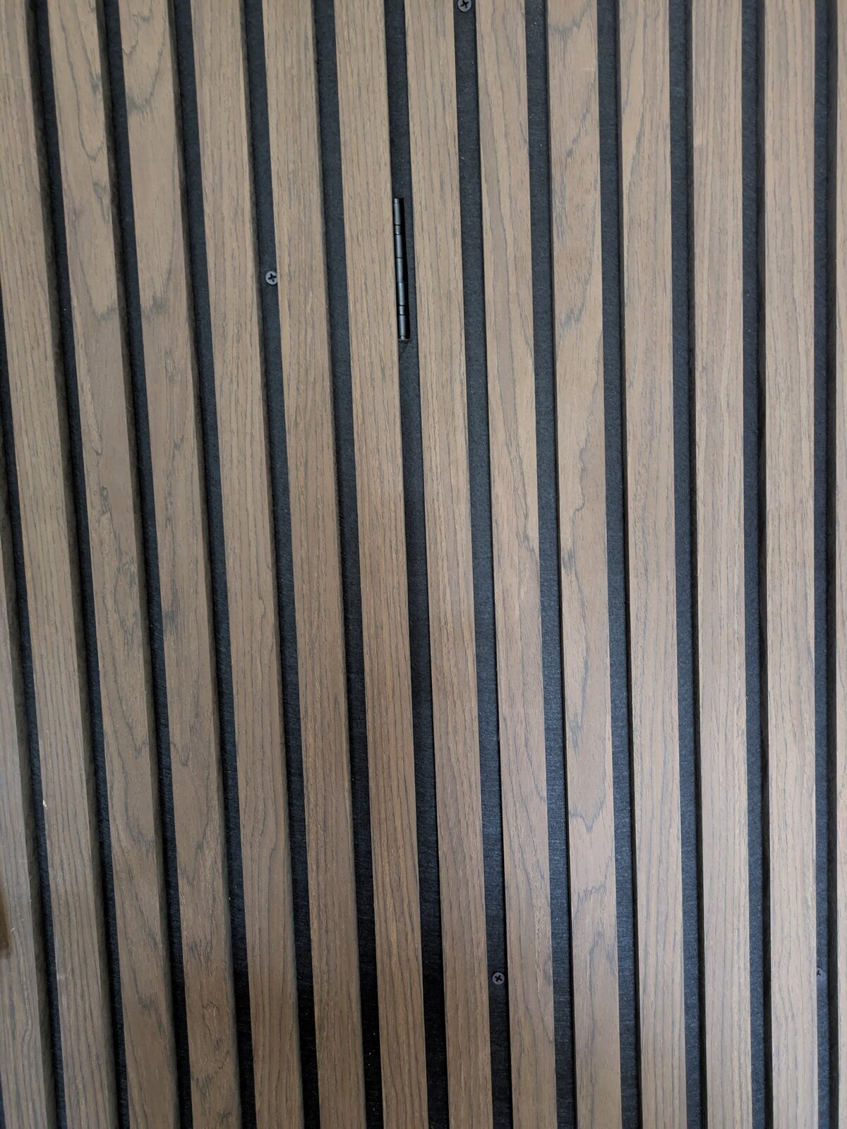

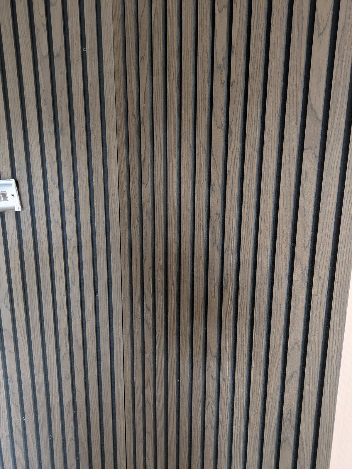

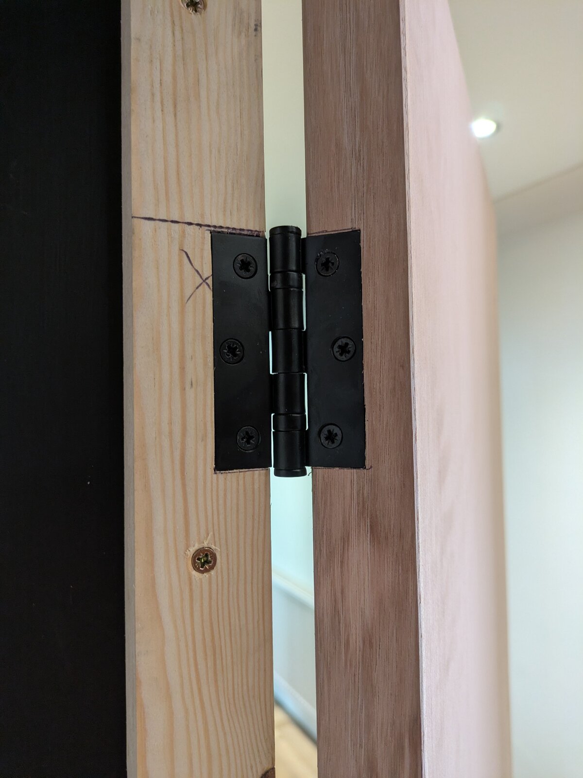

Hi group, installing acoustic panels over a double door coat cupboard, want the doors hidden. However when I open the door, the slat on the door panel is catching on the one fixed to the wall, is there a type of hinge I can get which will allow the door to extend outwards as it's opening.
Thanks, Dennis, West Cumberland.
PS: if you look closely on the first photo you can just make out the hinge, second photo shows door in opening position before it hits the adjacent panel, third photo is the other door detailing the type of hinges I am currently using.
You'll need a cranked hinge to bring the knuckle and pivot point forward to the face of the slats
