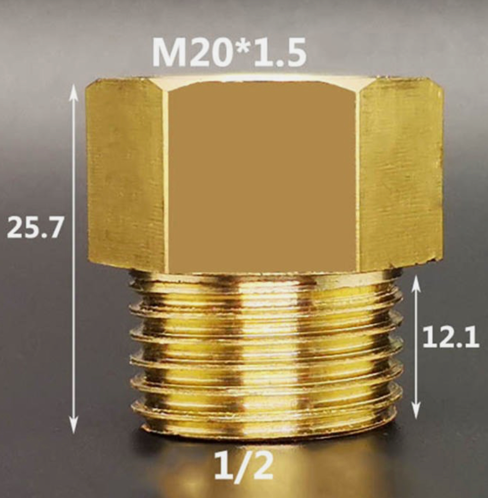

I have a male boss ..... M16x1
I need to connect it to a female 3/8" BSP fitting.
Any of you aware of a suitable adapter - or easiest way to achieve this conversion?
It is not a permanent fixing - but needs to happen as part of testing.
Will run up to 12 bar water pressure

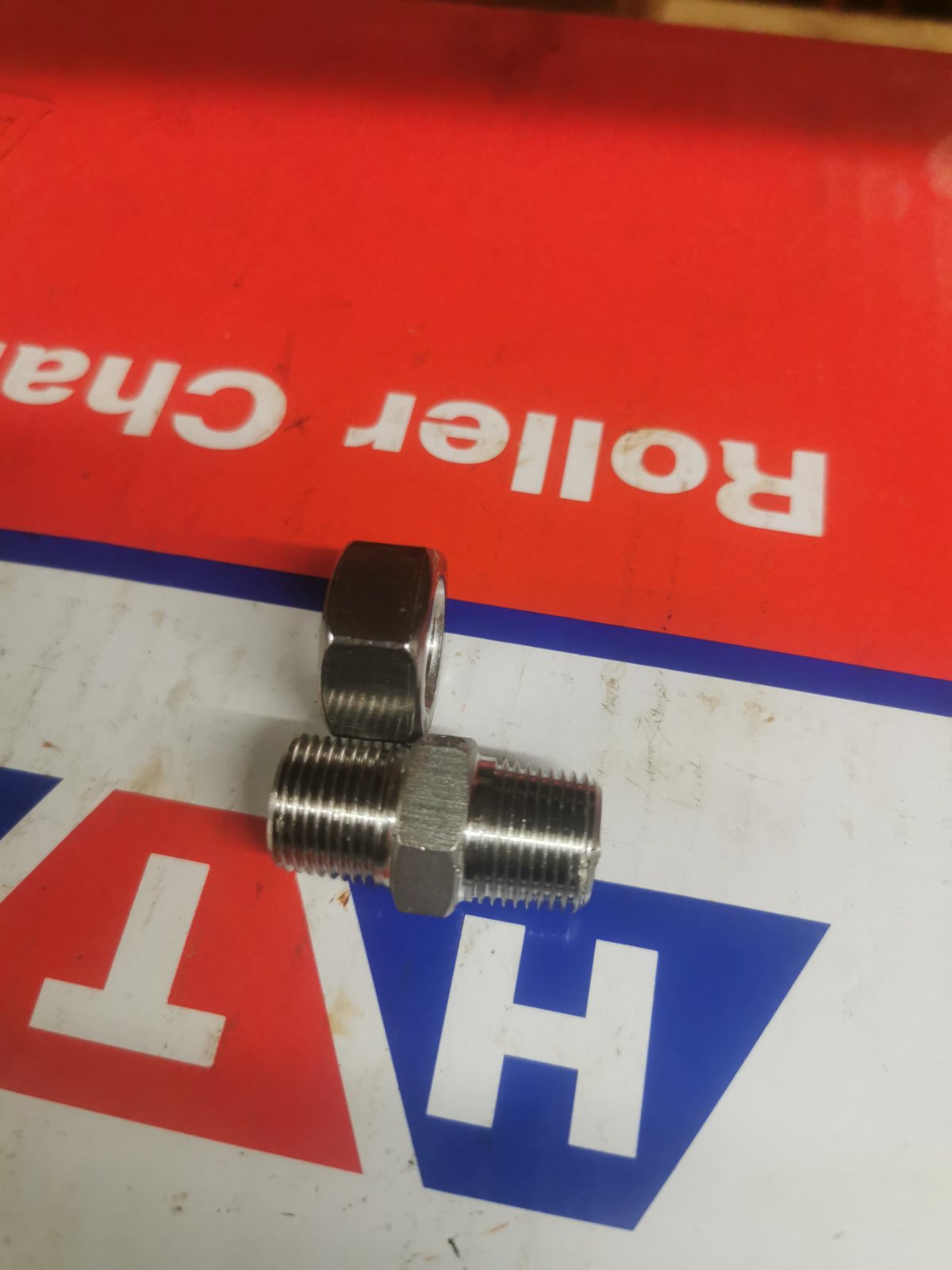

I need M16 x 1 Female to 'any' BSP male
I may need to see if I can someone to turn one up for me.
Don't know if your sorted for this,
If I'm right you basically want that m16 nut with one end of that 3/8 bsp nipple attached to it?
If so I can probably do it Sunday at work, I'll just cut one end of the nipple off and tig the nut to it.
What exactly is it for?
Have since found out what the thread is.
It’s M16x1. (Metric fine). Standard fittings are M16x1.5
So looking for an M-F adapter similar to attached pic … but with M16X1 on the female
end.
