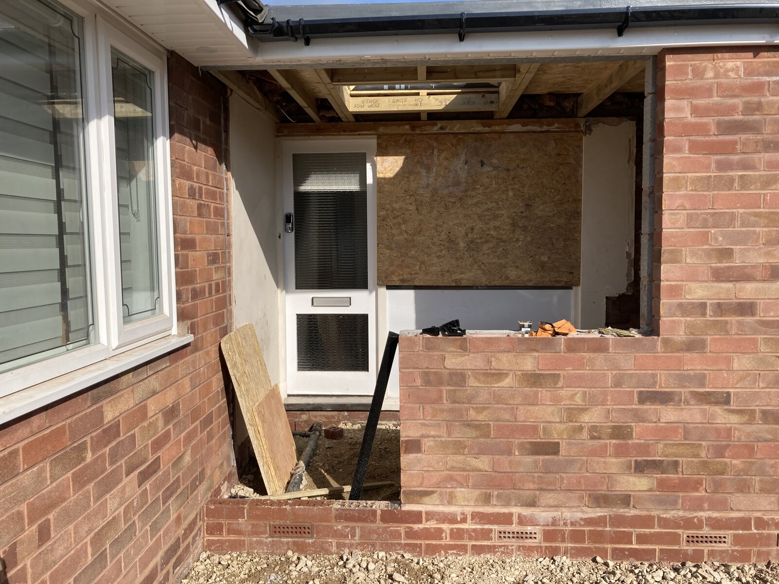

We got a Solidor with an add on strip (15mm) the builder recomended an add on strip because of the door location.
Question is do we glue the strip to the door before we fit it, or, fit the strip to the wall then the door?
My instinct saye we should glue the strip to the door with super glue before we fit the door?

The hinge wall is the outside side wall of the house1.5 m away from the front wall. The lock side is a new wall built as part of a porch. Its only 1 metre high as there is a "Flag" window od sorts to the right of the lock side.
I would say there isnt a frame in the traditional sense as its a wall (house) and a new wall that is end on. Builder says we need an add on because of the side wall. Not sure why.

the opening looks like about 40"

the door was custom ordered using the solidor configurater, i included an add on within the 970mm gap because nI was told to by the builder, he said once the inside was platered it would look better from the inside and open better. I could have ordered it without the strip.

On any pvc door frame where the hinge side is against a wall you specify an add on or frame extender in order to bring the hinge away from the plaster, essentially you make the door 15mm narrower than needed then build it back up with the 15mm extender, internally the plaster should then only cover the extender and be well away from the hinges, in this case the frame needed to be 970mm so when surveying you ask that the 970mm includes a 15mm extender so now the manufacturer will make the frame width 955mm
Hope that explains how a frame extender works on a pvc door frame
In terms of fitting then I normally run a bead of silicone in the front groove on the frame, fit the extender to the frame and screw every 600mm down the middle

Perfect thank you C39. Also, that explanation is a match to what the builder was trying to say. :) The screws @600mm in the middle, they are not the concrete screws? Small self tappers maybe?
Yes self tapers through the extender into the door frame then concrete screws through frame into brick
