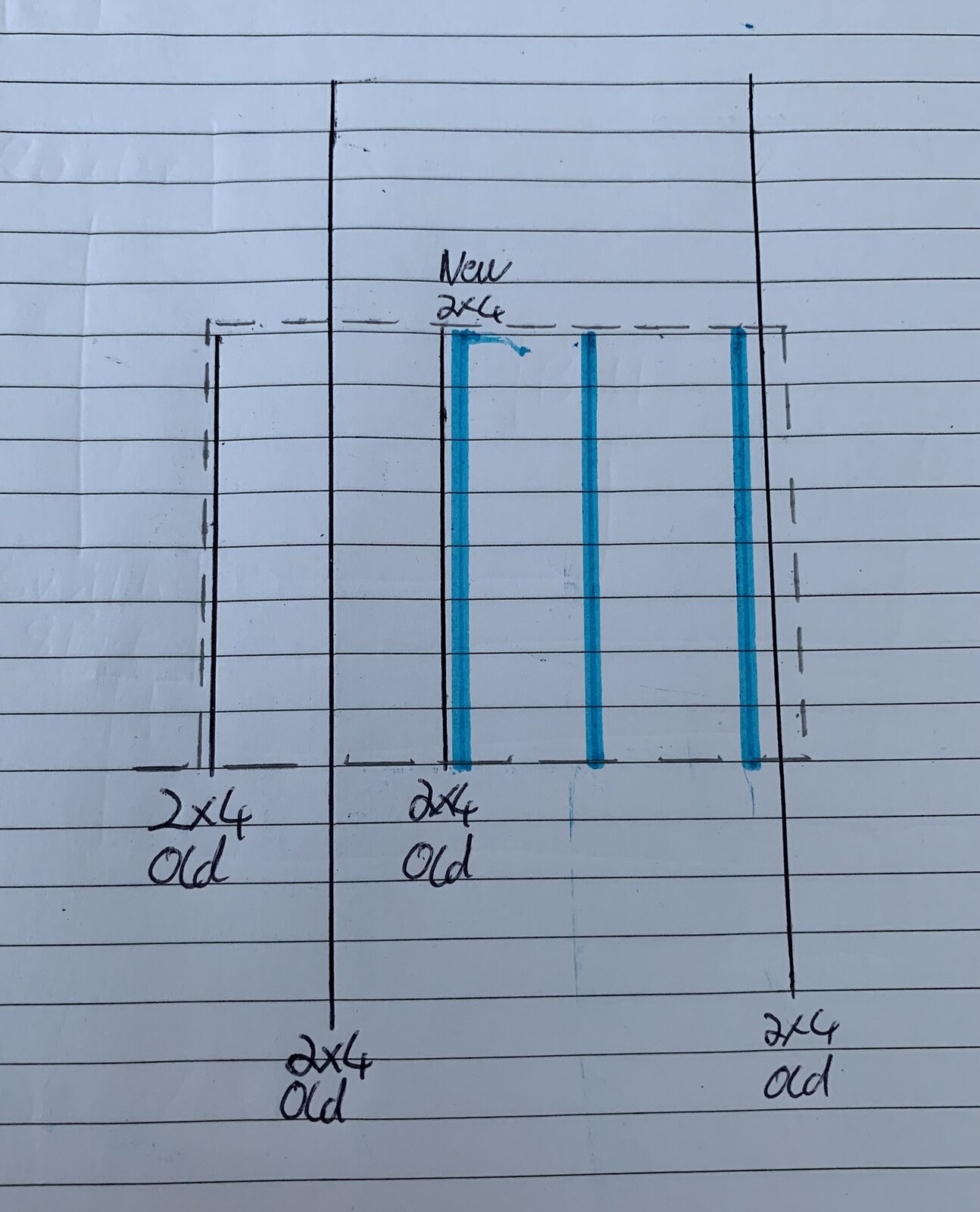

Concern now is the height difference 100mm v 95mm, if the loft boards will sit ok
Would the above do the job, or would I need plywood? Other option is I have a slight dip in the flooring
i.e I have 3 old 2x4 so floor that, then fit a new 2x4 hard against the old and then the new 2 x 2x4 and floor that so there is a slight dip in levels. See attched quick sketch
Or I can order online, 6mm, x50 x 2440

Pine strips will be fine for use as packing. You are unlikely to be testing the limit of their compressive strength in this application.
Thanks, it would be easier to add strips for packing rather than having a dip, I hadn't realised new 2x4 wasn't actually 2x4, amazing the different where you search the photos online.
