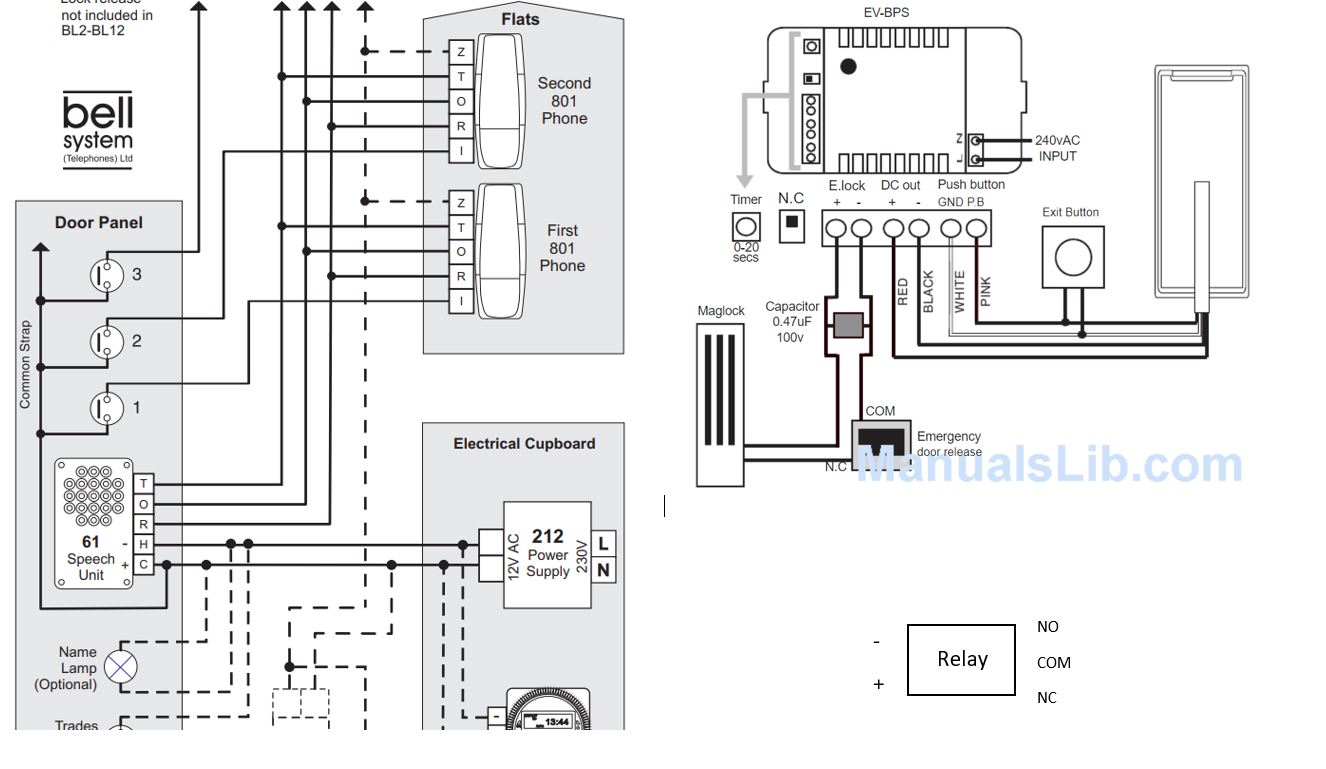

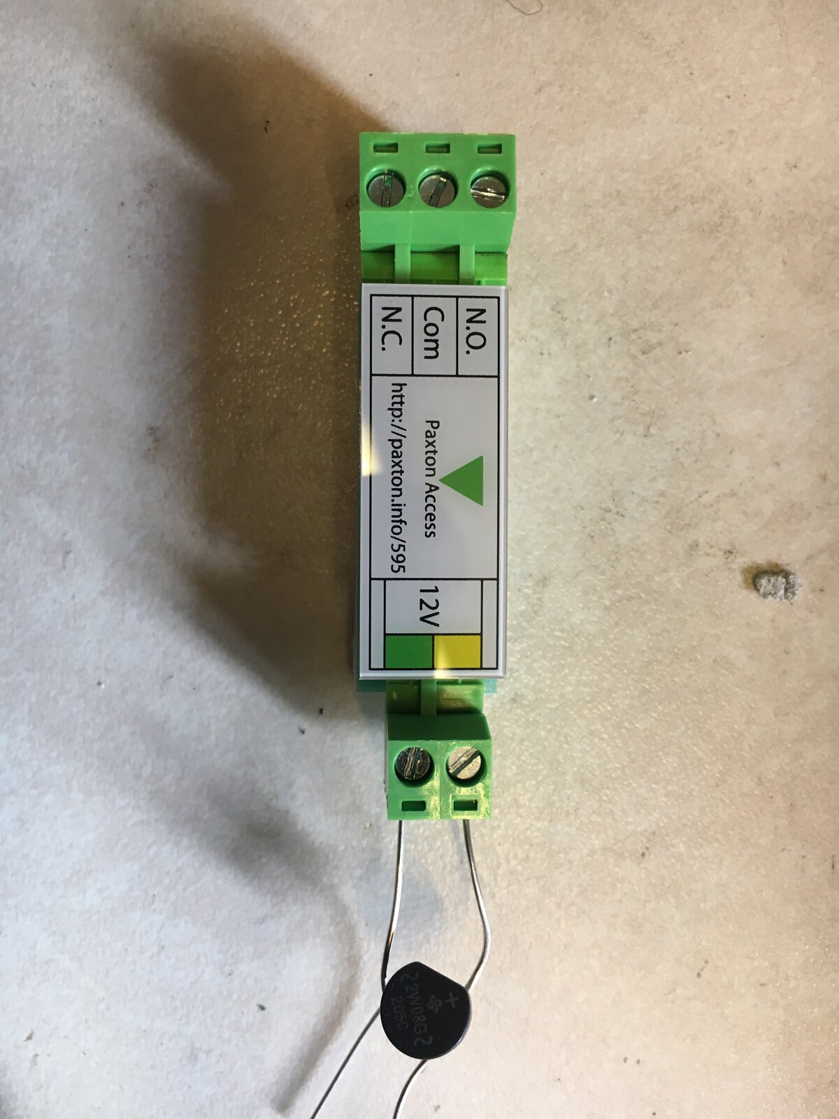

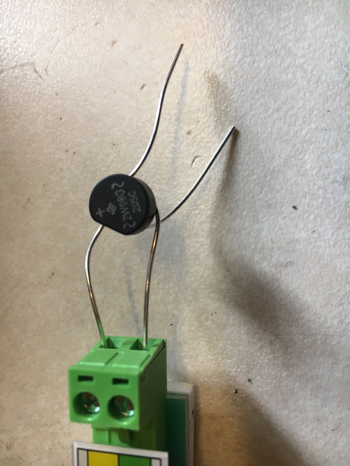

Ok use a bridge rectifier wired ac from lock release terminals ....the dc output to relay + and - , now connect the relay terminals common and normally open to the press to exit inputs on the keypad
