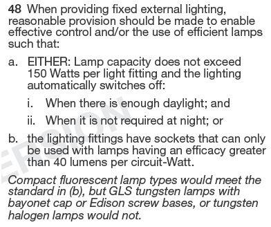

Why on earth do you need 500watts? That's two amps - are you trying to light a football pitch, or something.
Building Regulations only allow max 150W.
We keep getting folk who want to fit 500w lights. If building regs limit to 150w then why do all my suppliers sell 500w and 300w. I have to request 150w and pay a premium.

I was assuming that the cable to the 2-gang switch would be chased into the wall <50mm from the surface so an RCD is required to comply unless special cable or steel conduit is used.
Here's the bit from Building Regs L1B
The RCD aside, I was just pointing out that the conservation regs might not be the same in Scotland as that seems to be where he's from :)
Blimey, Dundee. Didn't know they even had electrcity up there :wink:
You are right though. Part L1B applies to England & Wales so all bets are off re Scotland until someone int eh know can put in some facts.
