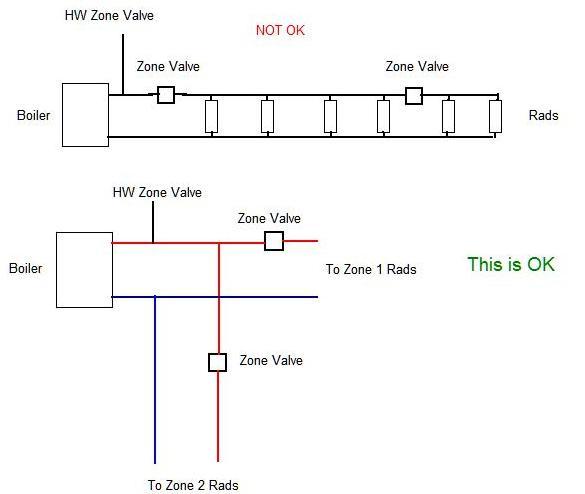

With a (very?) large house (25rads) it probably should have been zoned - normally upstairs and downstairs - with separate time and temperature controls in each zone. Current regulations require zoning if the total floor area is over 150m². However the presence of a three-port valve shows that it has not been zoned.
Converting to two zones will only be possible if the pipework for the two zones is completely separate immediately after the pump.

As for splitting it into two zones then what benefit will this give me? (excuse my ignorance on this matter)
Better control as you would not have to heat the upstairs rooms all day long. You could heat them up just before you went to bed. Again this seems to assume that you keep the bedroom doors closed all the time.
I doubt if a pic of the pipework will help.
The bottom pic shows how the pipework would need to be configured to enable two zones.
