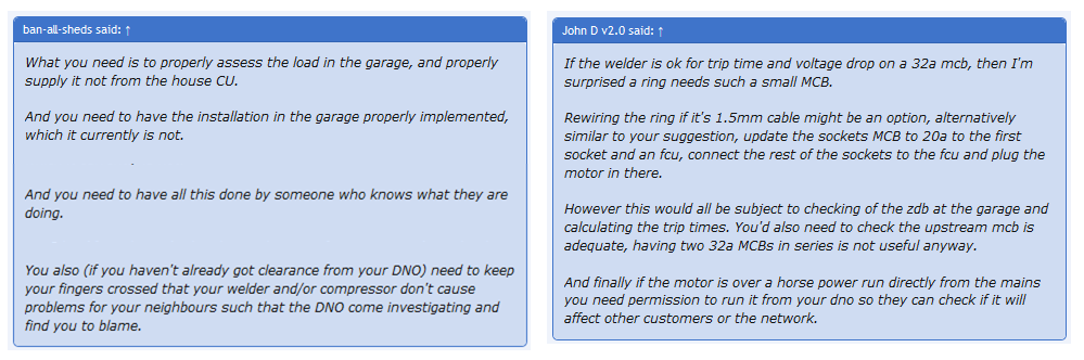

What you need is to properly assess the load in the garage, and properly supply it not from the house CU.
And you need to have the installation in the garage properly implemented, which it currently is not.
And you need to have all this done by someone who knows what they are doing.
You also (if you haven't already got clearance from your DNO) need to keep your fingers crossed that your welder and/or compressor don't cause problems for your neighbours such that the DNO come investigating and find you to blame.
The garage CU is already full with a 32A C MCB going to the welder socket and a 13A B MCB going to a ring.
If the welder is ok for trip time and voltage drop on a 32a mcb, then I'm surprised a ring needs such a small MCB. Rewiring the ring if it's 1.5mm cable might be an option, alternatively similar to your suggestion, update the sockets MCB to 20a to the first socket and an fcu, connect the rest of the sockets to the fcu and plug the motor in there.
However this would all be subject to checking of the zdb at the garage and calculating the trip times. You'd also need to check the upstream mcb is adequate, having two 32a MCBs in series is not useful anyway.
And finally if the motor is over a horse power run directly from the mains you need permission to run it from your dno so they can check if it will affect other customers or the network.
