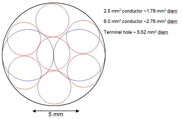

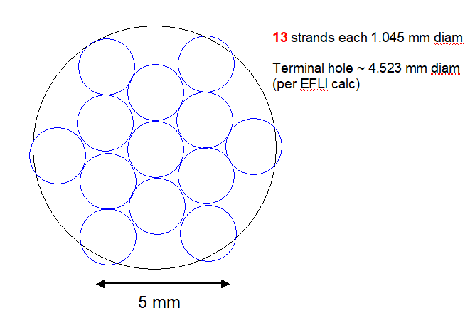

I have read several comments lately about presumably small terminals that I never seemed to encounter, so I have been looking into the required size for different cable sizes.
There is a difference of less than three quarters of a millimetre in diameter between only accepting 3 @ 2.5mm² and 2 @ 6mm² T&E.
I think I did all the sums correctly.

... I have read several comments lately about presumably small terminals that I never seemed to encounter, so I have been looking into the required size for different cable sizes. There is a difference of less than three quarters of a millimetre in diameter between only accepting 3 @ 2.5mm² and 2 @ 6mm² T&E. ... I think I did all the sums correctly.
You may have done your calculations correctly, but I think your conclusions are extremely 'modest'.....
There is, in practice, a complication in that conductors get distorted (cease to be circular in cross-section) when the terminal screw is tightened. However, if one considers the situation before one tightens the screw, with all conductors remaining circular in cross section, then one could, in theory 'just' get SEVEN 2.5mm² conductors into a circular terminal hole that could accommodate 2 x 6 mm² conductors (without distortion). On that basis, getting four in really should not be too much of a problem :) ...
Kind Regards, John
You are forgetting that 6mm² T&E has seven strands (14 for 2); each of which is 1.045mm. in diameter.
Your seven 2.5mm² wires; diam. 1.784; would fit in a terminal of 3 x that - 5.352mm.
Admittedly, this is the minimum geometric size so slightly larger might be required for practical purposes, but a 5% larger diameter results in 10% larger c.s.a.

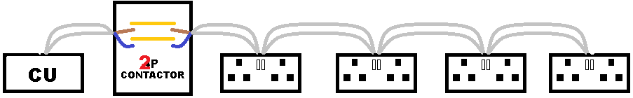

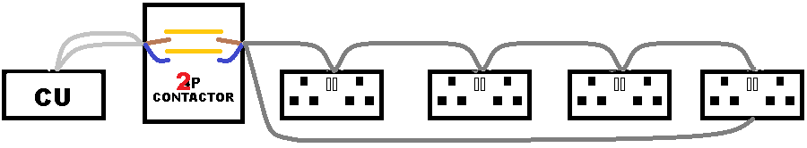

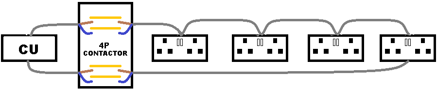

Whether hypothetical or not it was certainly considered as a solution for this incorrectly switched ring:
To this parallel fed parallel fed radial:
But we settled on this parallel fed ring circuit (lollipop circuit):
Good point - I totally overlooked that!
Yep, slightly less than the 5.53mm I was quoting for two (solid) 6mm² conductors.
It does, roughly (as I'm sure you know, actually 10.25%)..

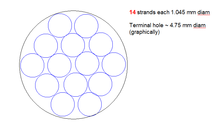

For 14 strands of diameter 1.045mm., the minimum is a circle of 4.523mm.
It's obviously the case that, when correctly remembering that 6mm² conductors are stranded, the minimum terminal size will be less than the 5.52 mm I indicated for a solid 6mm² conductor [and apologies for incorrectly typing "mm²" for the diameters in the diagram I previously posted!].

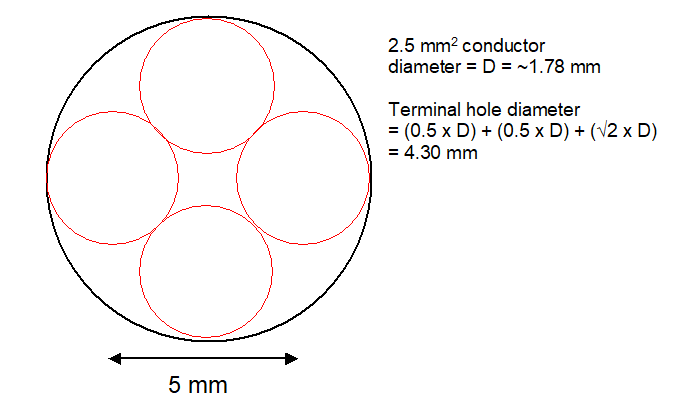

However, even if your figure is correct (it may be, but see discussion below), if I've done things right this time :)-) ), I think that 4 x 2.5mm² (solid) conductors only require a terminal diameter of 4.30mm - so presumably should easily fit into what you state as the minimum size for the 14 strands of 2 x 6mm² conductors, as illustrated by:
However, I wonder how you came up with your 4.523 mm figure? Unlike the situation with, say, 3, 4, 7 or 13 strands, I don't think that there is any obvious 'fully-symmetrical' optimal arrangement for 14 strands and, if there is a general theoretical solution to such a question, I must have at least temporarily forgotten it :) However, in the first diagram below I have examined, graphically the case of 13 strands (fully symmetrical and hence, I presume, 'optimal') and it seems that your 4.523 mm diameter hole is probably not quite (but very nearly) big enough for that, let alone 14 strands.
In the second diagram below, I have looked at what seems to be the 'most symmetrical' arrangement of 14 strands I can think of, and, although I have so far only done this graphically, it wood look as if the minimum required hole size is probably about 4.75 mm, again just a little larger than your 4.523 mm figure.
I may well be going wrong again, but I'd be interested to know how to came to that figure and, in particular, what arrangement of 14 strands you were assuming.
Mind you, the bottom line of all this is that the amount of space to 'comfortably' take 2 x 6mm (stranded) and 4 x 2.5mm (solid) conductors is extremely similar. I have certainly put 4 x 2.5 mm conductors into a socket terminal in my time, and I suspect that, in practice, space for everything in a backbox is probably more often a difficulty than the terminal capacity.
Kind Regards, John
Whether hypothetical or not it was certainly considered as a solution for this incorrectly switched ring: .... To this parallel fed parallel fed radial: .... But we settled on this parallel fed ring circuit (lollipop circuit): ...
Fair enough, and that's certainly what I would have suggested (unlike some, I personally have no particular problem with 'lollipop' circuits - and, indeed, have some in my house). Quite part from the fact that it may represent the 'contentious in some people's eyes" circuit we have been discussing, the 'middle option' would have required a lot more work.
In any event, even if you had gone with 'the middle option', I suspect that you would not have gone as far as the hypothetical example I mentioned - since (assuming it was all 2.5mm² cable), I imagine that you would have left the OPD as 32A there, rather than 'upgrade' it to 50A, wouldn't you?
