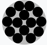

What matters is cooling, so 2 x 2.5 mm² does not equal 1 x 5 mm² as it is the surface area around the cable that matters. Permissible to use 1.5 mm² mineral cable for a ring final, but not ali-tube as the ali-tube cables does not transmit the heat to the outer casing as well as mineral cable.

Assuming that you are talking of 2.5mm² cable, as you imply, a ring with one socket together with an unfused spur wired with what is effectively 5mm² cable supplying three (or 30) further sockets is perfectly compliant.
