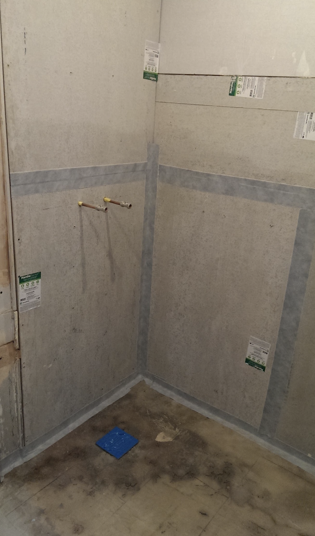

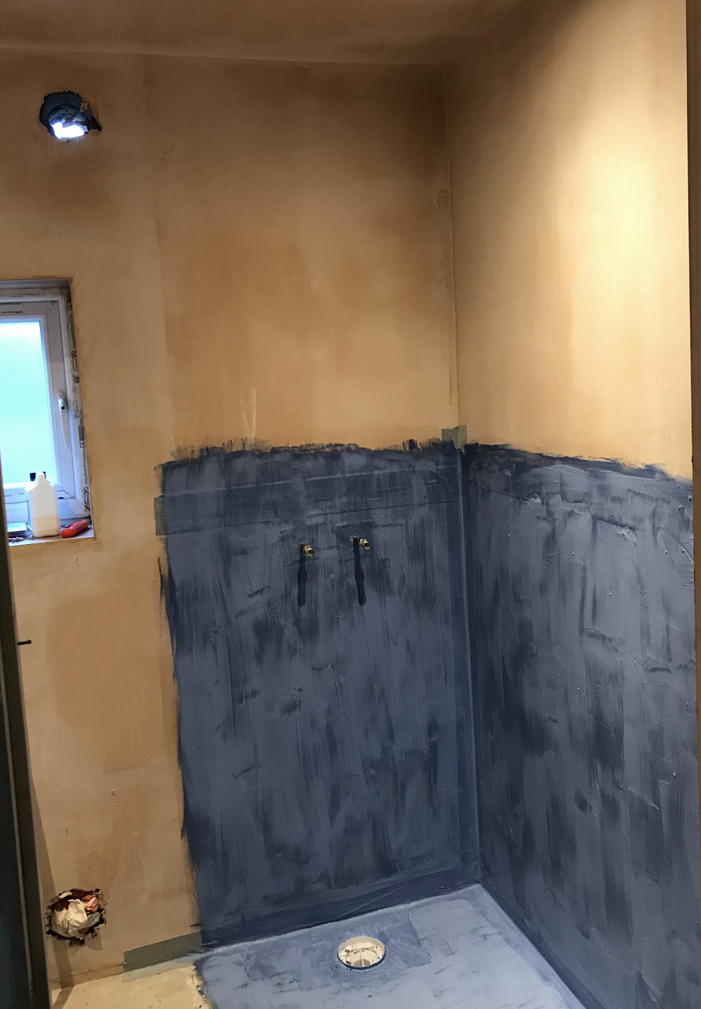

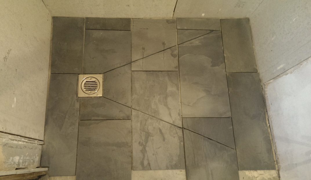

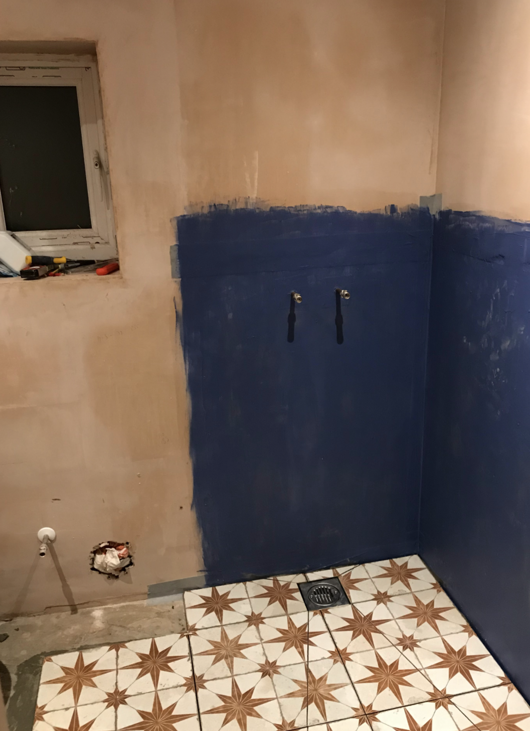

Re. the wet room I’ve done a couple, one on S&C screed, another on concrete. Both times, I just freehanded the semi dry screed with my trowel a half decent fall around a couple of foot of the trap, which was obviously already in place at that point. Both times, tanking and tiling were all good.
The formers are probably a good shout, but I’ve never bothered on a solid floor.
Now that looks great. Exactly what I am looking for but with a linear drain. I believe a mud pan is a good option. It's just how much screed at the bottom of the fall is not enough. Maybe 10mm of screed on the pir would crumble?
Thanks for replying
Yeah you wouldn’t want to go anywhere near down to 10mm, you shouldn’t need to either, it’s only a slight fall from the main floor level. I just scraped the top few (10 mill?) away around the trap and feathered it out. You can, later, adjust things with a bit of self levelling and/or your tile adhesive bed thickness to get it bang on…all depends on the room shape, how much risk of it running where you don’t want it etc …
