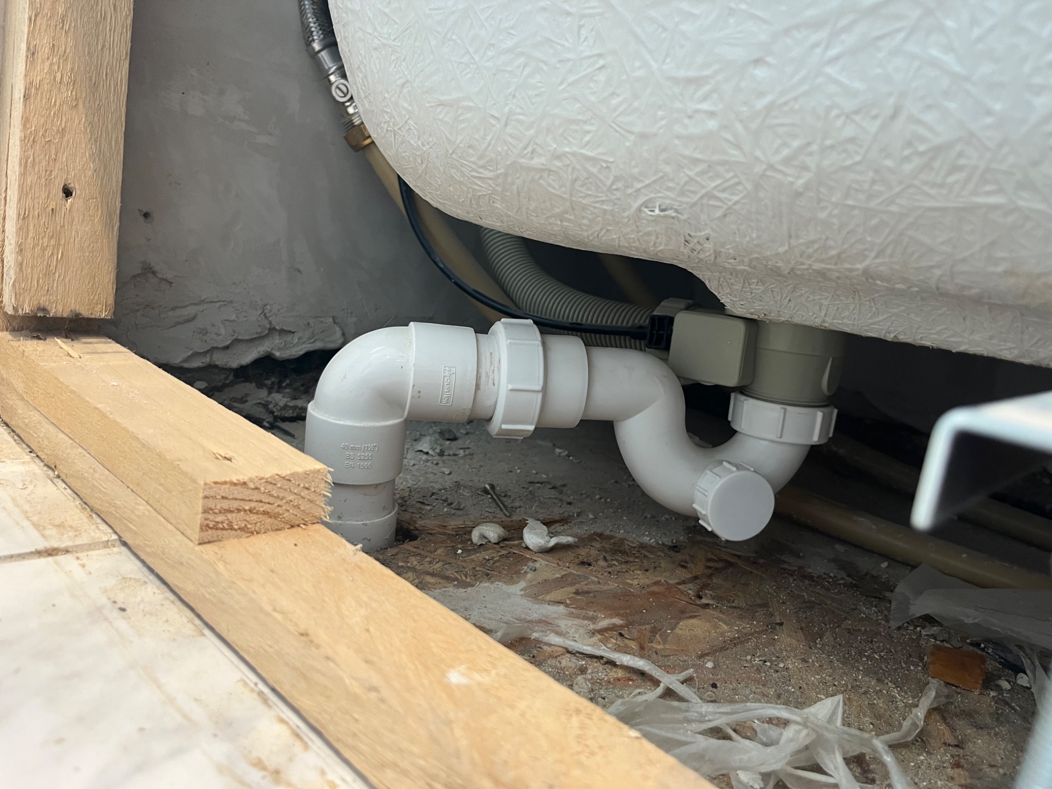

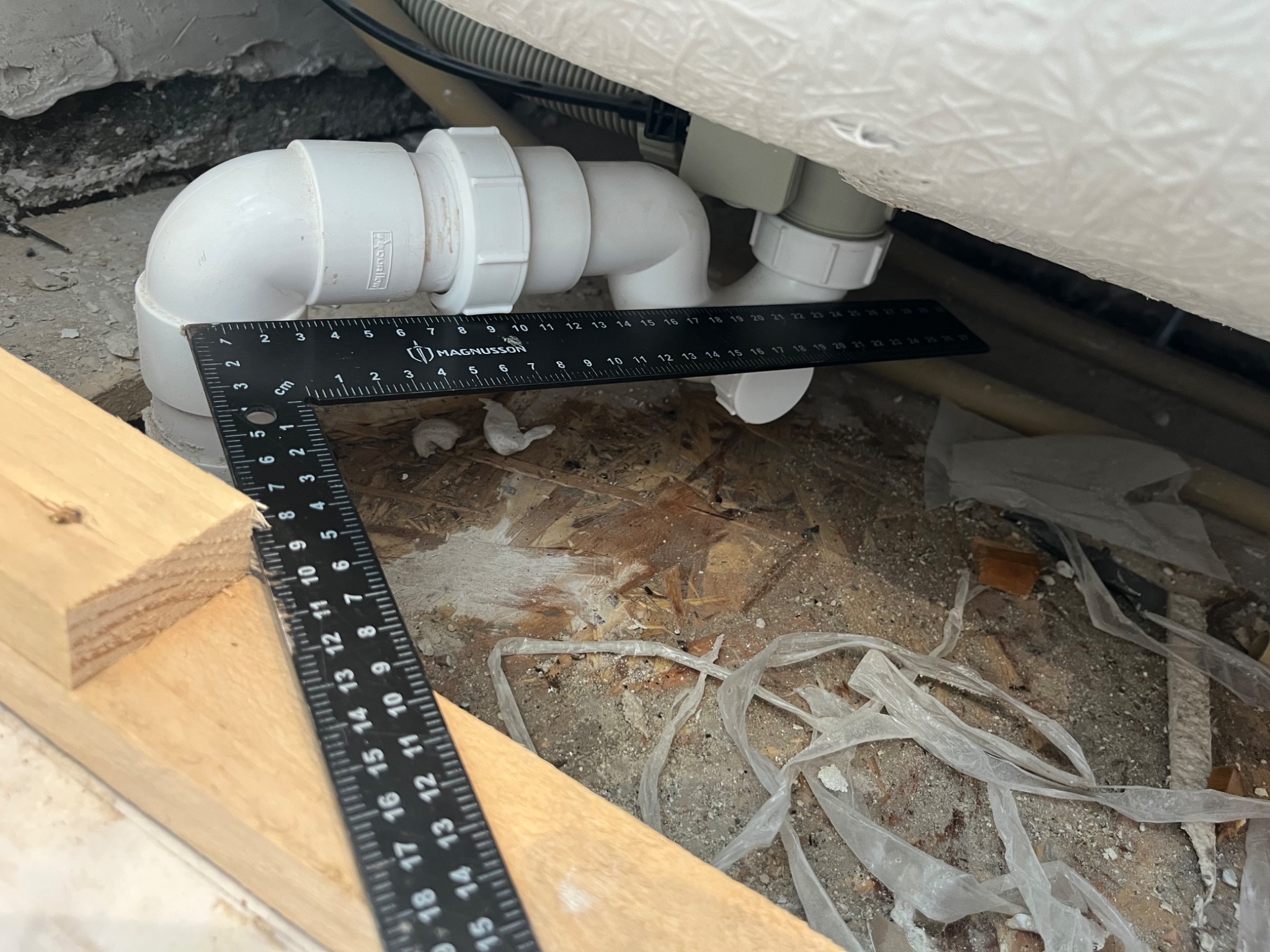

..... if it is a shallow bath trap then it would have been fine as long as the hopper was there, if the hopper is now gone then it really should go to a 50mm seal.
