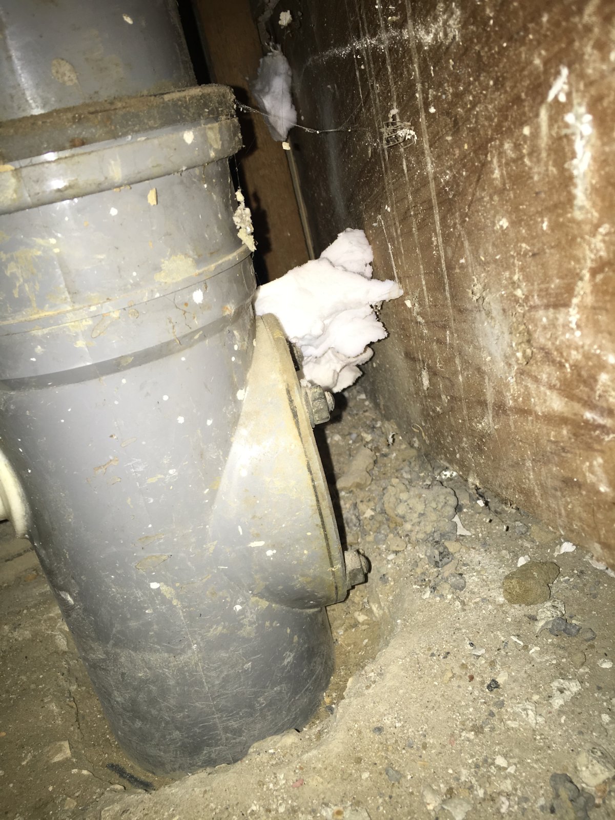

Hi,
I am looking for a bit of advice before I call a pro in.

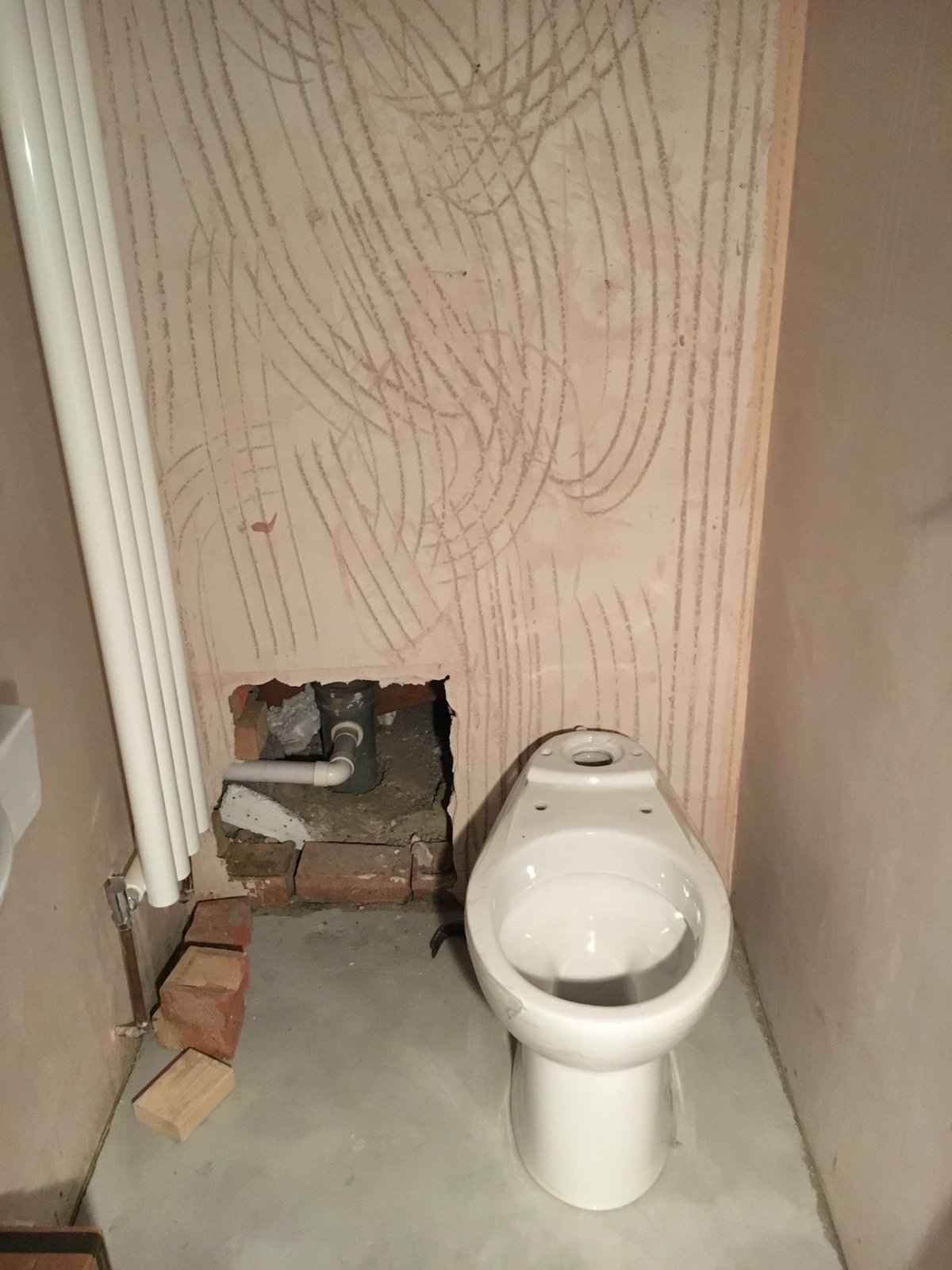

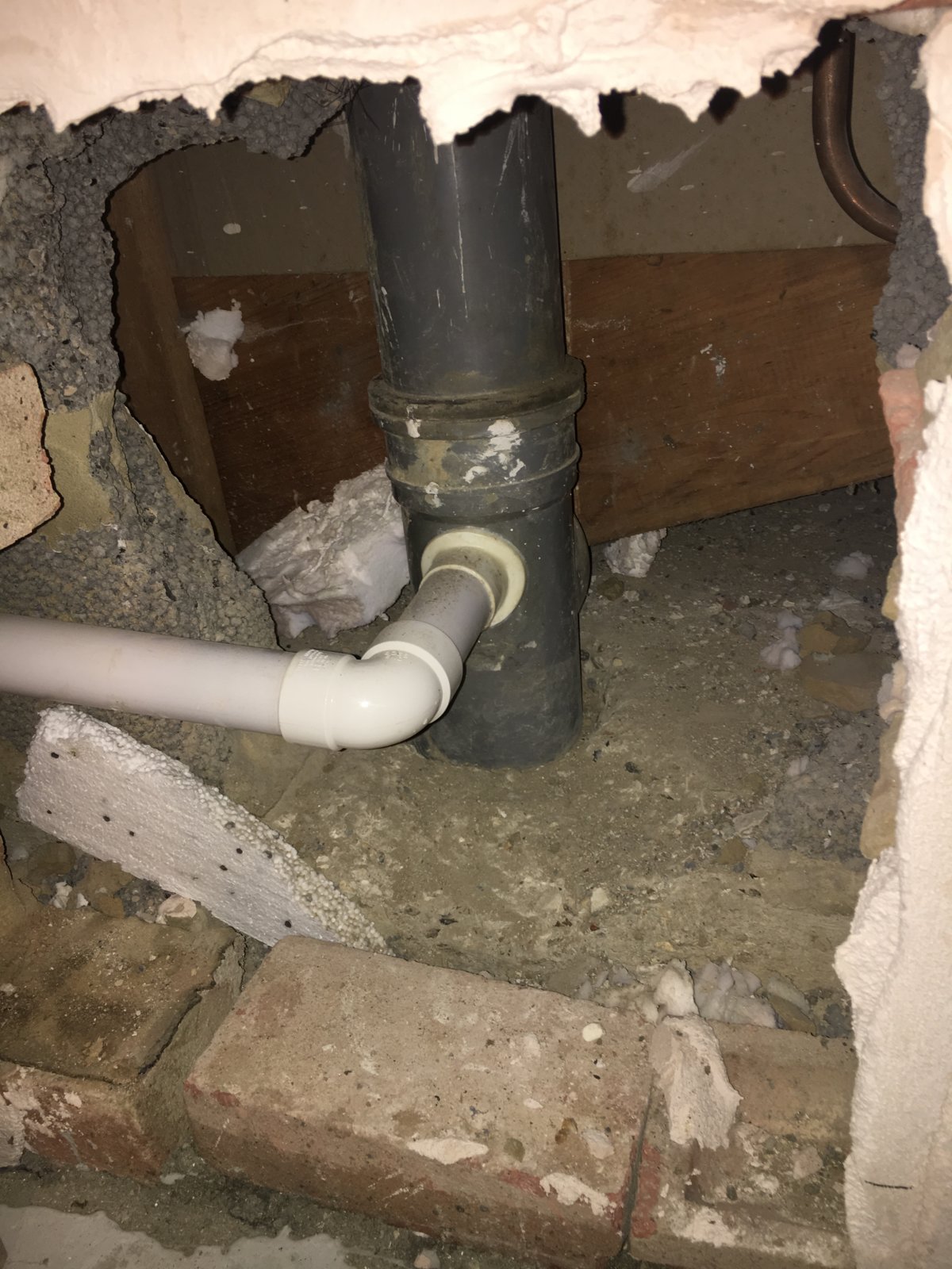

I need to insert a tee branch into our existing soil stack, for a downstairs loo.

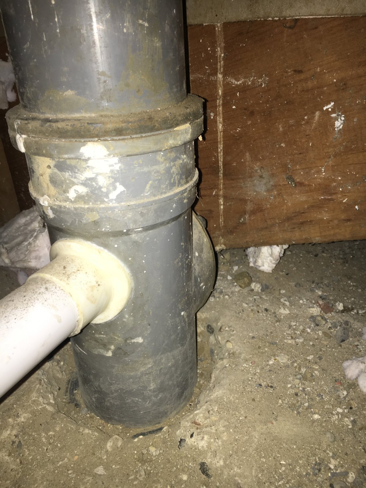

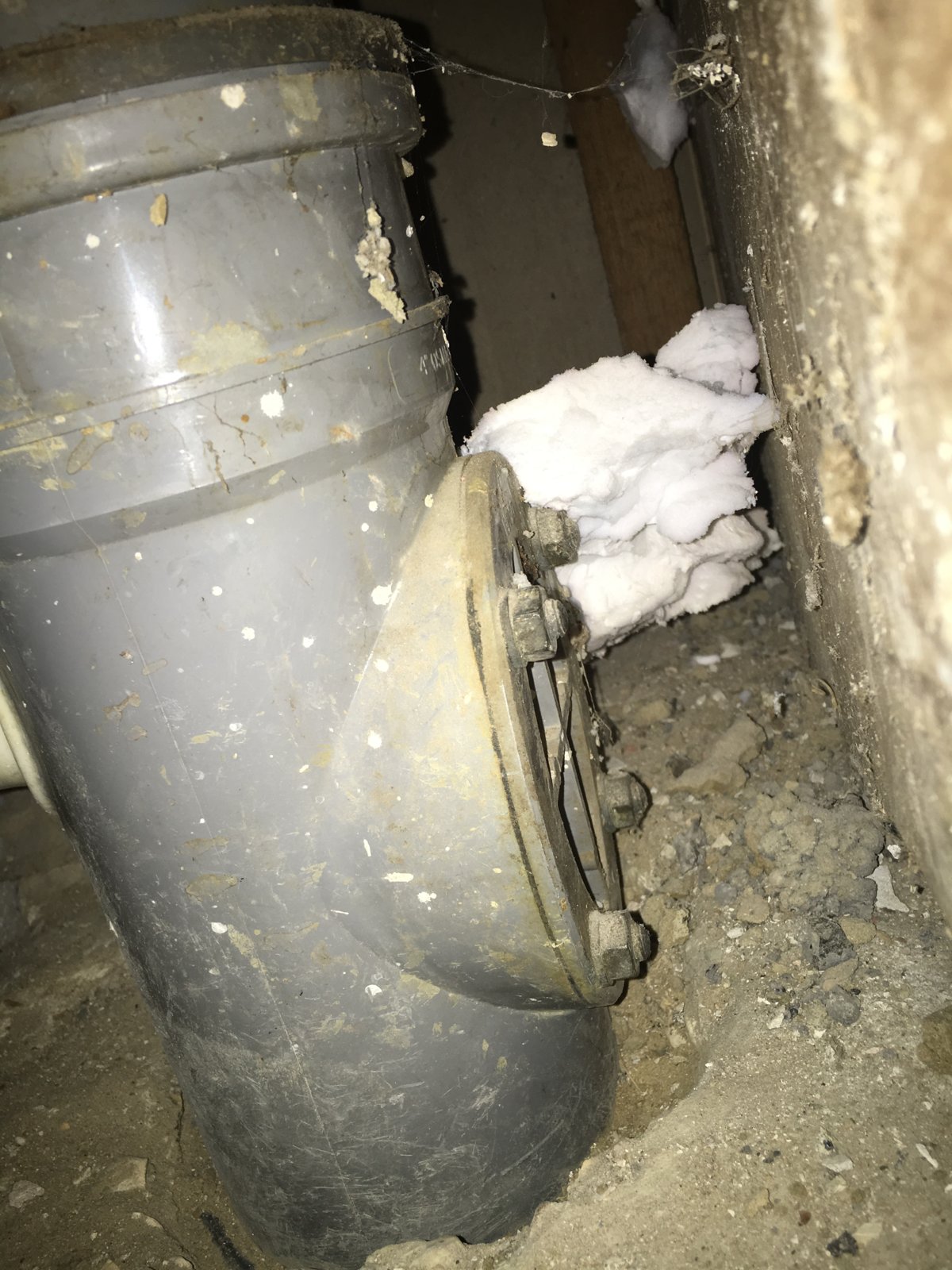

My problem is there doesn't appear to be enough clearance above ground level for a coupler to slip on top of the pipe that protrudes from the concrete.
There is an access hole on the rear of the pipe, meaning I will have to cut it below this, leaving around an inch of pipe left sticking out of the ground.
Would this amount of pipe be adequate for something like this to slip over and be secure?
https://www.toolstation.com/shop/Ro.../Soil+&+Vent/sd2849/Flexible+Equal+Tee/p50188
Or is there some other way to do this I haven't thought of?
Work out the fitting you need for the branch etc, and then cut the pipe so that you can solvent glue this fitting in. Then you can drop the new branch ito it, and then rejig the white waste pipe to reroute into a boss in the branch.
After that, if there isn't enough spare pipe left in the vent section, you can fit a small piece above the branch, and then join them with a slip coupling
Thanks for the reply.
Would the attached fitting slide inside a standard 110mm pipe, i.e. act as the male end?
I can see there is a female join right at the concrete level, but I'm concerned this will not come apart cleanly so I'll need to have a backup in place before I break the pipe.
Cut the white sink waste, and then see how many joints come apart. I can see the joint you've mentioned, and if you're lucky, that one'll come apart, and you then rebuild from there. If it doesn't, then you've got to cut it below the rear access plate, glue a new push fit socket connector, and then start rebuilding the stack.

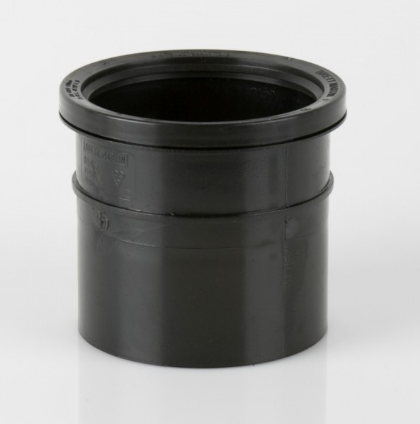

Thanks again. At least then I have a backup plan if they don't come apart. Would this be used to slide in to the existing pipe if I need to cut below the access plate?
That's it. You need to solvent weld that in, so make sure you get a tin of that as well, but you often have to ask for it, as it's a sniffers paradise. It doesn't need to go right down into the lower part of the stack, and if you set everything up before you glue it in place, then you can find the right height to set it in place.
That won't slide onto the pipe, that would fit over it. There are internal drain connectors that will go into the pipe, ones an S464 but there are a few others too.
I think best to get rid of the white pipe and see if the fitting will rotate in the joint below the floor. If it does it will pull out and be a nice easy job.
