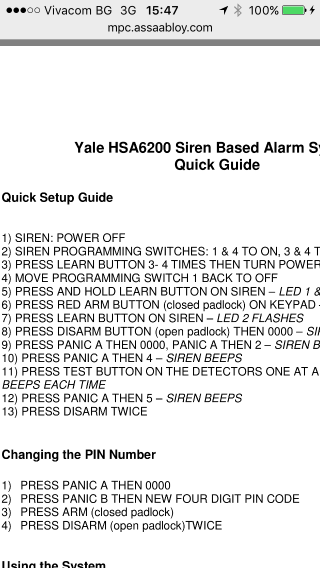

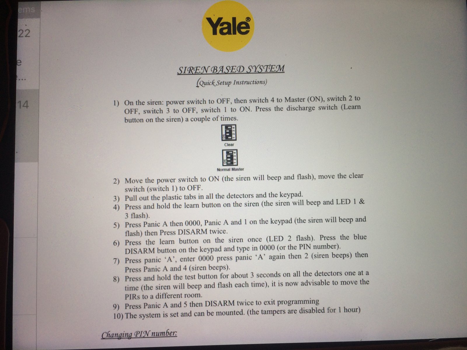

JohnD - thanks for the reply - please see the differing set up learning in modes. IMG_0934.JPGIMG_0931.PNGIMG_0931.PNG
