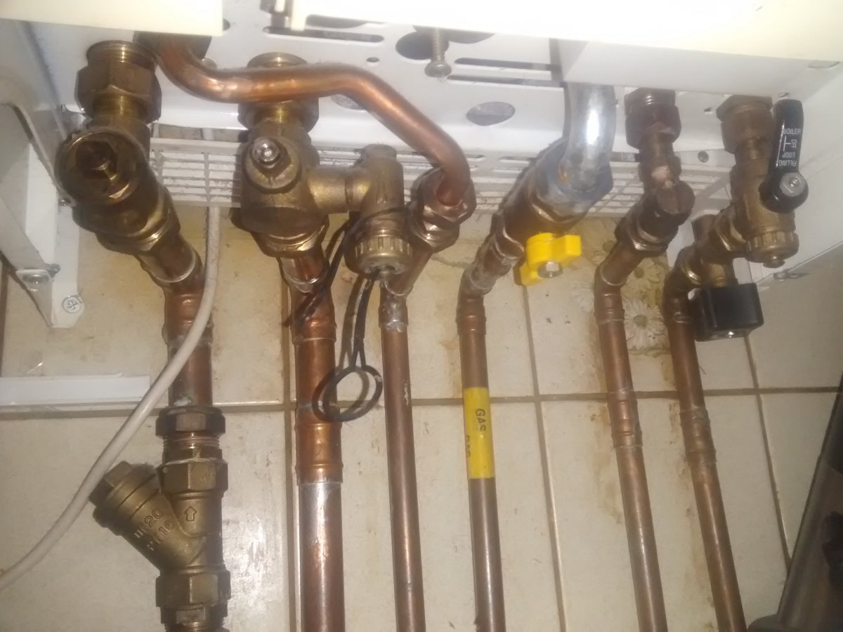

Hi all
I wanted to add inhibitor to the system and got some Fernox F1 express so I could add it through the filling loop, the guy in the Fernox website made it look so easy. However his boiler was slightly different to mine and now I am unsure which side of the filling loop I should add the inhibitor to. My boiler is a Potterton Linea 24 and one side of the filling loop has the water tap and the other has no tap.
Any help as to which side I put the inhibitor in would be much appreciated.
Jono
The inhibitor MUST go into the boiler primary circuit (normally into the return pipe), not into the cold water feed. Normally the boiler primary pipes (the flow to and return from the radiator circuit) are 22mm or 28mm in diameter, while the cold feed is in 15mm pipe. There should be a an isolation valve (and a check valve) at the cold water feed end and another isolation valve just before the flexible pipe connects to the boiler return.
Try and post a picture if you want a more definitive answer.
Hi Oldbuffer
Pic attached
Left pipe is an incorrectly installed y strainer.
Boiker looks Vokera, so pipe layout isn't the normal config
If I were you, I'd buy the cans and add through a radiator or towel rail.
Drain it down, cut the strainer into the return pipe (in the same orientation), then pour the inhibitor directly into the pipe before you fill up.
