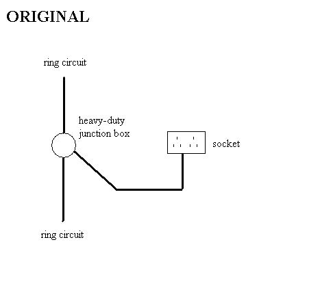

I would like to modify a socket ring main in my flat in order to add some sockets. The planned modification would be as shown in the pictures below:
In short I would like to convert an existing spur to be part of the main ring circuit, add a second socket to the ring main, and take a spur off one of these sockets. More details on the planned change are shown at the bottom, in case anyone notices any problems!

OTHER INSTALL DETAILS
All of the wiring for the installation will be run under floorboards (this is how the existing installation is).
The junction box I plan to use to make the additional connection would be this type (30A 3-Terminal Heavy Duty Junction Box) or very similar:
http://www.screwfix.com/p/30a-3-terminal-heavy-duty-junction-box/73522
I currently plan to have the sockets fixed in the skirting (in order to match the existing installation), the skirting is very tall though, the sockets will be around 100mm from the floor. I am aware that current regs for new builds are 450mm for disability regs, but am under the impression this is not required under the circumstances here? Feel free to correct me on this.
All wire used would be 2.5mm twin and earth.
Area covered by new circuit (much) less than 100m sq
No wiring behind skirting, would come up from floor straight into sockets

Get rid of the junction boxes, they need to be accessible and I bet they won't be.
Crimps are allowed, although a clean unbroken cable is always the best option.
Sockets in skirts suck, look in my picture gallery for the better alternative.
