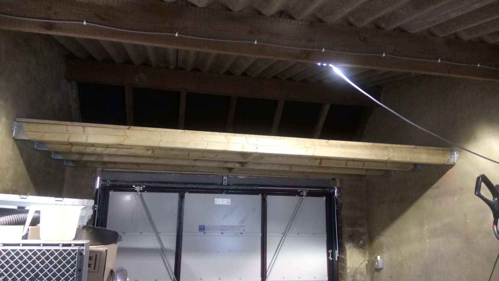

Looking for a bit of advice regarding adding some storage to my garage (separate from the house)
It has a Saltbox style roof which gives a lot of 'wasted' space above the garage door (taller end) which I would like to use for storage of some general tat (camping gear, a few garden tools etc etc)
As it is brick walls both sides my idea was to use some face hangers either side attached to the brickwork with some timber across the span. Width is usual garage size so somewhere around 3m

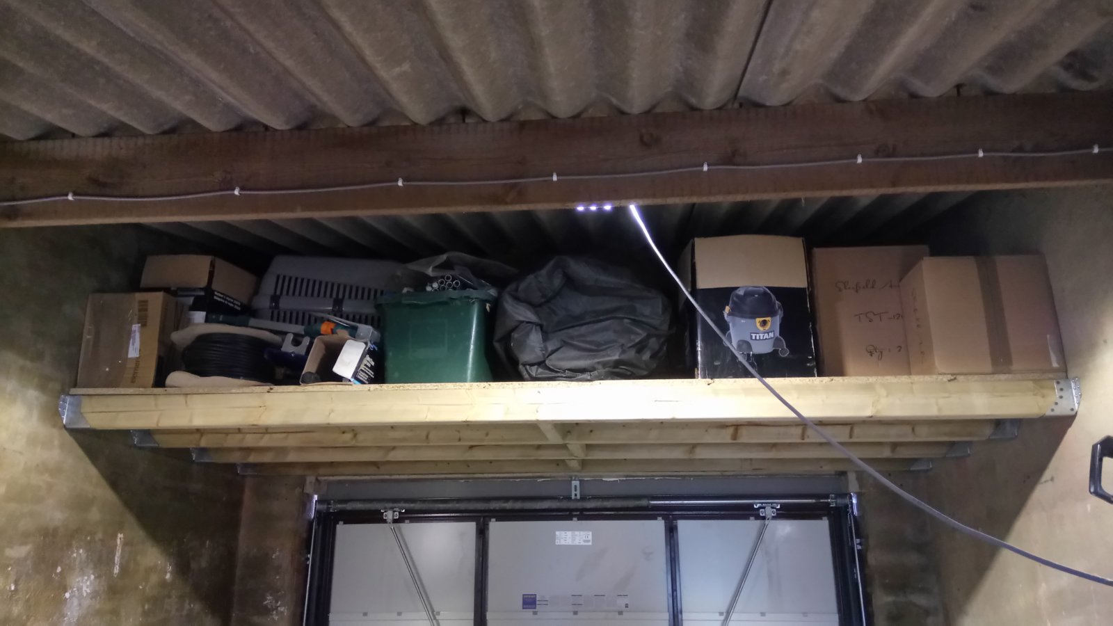

fair point noted, im probably only gonna store some old camping gear up there

I think 2x4 should be fine, planning on putting some loft boards over them which should help spread the load.

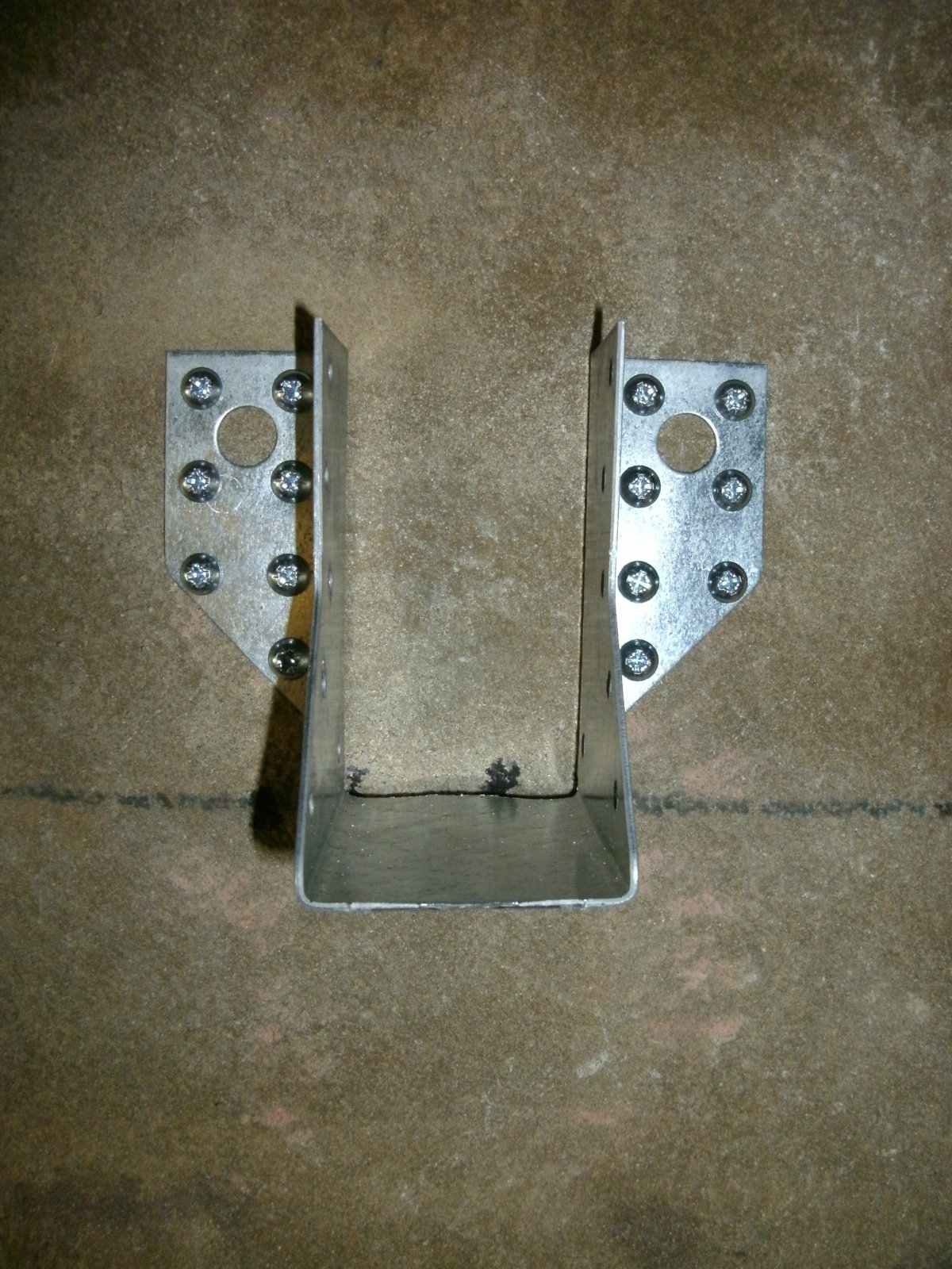

Was planning on using face hangers and screwing them to the wall with a half dozen screws each, or maybe anchor bolts would be more suitable
Have you used hangers for timber and screwed every hole into the wall?
Looks good... probably would have been easier, and a little cheaper, to have used a 4x2 each side instead of hangers, with a few concrete bolts!
