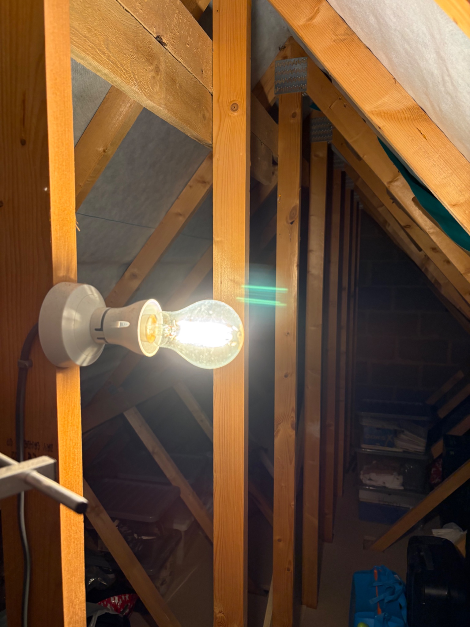

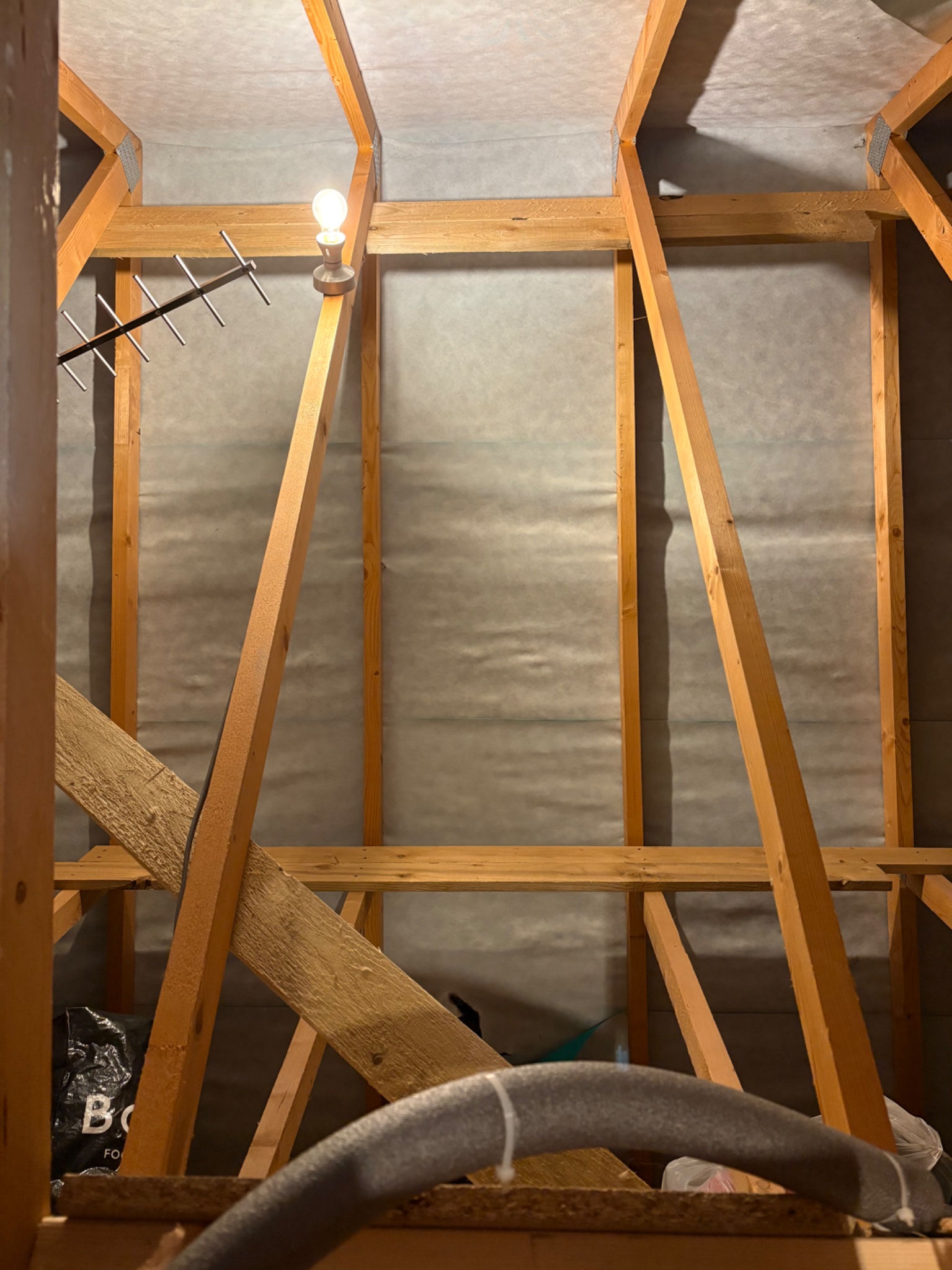

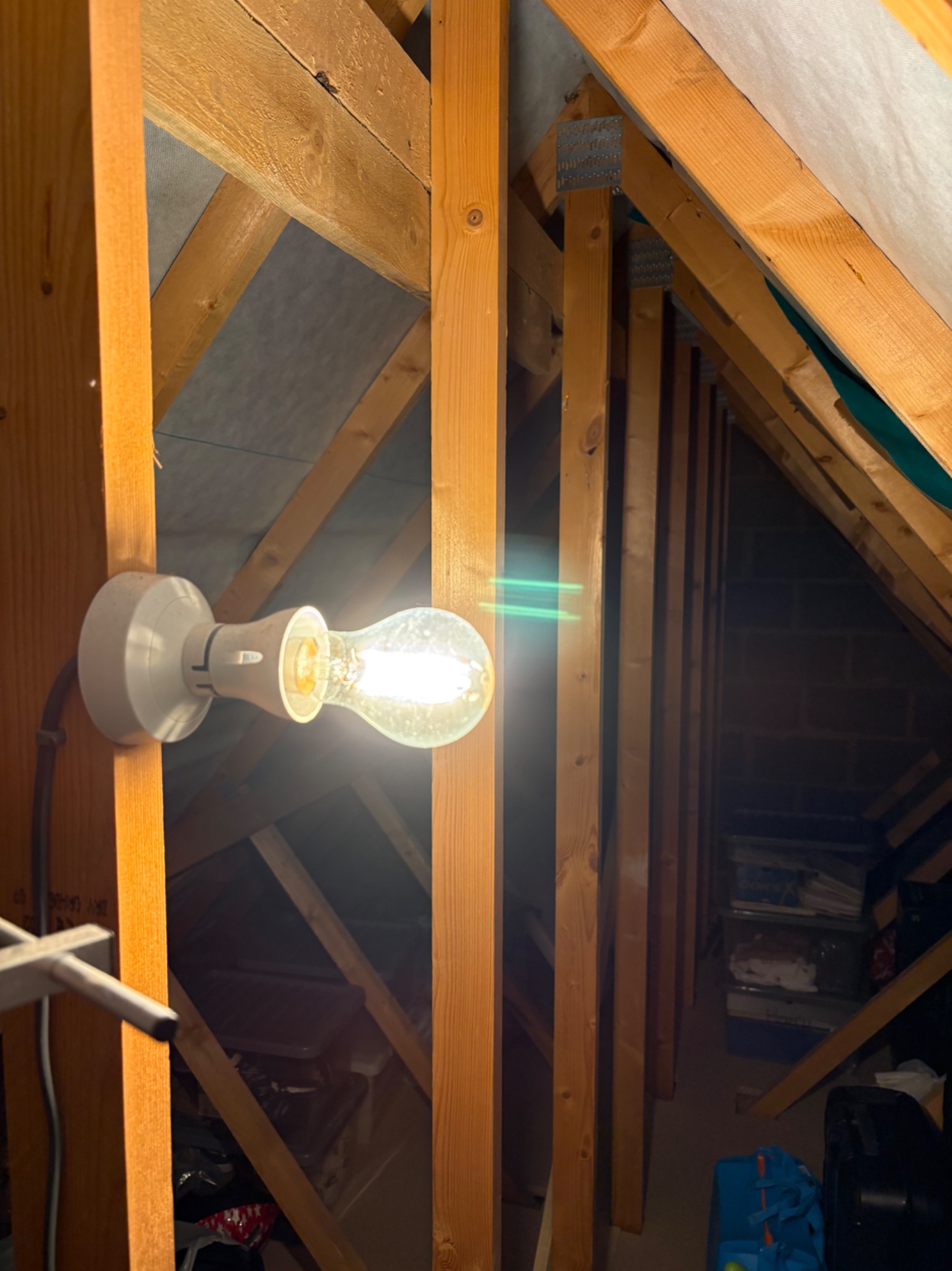

I live in a new build with one light fitting in the centre of the loft (as shown in photo) controlled by a switch on the landing. I’d like to add two additional lights at either end of the loft. Ideally I’d like to also move the existing light fitting a few feet or so as it’s in an inconvenient location and gets knocked every time we get into the loft.
There’s no slack in the cable to the existing light.
In my head I was thinking stick a 4 way junction box where the existing light fitting is, get myself some twin and earth cable and a couple of light fittings and then run that to each of the 3 lights. Would that be the best way of achieving what I want to do?
My knowledge of electrics is basic but I enjoy having a go.

yes , thats what i would do - if you wanted to switch some of the additional lights you could add a switch - or do you just want all 3 on every time
why 4 way ? whats in the light at the moment - maybe just the 2 wires neutral and switched live - with all th econnections in the switch downstairs which is common i believe now on new builds

I’ve never wired a junction box with this many connections, I’ll pick one up and have a look what’s inside…. but in my head I was thinking I need a 4 way (4 ‘ports’ for the cables in/out) as I’ve got 1 cable feeding in and 3 then feeding out to the lights, and would mean I would be connecting 4 cables inside the junction box:
1: The ‘feed in’ cable coming in from the switch (the one that currently goes to the existing light)
Cables 2 3 and 4: Going out to the three individual light fittings.
I presume the live, neutral and earths will either connect to separate brass screw connectors inside the box if there’s enough, or I’ll have to twist some of them together to make the connections.
It seems straight forward in my head, but just when I think I understand wiring and electrics I am persuaded otherwise

its the conductors in each T&E - not the cables them selves From the switch - should just have L,N,E (but need to check that is the case , dont why not but who knows how they have chosed to wire it) - looking at th epicture , that should just be a T&E - Switched Live, neutral and earth
From the switch in the hall - 1 x T&E L,N,E (E will be sleeved green & yellow ) - then you want 3 T&E out - but they will all connect to L,N,E - and the Earth will need sleeving - so dont forget to buy that and then clipped - do you have T&E - or buying it - if buying with LED bulbs, then 1mm will do

Thanks, ideally I would have just daisy chained from the existing light fitting and done without the junction box, but because the light fitting isn't in a great location I want to move it.
The lack of slack in the exisiting cable means I can’t move the light without extending its wire, hence why I thought junction box and then twin and earth of varying lengths to the new location and the new light fittings.
And yes i need to buy the cable, junction box etc. I’ve got some sleeving for the earth already
yes , exactly that - junction box replacing the existing lamp holder - then it depends how you plan to wire things - if 3 lights - you could go up to 1 holder and then from that take one to each of the other lights - or if all in 1 direction 1 to next bulb holder and then onto next bulb holder - still only 3 connections L,N,E IN and OUT
OR - i into the JB and then 3 out to each lampholder
If I've understood you correctly, you'll probably have 2 cables coming out of the JB, one goes to the repositioned (roughly) central light which then daisy chains to an extra one and the second cable goes in the opposite direction to the final fitting.
