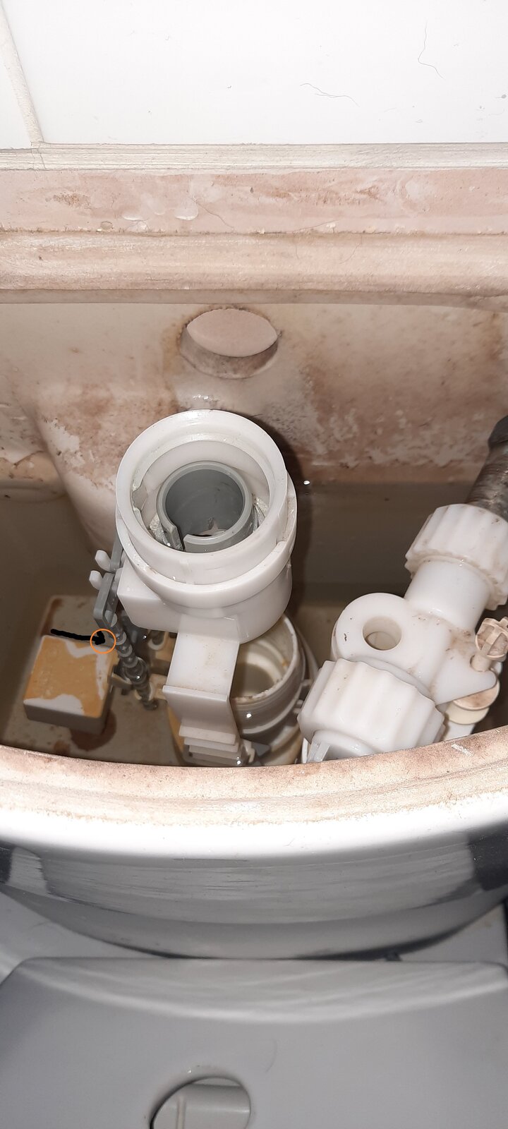

Had to change the O ring on the water inlet.

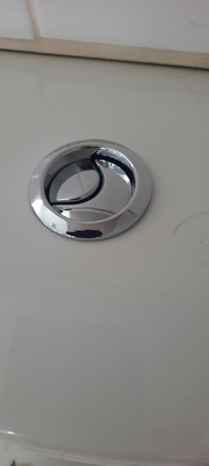

Now I have replaced the lid, you can see the flush buttons are correct, I can flush using big button.
So have i moved something on the flush on the left hand side?
Im going away Saturday so I dont want to fiddle & leave a not flush toilet.
TIA

Thanks, not what I have. I've spent a lot of time searching, just can't find mine, it's about 15 years old
SORTED
This may help others.
I used Google AI, I searched my posted photo, it returned SIAMP SKIPPER 45.
I then searched for installation instructions, brilliant, you just unscrew the grey centre piece as far as it will go.
