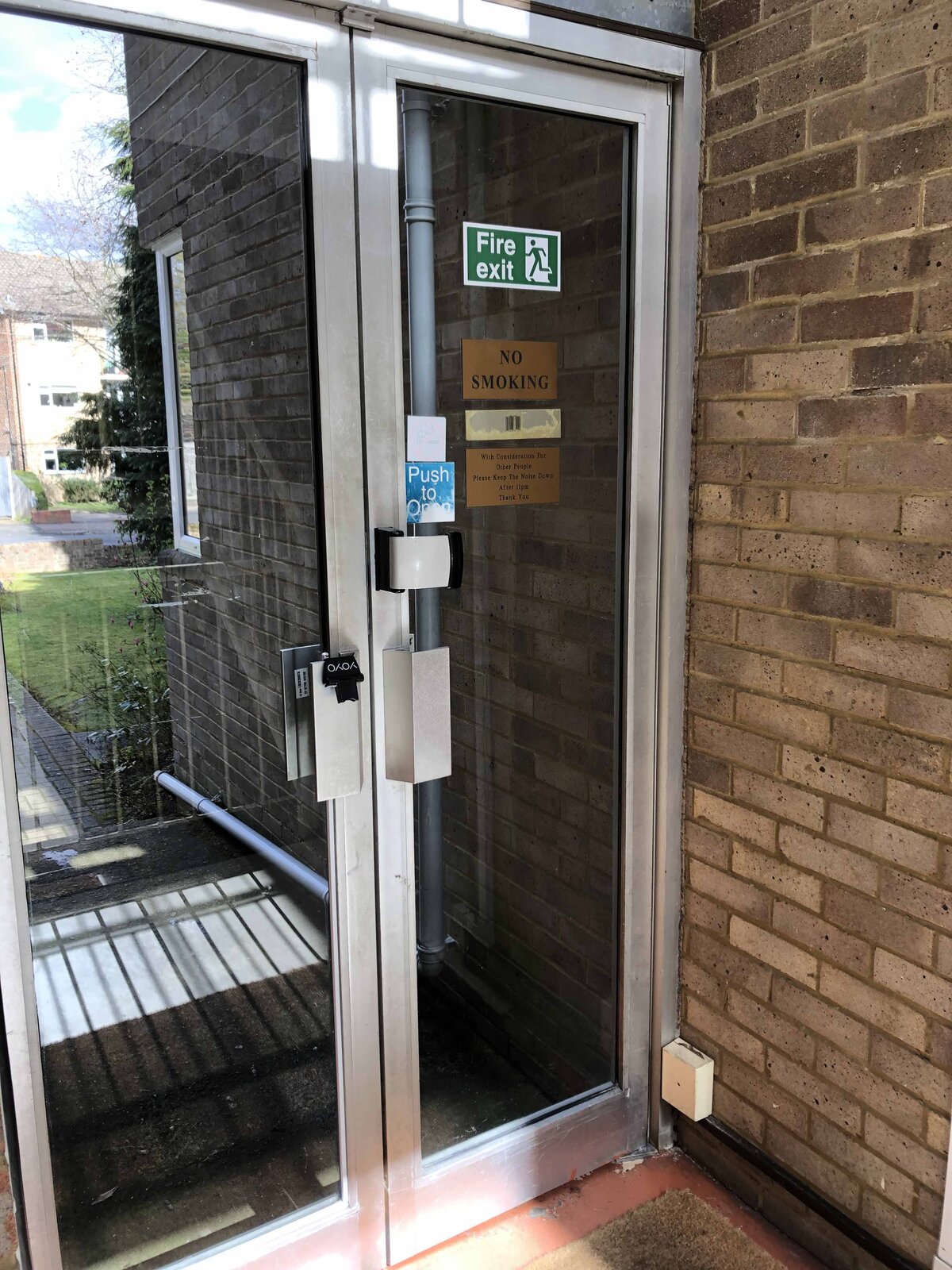

Hello, our building front door is getting too heavy for a couple of our elderly residents.
Can it be made lighter by adjusting the internal mechanism? The is no overhead external arm
And is this relatively simple or do we need to call someone in? I contacted a Locksmth but he wasn't interested
thanks!

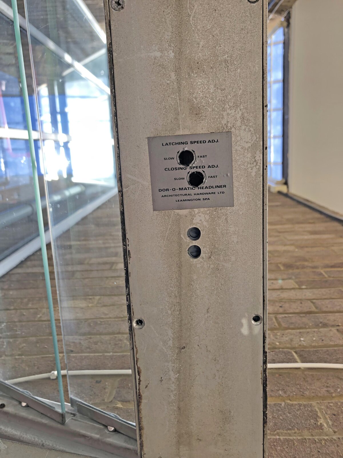

The window experts @crank39 @ronniecabers may be a long to answer you DIY query but Thursdays are always slow on the forum, the closing speed is how long it takes for the door to close from 90deg to about 15deg, the latching speed is how long it takes to close the last 15deg, this needs to be crucial to actually enable the door to fully close. Don't know what the other two screws are, I wouldn't have a go unless you're confident, these things have a habit of getting worse in unskilled hands.

Can't say that's one I've come across before , everything Freddiemrcurystwin has said I agree with about what the top two are. One thing I will say it's usually the slowly they close, the harder they are too push open but obviously you don't want it slamming closed on an elderly resident who can't move that fast
