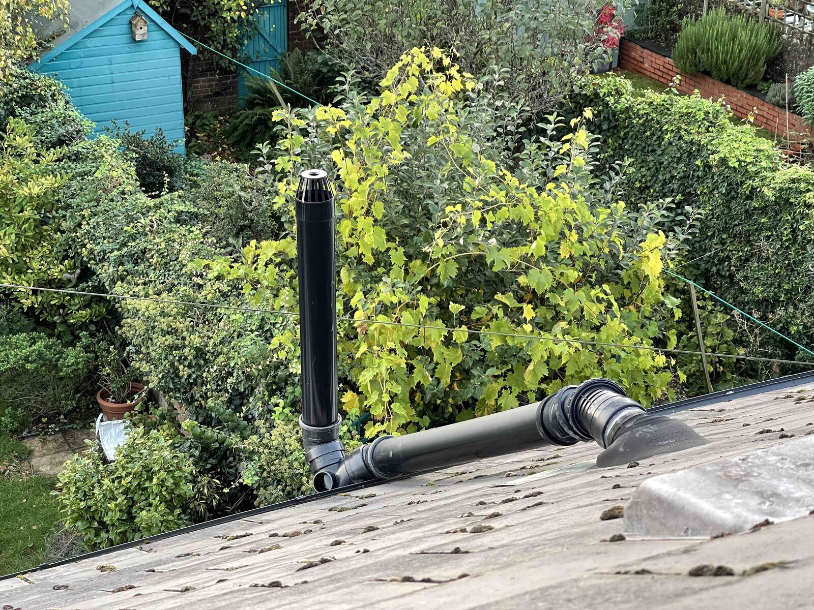

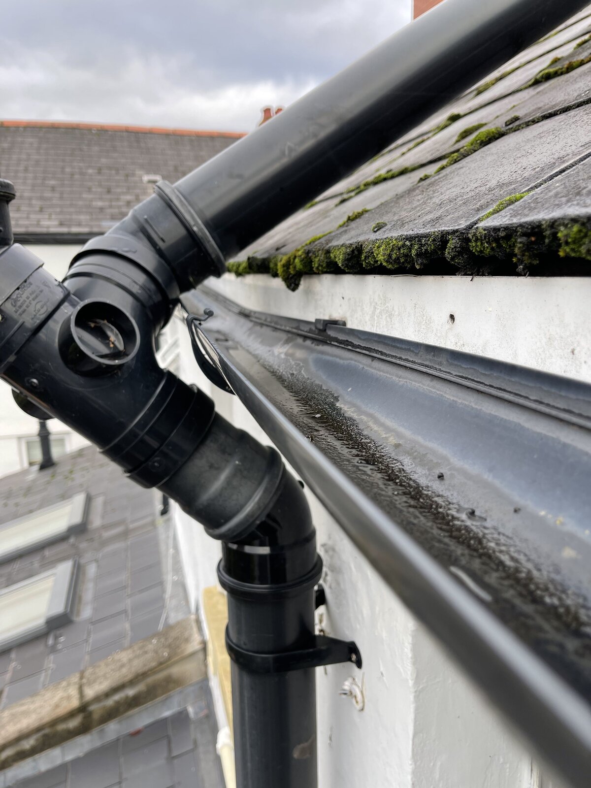

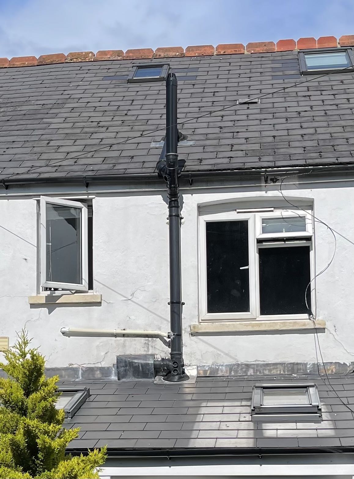

Hi all,
The soil pipe coming down from the bathroom in the loft is fowling on the guttering, causing the guttering to sag (see photos). I've rung round, but no-one locally appears to be available to take on the job at the moment. Is this something I can adjust myself?
Thanks in advance
If you're brave enough, then yes. i'd look at making the offset out of glued bends so that section cant move, (should be standard practice anyway), then fit the junction just above that, make the WC connection and stick a piece in the top for the vent.
