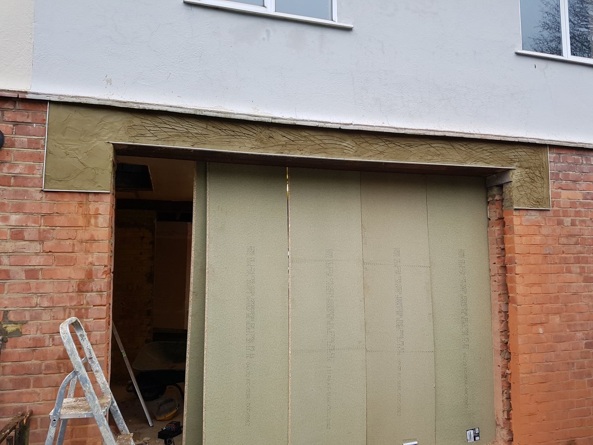

Would appreciate if people can advise me. Ive already applied the scratch coat of render with waterproofing additive mixed in.
I just wanted to know what the best method is of appying final coat.
Do i need to use fibre mesh to stop cracking?
Is a mix of 4:1 fine?
I just want to do it properly. Thanks

Howeaver if you feel capable of doing the job then why not. id go for 4 to 1 maximum with some fibers but they will come to the surface when you get the finish with a sponge. too much cement will aid in drying time and cause it to crac. so measure your sand and cement to get the correct amount.
