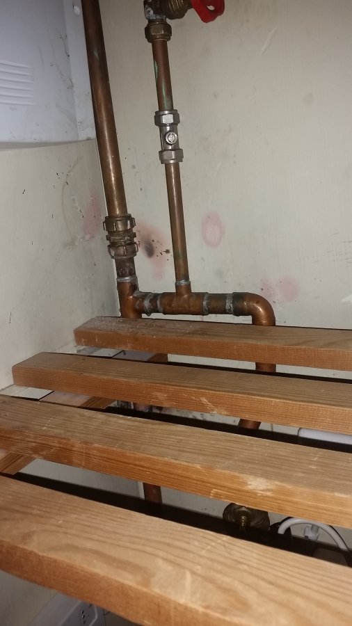

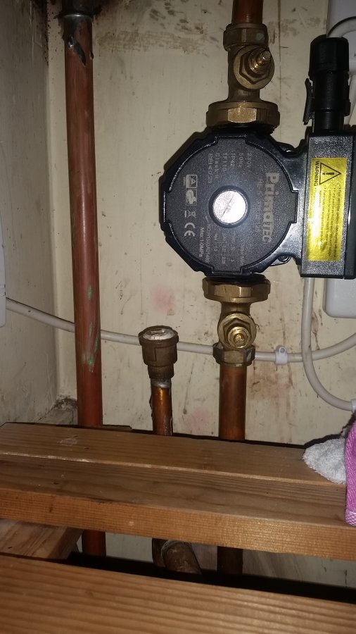

How about you post up some pictures of the pipework in the airing cupboard. Particularly where the vent and feed pipes are?
So Right hand pipe is cold water feed left is return/ vent.

So, your second pic that shows your feed,is that the one with an isolator and just can see a gate valve ?
If so double check that the gate is open and not closed.
If open and you still think you have a blockage then have a look at FAQ, C and boiler question 12. This shows how you could back flush the feed pipe.
Looks to me like it's happened before.
I'd turn off the ballofix drain off a little water then disconnect the pipe under the ballofix. get a bucket then crack the valve to prove that legs not blocked.
Is there a compression fitting on the flow pipe under the shelf? If so you could remove that whole section for cleaning. If not I would probably get a 22mm pushfit coupling and cut the flow under the shelf, undo the other compression fittings and remove the whole section that way - well I'd sweat a coupling in but same thing!
With a 'close coupled' Expansion & Feed, it's likely to be blocked. It's a bit of a *****'s Breakfast really, it would be best to remove the ISO valve & the Gatevalve completely.
