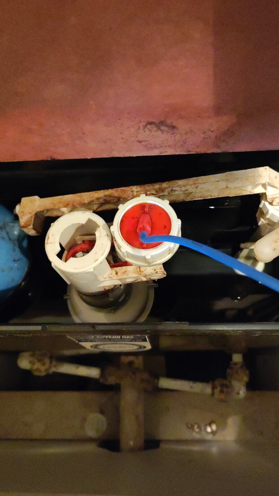

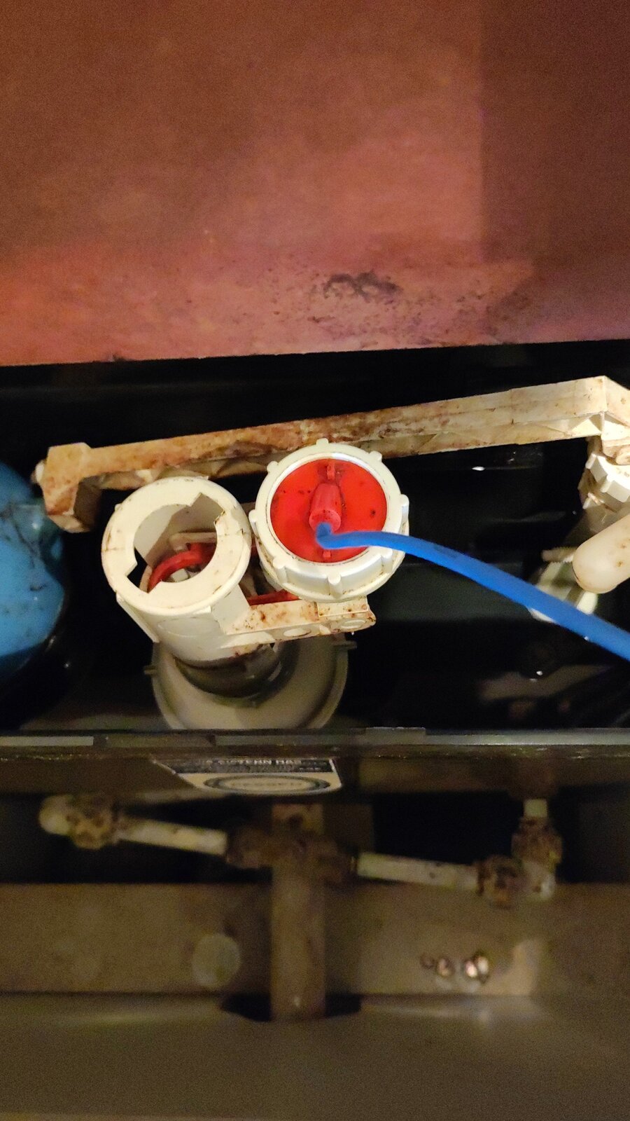

I have a pneumatic toilet. The flush started to get a bit temperamental, and I had to push it hard or multiple times to get it to flush. This went on for a couple weeks, and then it stopped flushing completely.
I have swapped a few easily removable parts from my other toilet where possible (I was thinking the plastic bellow was may be faulty, but have replaced that and no change).
It may be worth noting that although it doesn't flush when pushing the button, if I open up the cistern it flushes fine from in there. I also thought perhaps the air might not be getting to the valve, but when I push the button I can see/hear the air getting to it. It just doesn't seem to flush.

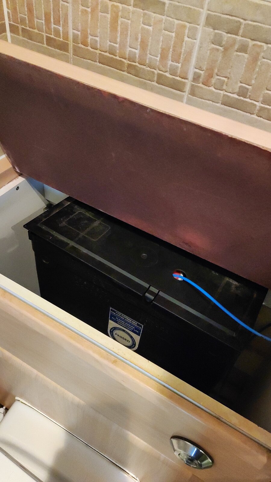

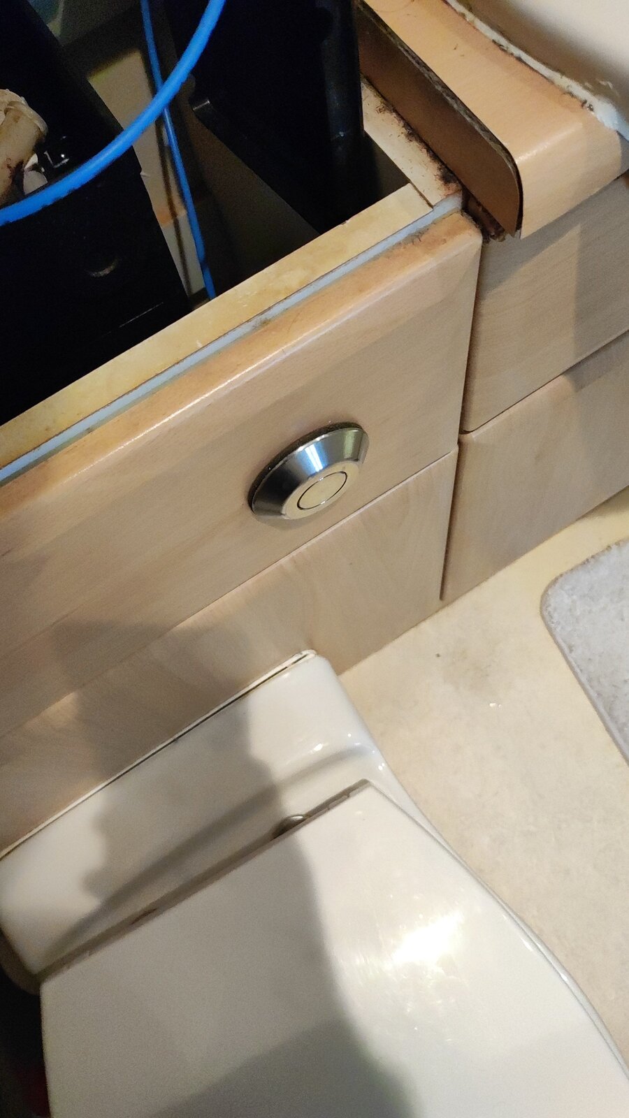

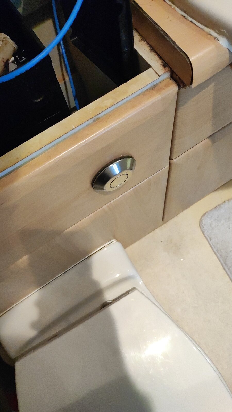

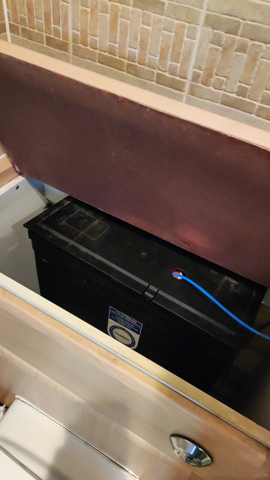

I have tried multiple plumbers to come out and try to fix it, but they all ask for a picture (see attached) and every single one has said they can't fix it/won't come out once I have sent the pictures.
I am just looking for advice. Is there anything I can do? Is the issue to do with the fact it is a concealed unit and might be difficult to get the wooden panels off?

Don't see the problem there - just needs the current drop valve swapped for a different one - one preferably not pneumatic, but loads that would suit.
The trouble will be getting to the old one, pas that cabinet - removing it and making it all watertight again and making good but shouldn't be beyond any competent plumber.
Its got to be the valve, the tube, or the push button (bellows).
Always worth checking the tube for splits/loose ends.
The valve in the link looks identical to me. If so it will twist off the cradle so would require no further dismantling to swap.
Those Ideal Standard pneumatic valves are garbage and very expensive. Replacing the valve will be simple and will solve the problem but its likely you will be replacing it again in a few years. I'd bite the bullet now and replace with something like a fluidmaster cable operated valve.
