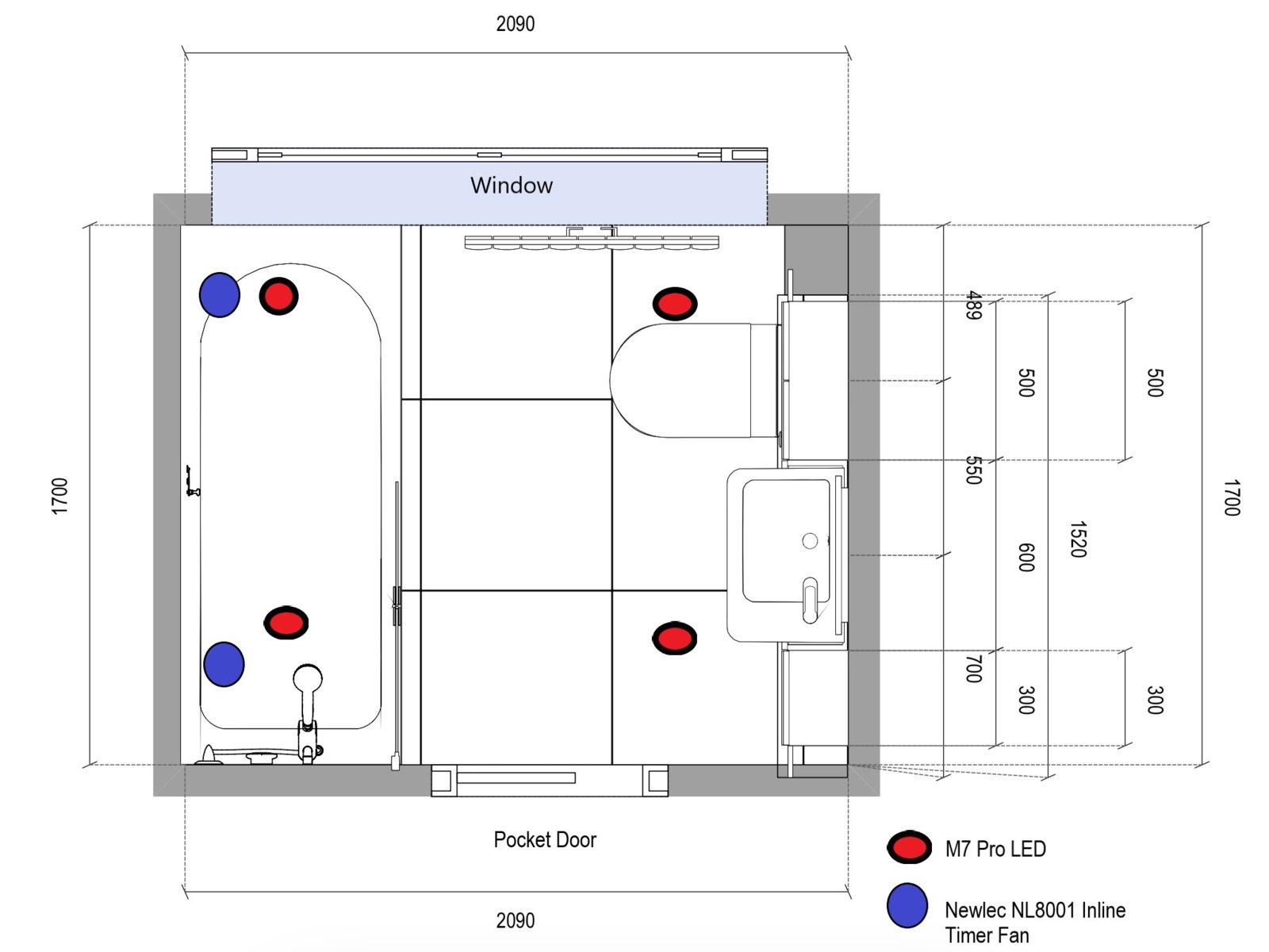

Hello Gentlemen sorry to ask yet another "where do I put it" question, Im just trying to confirm before I commit and cut the hole.
I have a Newlec NL8001 inline fan with timer which I am installing in the loft space which is easily accessible and already wired with isolator etc.
The bathroom is 2.1m x 1.7m and will have a Aqualisa Quartz shower on a riser over a Bette steel bath.
On the photo below I have marked the Aurora MPro7 LED lights in red and possible locations for the fan in blue.
Thank you for any help :?:
I guess your main aim for the fan is to reduce condensation? that room is quite compact.
Put the air extract centrally over the bath.
Also, make sure you have a way for enough air to enter the room. The fan won’t work properly if you have a tight fitting door. 100mm fan needs a 100mm hole into the room.
