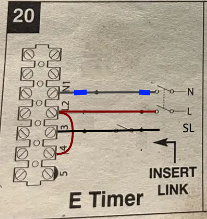

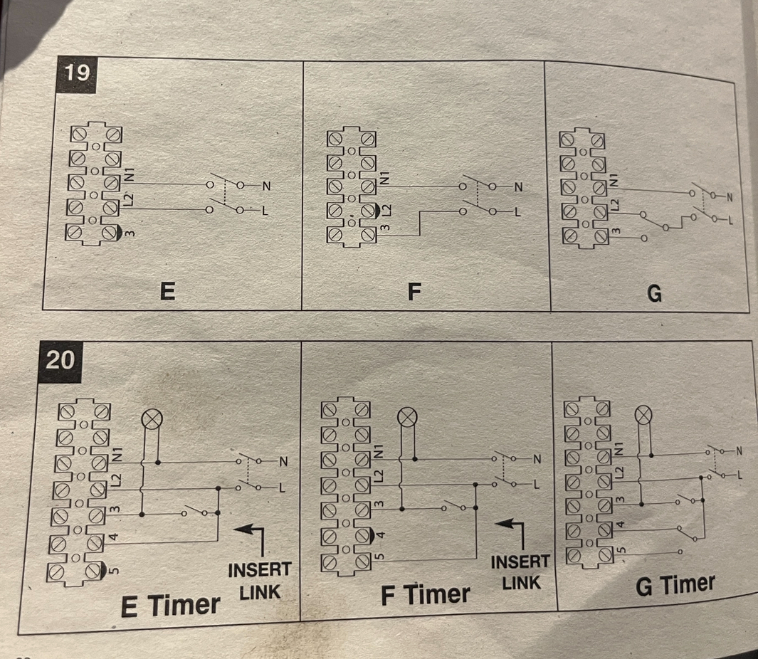

Installing an inline fan in the loft. I assumed it needs a permanent live and neutral plus a switched live which I have. Can someone please make sense of the instructions for me and tell me where the three wires go for max speed with timer.
