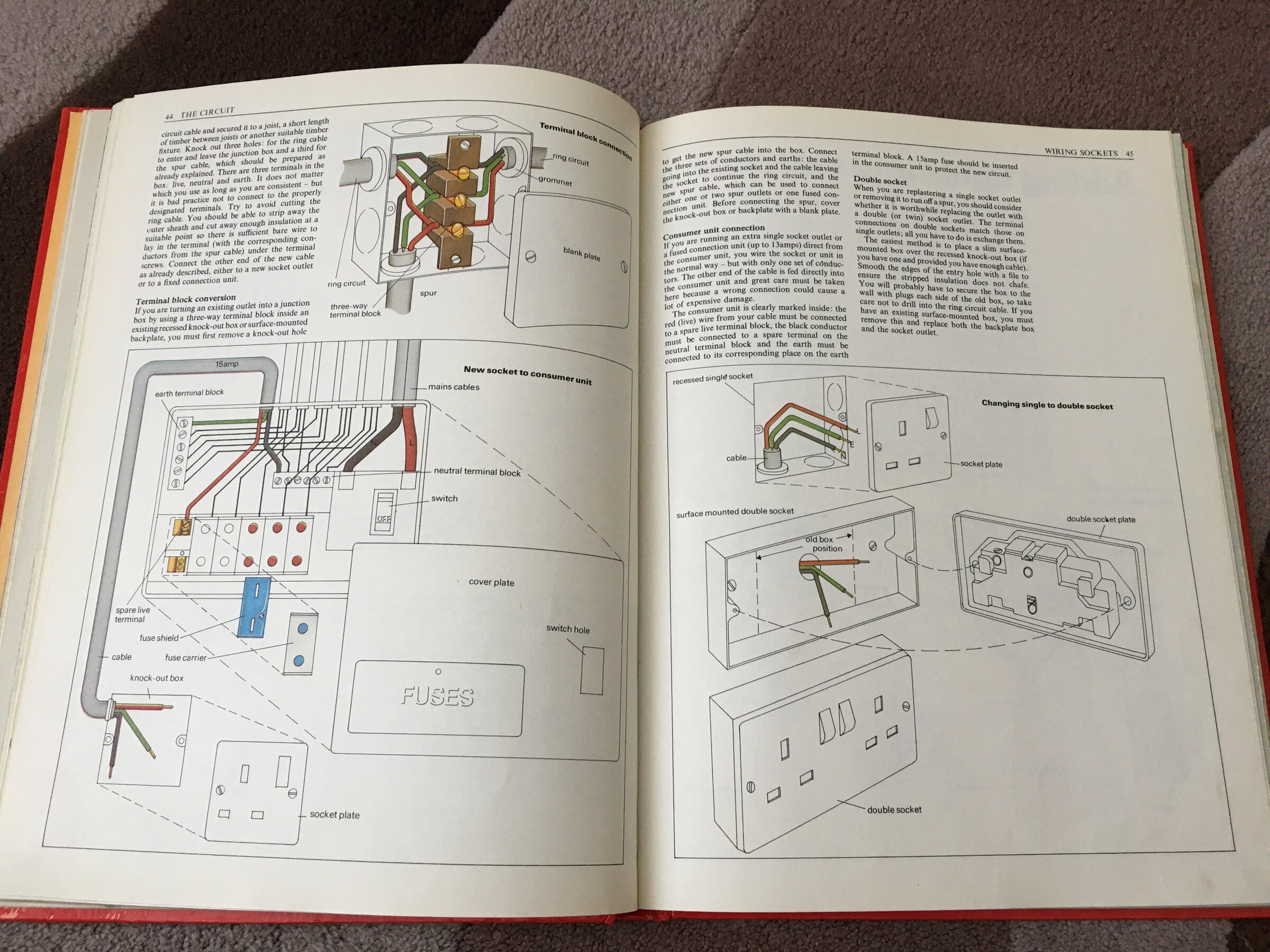

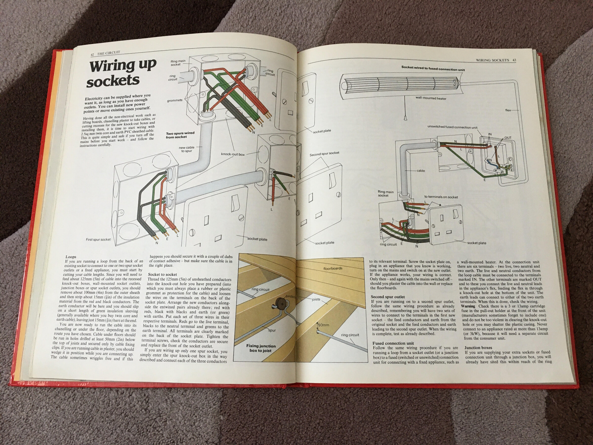

I have an old Home Electrics book of my Dad's that I used to read all the time when I was younger and fascinated by electrics. I distinctly recall it stating that you could take an unfused spur to 2 x single sockets or 1 x double socket, I've just dug it out and attached some pics. No regs are stated but thought some of you might find the history behind the varying 'can you spur from a spur' opinions interesting.

I probably should have stated For anyone reading this in the future that taking a spur from a spur is not allowed under the current regs and far as I know it never actually was. That old book is a Hone owners guide and no regs are quoted anywhere in it.

... and far as I know it never actually was.
Now that you have prodded my memory, I seem to recall that the regs did once allow what the books says - one double or two single sockets (which, as above, would probably be more sensible than 'current regs').
