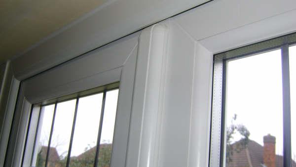

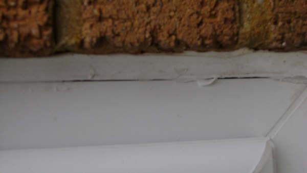

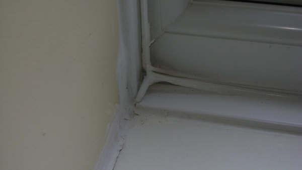

Had some double glazing fitted a year ago. Am going through the process of seeking compensation from the company if I can ever get hold of them, but would really appreciate a steer on a couple of points.
As you can see from the photo's, inside and out, the sealant has either dissapeared and created gaps between the window and brick / plaster or has lifted etc. I am confused as to why this is likely to have happended - wrong silicone, badly fitted - any ideas?

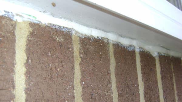

I also have the wind issue referred to by many. One of the photos shows a device they fitted to resolve it, which it didn't do - is this normal or were they fobbing me off |(the noise started before the silicone started peeling away). It now also makes some of the windows difficult to open thanks to the dvices.

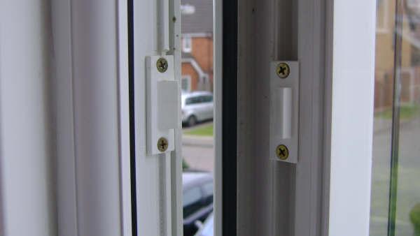

Thridly the french doors have a slight breeze coming through. He tells me its normal and they cannot be fitted any tighter - is this true?

pic 1 - silicone lifting indoors
pic 2 silicone peeling outside
pic 3 the french doors
pic 4 silicone peeling underneath the windows
pic 5 the devices to stop the wind

i kind of had these issues too when had my windows changed.
i fitted some P style rubber type tape around the window to seal it properly and i had the wind noise too,when it wasnt the missus parpin i found out it was actually the plaster around the windows had expanded and created a some what cavity,so i drilled a hole in the wall and put some expanding foam in there,stopped the wind noise that night.
this is what i used around the windows
http://www.screwfix.com/prods/33145...therstrip/EPDM-Rubber-P-Strip-6mm-x-20m-White
i would just re-silicone where it has come away,use some anti fungal stuff and should be fine

It all looks a bit rough but some pics. taken further back may give a better impression of the overall quality of the fitting job. The story he’s spinning you about the French doors is a total load of carp; I have 4 sets all 1.8m wide & have no draughts at all but mine are quality Rehau units. That extra catch is a total bodge & should not be necessary & you shold not have to fit additional P seals; everyone DOES NOT have these problems & you should not be having any of them!

Chances are they’ve also used the wrong silicone; don’t use anti-fungal bathroom stuff, you must use a good quality low modulus, neutral cure frame sealant.
