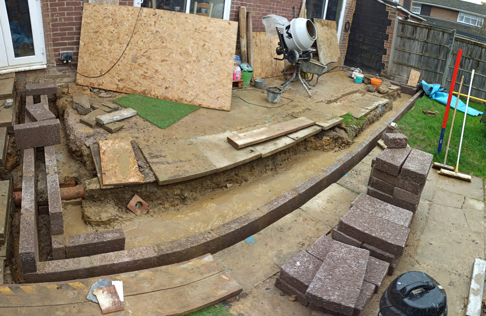

How does rendering work around those air bricks?
I have a large stanley square but still struggled as I couldn't get the square level to my lines. I have checked it now the first course is in and its pretty good
Managed to get some really nice mortar mixes today and laid about 30 (?) blocks, shame its work tomorrow! Pic is from this morning. Have now completed first courses all the way around...
