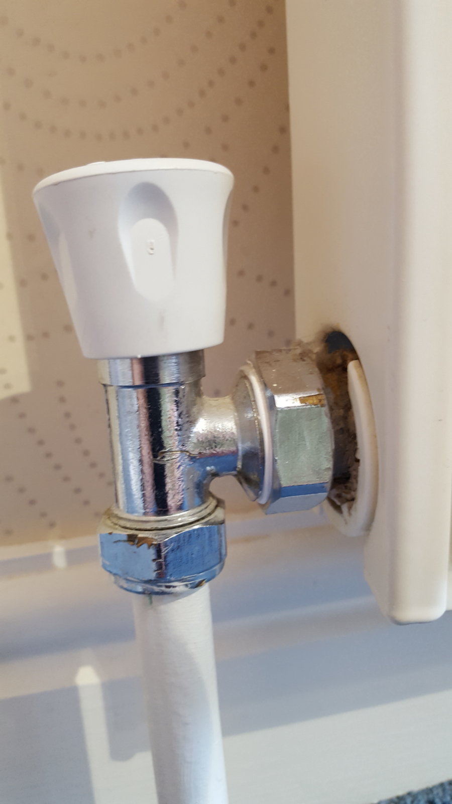

However, on checking the existing lockshield valves of the two loft radiators, they are unlike any in the rest of the house. The connection to the radiator is via a large nut, rather than the usual smaller 15mm compression fitting. Here's what it looks like:

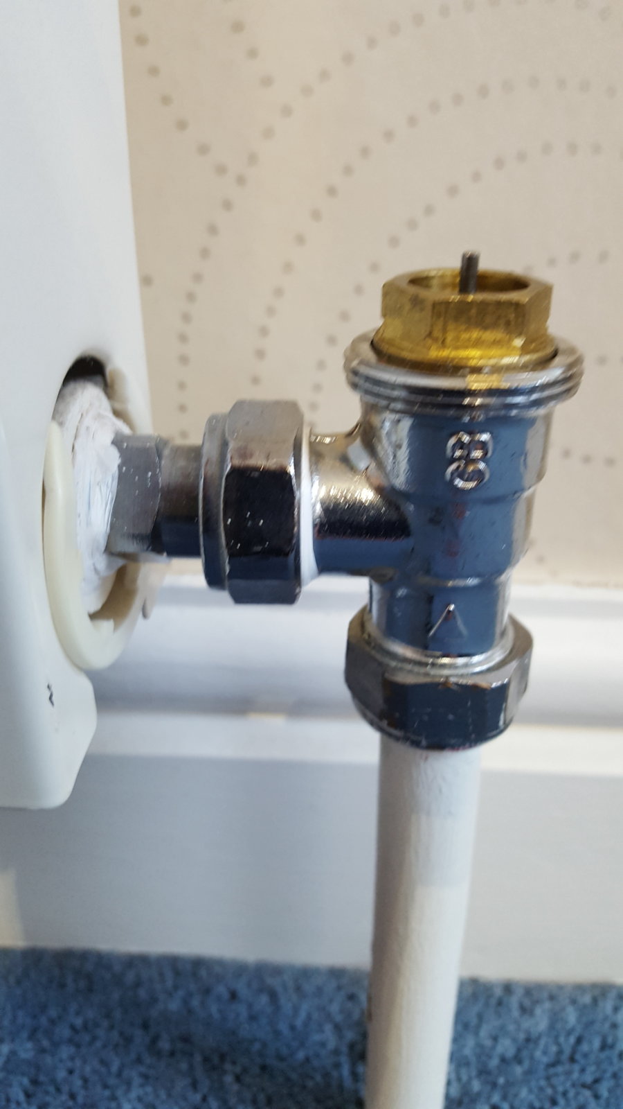

The TRV valve looks like this, which is pretty standard:
Is the strange lockshield connection to the radiator specific to this type of radiator i.e. only a specific type of lockshield can be used? This has put me off changing the lockshield valve as I think the replacement would take up much more space and so the piping wouldn't be wide enough, plus the radiator connections look different due to that large nut.
