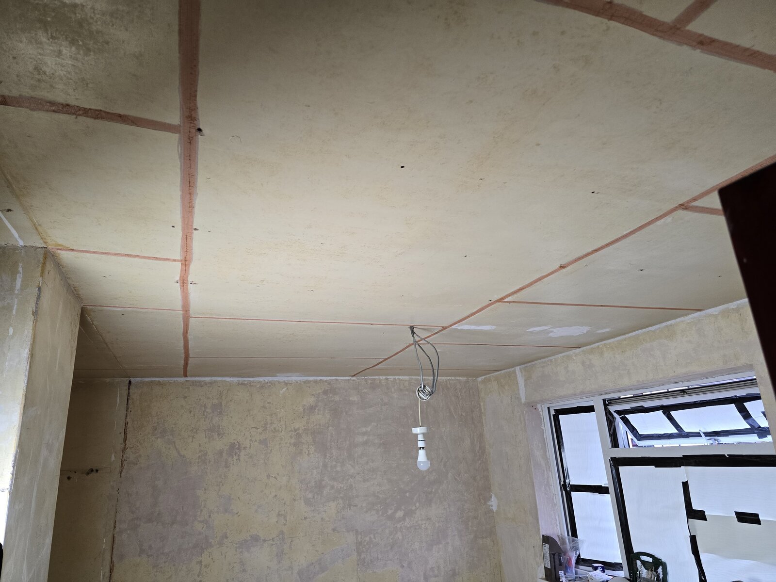

Okay so just to clarify the plan:
Scrape 2mm deep, 25mm wide gaps across all the cracks in the ceiling.
Apply Gardz to the inside of the gaps.
Cut 48mm FibaTape from Wickes down the middle, into 24mm strips. How difficult will that be, with it being sticky?
Apply tape to the gaps
Fill
Sand
Am I correct?

Okay so I've done the scraping but it appears in some areas I'm hitting old fibers from the tape (?) or whatever was inside the plasterboard or something. It's quite messy - will I be able to get away with sealing that in with Gardz before I apply the joint tape?
Also - should I still scrape out the actual cracks to make them wider, even though I'll be putting tape over them?
You can scrape joints wider to fill as this will help stop the air pressure blowing through crack effecting tape.
Plasterboard should have a 3mm gap to allow plaster to fill fixing sheets together although often that's not the case.
I'd apply gardz to make it easier for you.
Fill over that string mesh and after 40 mins (approx) when it's settling add your mesh and fresh mixed filler over.
When that second mix is setting after 40mins mix more and over again.
Help the processes of filling by using a damp sponge. Helps around edges of wet filler to clean and blend in the edges. Can also use sponge to push filler in when filling knife can't reach in deep fills.
Would be worth getting a cheap diy orbital sander bodged on vaccum cleaner with tape or whatever fixing you can make ( see YouTube) with 120 grade sanding discs over the dry filler and that entire ceiling..
Thanks for the advice. So far so good:
Looks good. I'm impressed as it takes effort, and although it's easy enough to do I worry some may struggle when I explain how I do it.
The explanations were great :) I'm filling it right now. As for the fibres - the Gardz helped hold them down so the tape went right over them no issue.
P.S - the wet sponge tip was a godsend lol
