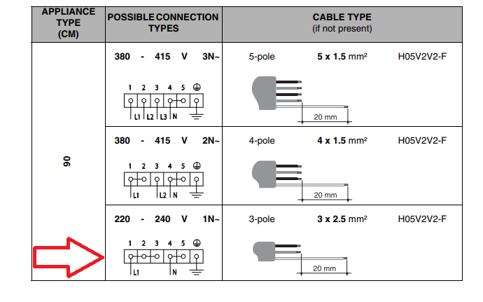

I'm in the middle of a kitchen renovation, and needed some plugs move to accomodate the new layout. The previous, single oven was on the north wall with the cooker switch next to it. We got a double oven range cooker and moved it to the east wall and advertised on MyBuilder for an electrcian to move the cooker switch and a couple of other double gang sockets. The old cooker switch had its own didicated circuit, and from looking at the circuit breaker, a thicker cable than the rest.

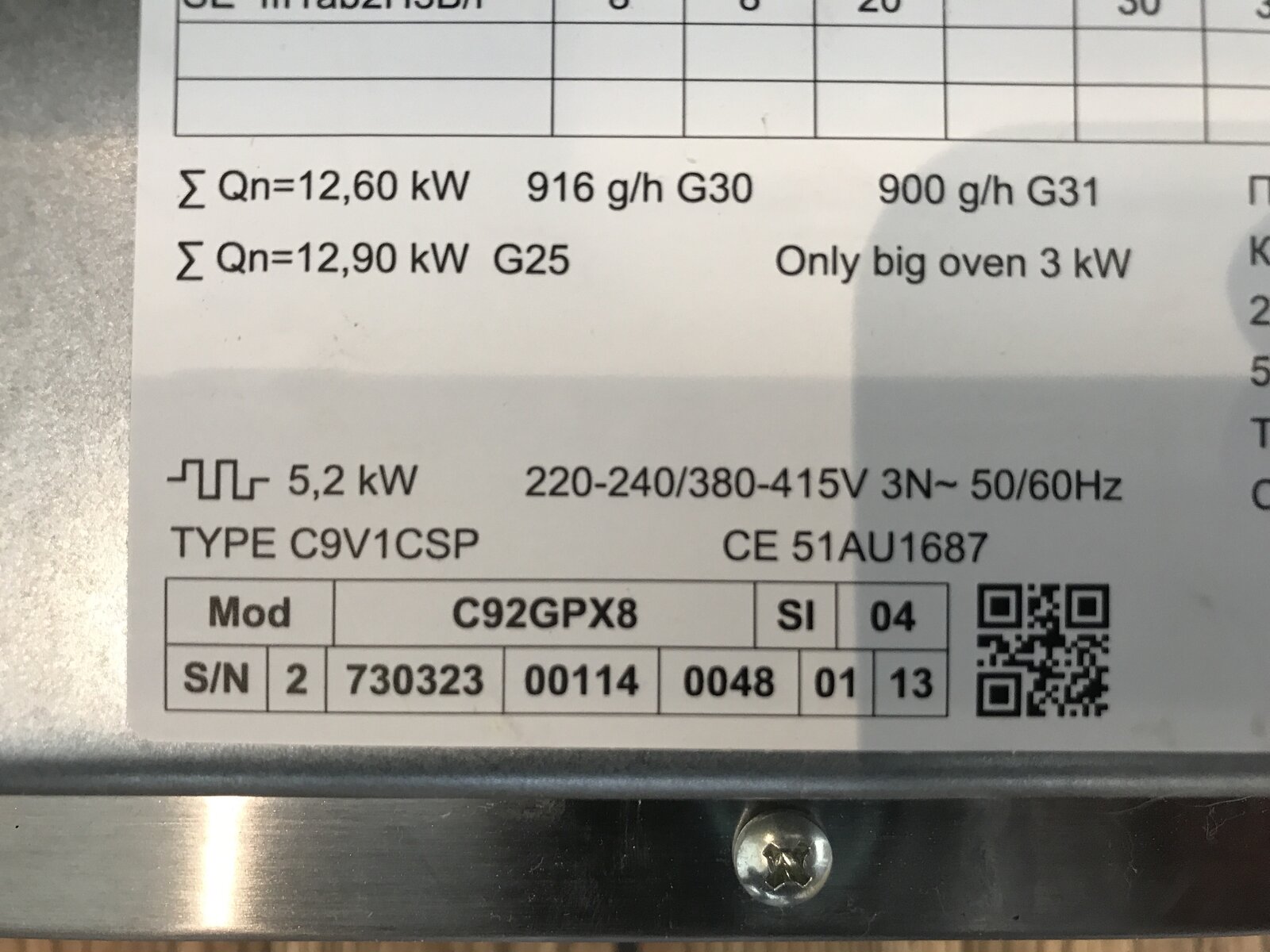

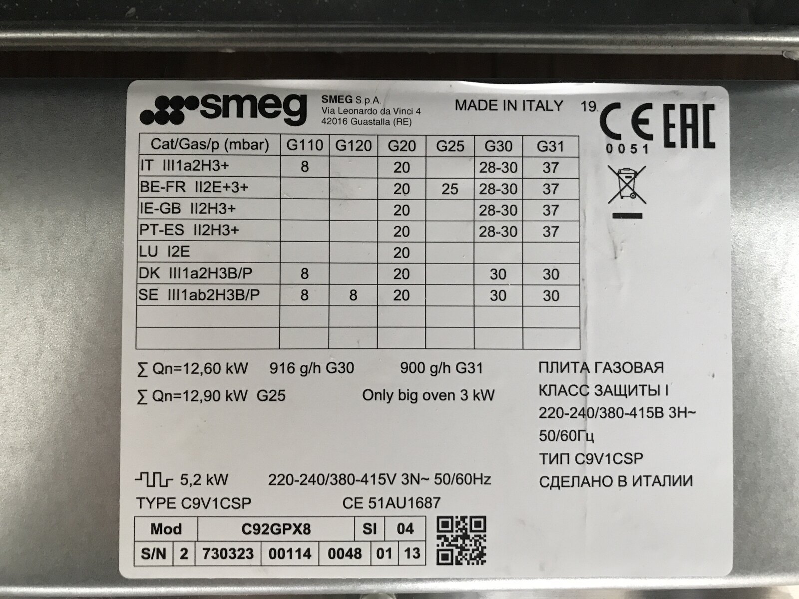

The spark we got had good reviews. However, yesterday I found a sticker under the new over that was attached to three wires that were coming out of the back. It said "Warning not to be used for wiring connection". Looking at it, he has connected these wires to a junction box, and then to the mains supply. That was the first red flag.
Secondly, the new cooker is no longer on the dedicated cooker circuit, but on the same circuit as the kitchen plugs and dishwasher. It also is now connected to a spur with a 13amp fuse in it. I do not know much about electrics so trusted his word at the time, but since finding the sticker and talking to another tradesperson who had some knowledge of the range, am starting to think a corner was cut.
I have attached a photo of the panel under the storage drawer. From using an online calculator, for 5.2kw, a 4mm cable is required, and able to handle 22.6-27amps, much higher than the 13amp fuse in the spur.
How should I bring this up with the spark who carried out the work? I don't want to be antagonistic or start anything argumentitive, but I do want him to redo the work I requested and have paid for completed correctly and, most importantly, safely. To any professional electricians; how would you best appreciate an issue like this being raised with you?
