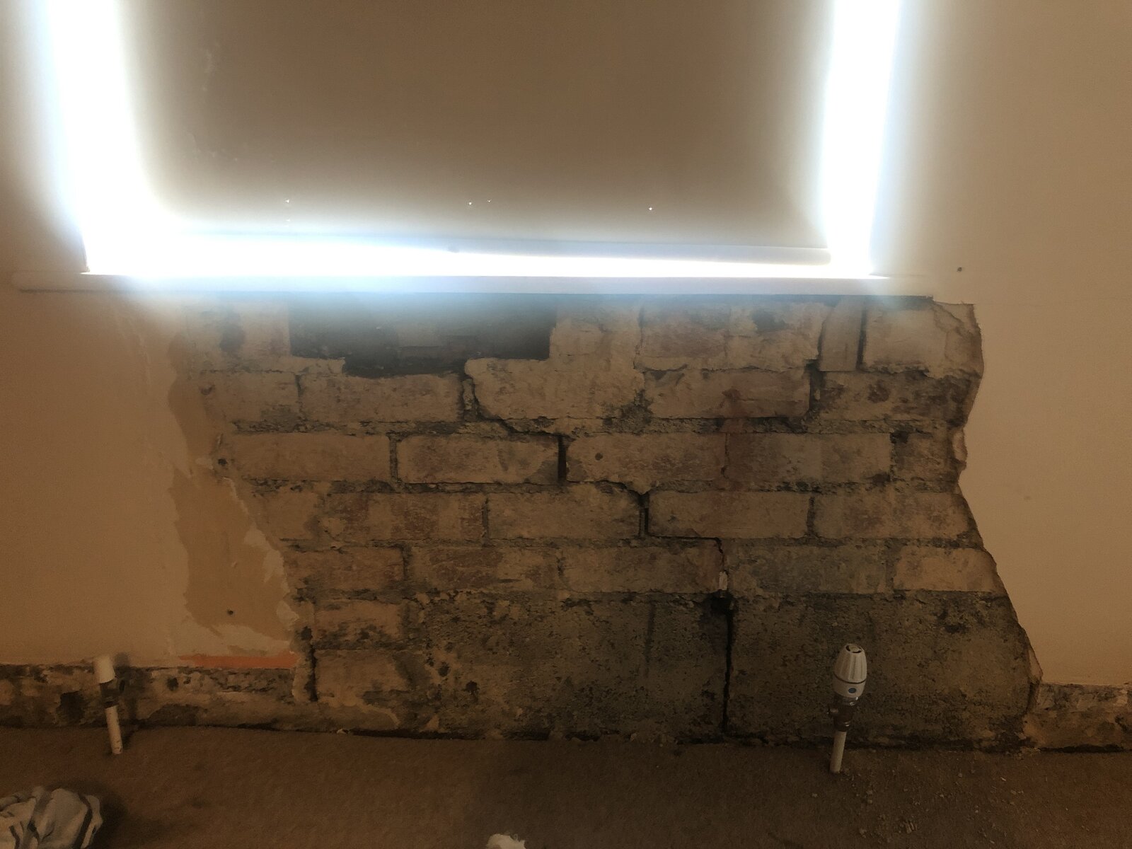

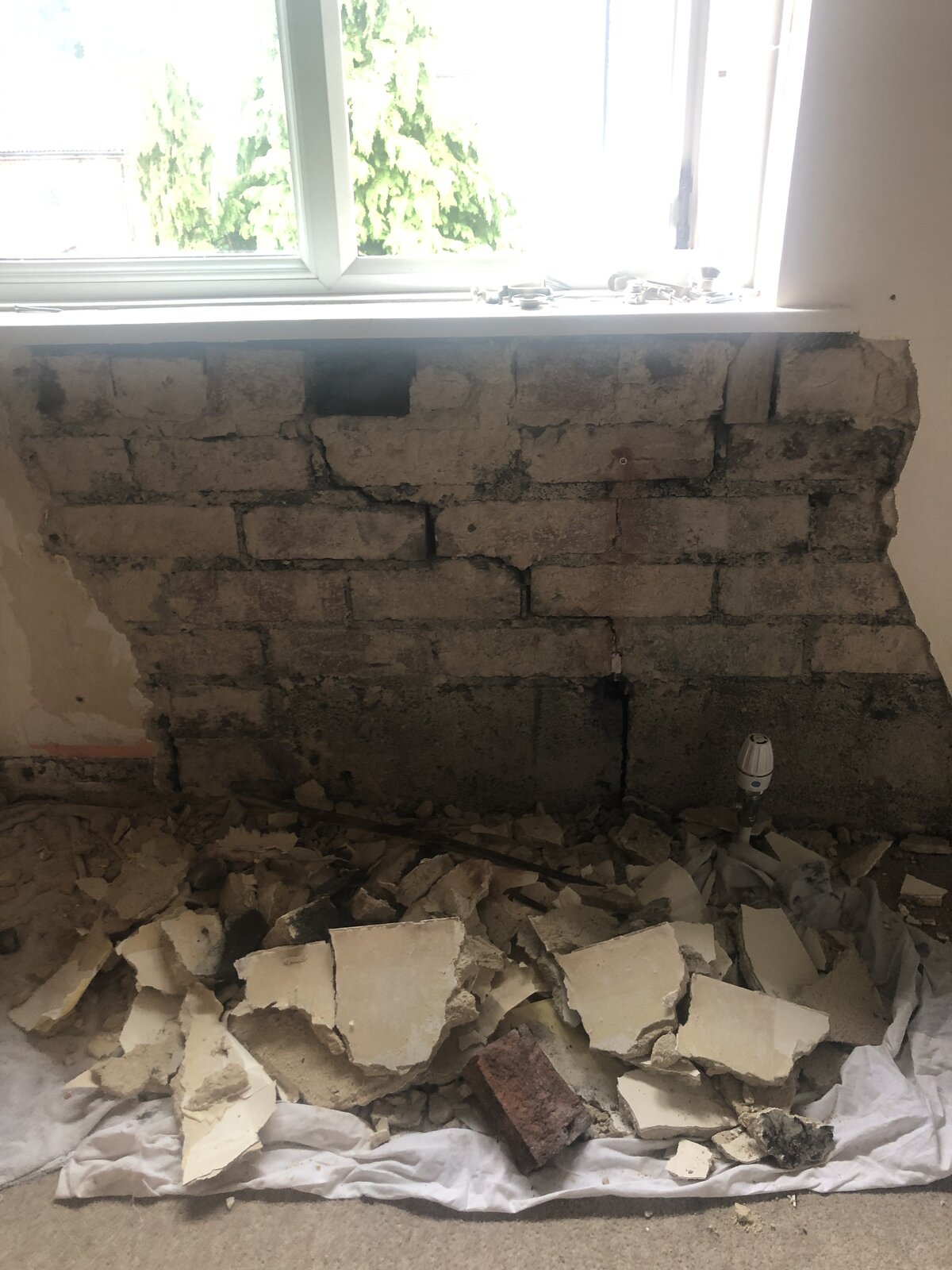

Renovating a bedroom and some old lime plaster is loose with cracks. Have chipped it off hoping to just patch it up with plasterboard etc however under the window there a couple of loose bricks, v badly put in. Outside bricks are absolutely fine.
Any advice on sorting? Thinking to just get the loose bricks out, put new ones in and re-brick the small area. But not sure if more support might needed given it looks like some bricks have already pulled away.

No weight under sill so when ground moves that's the area that moves first.
Just point up
Cheer. Would you suggest putting some support directly under the sill?
