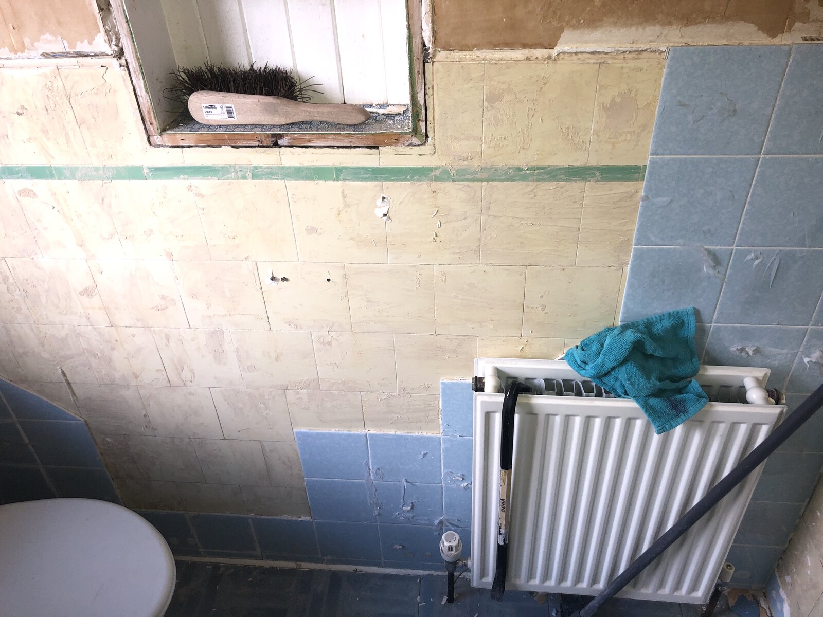

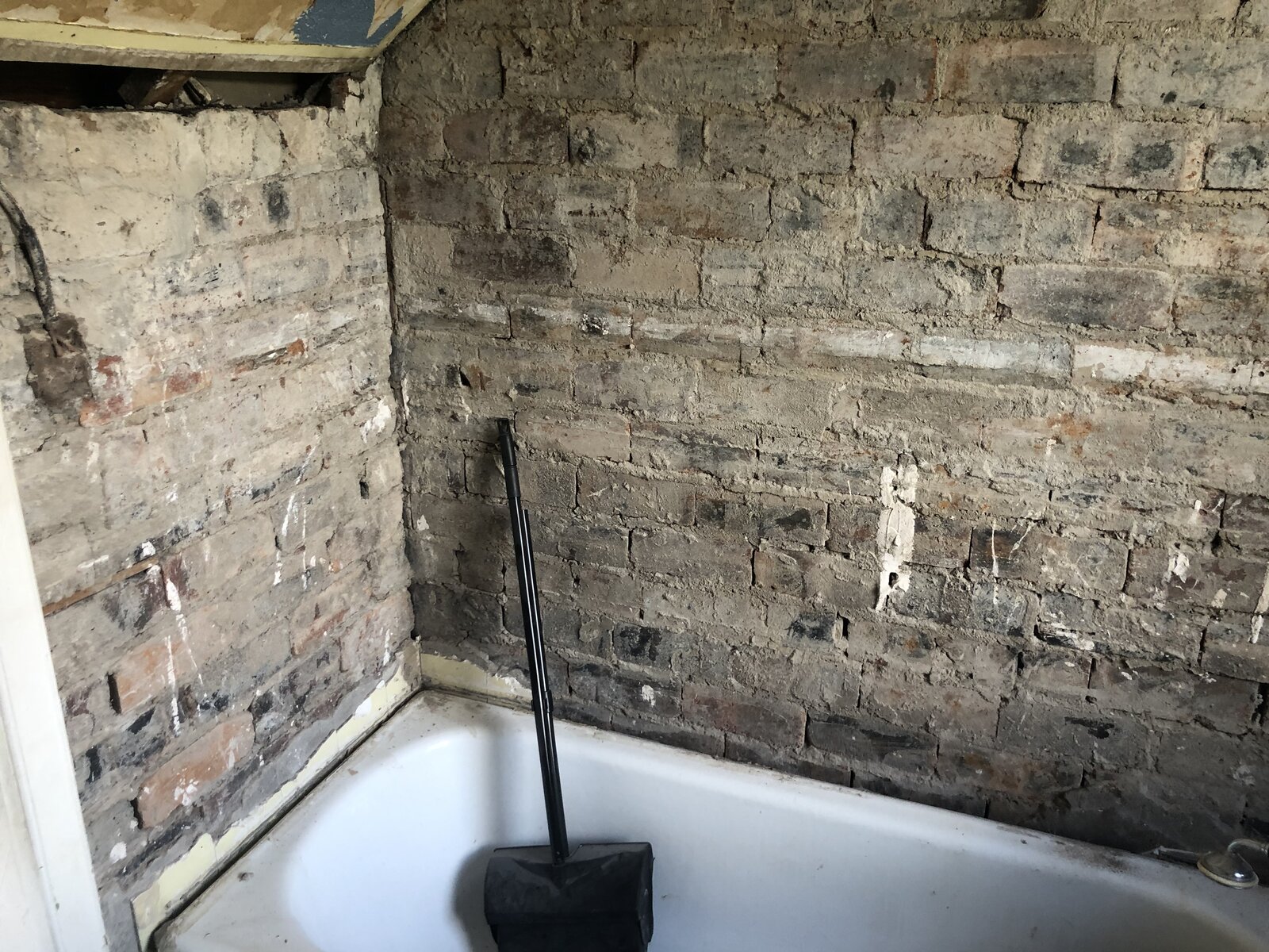

* Strip out the existing bathroom (downstairs) back to the existing internal brick leaf, clean down the brick.

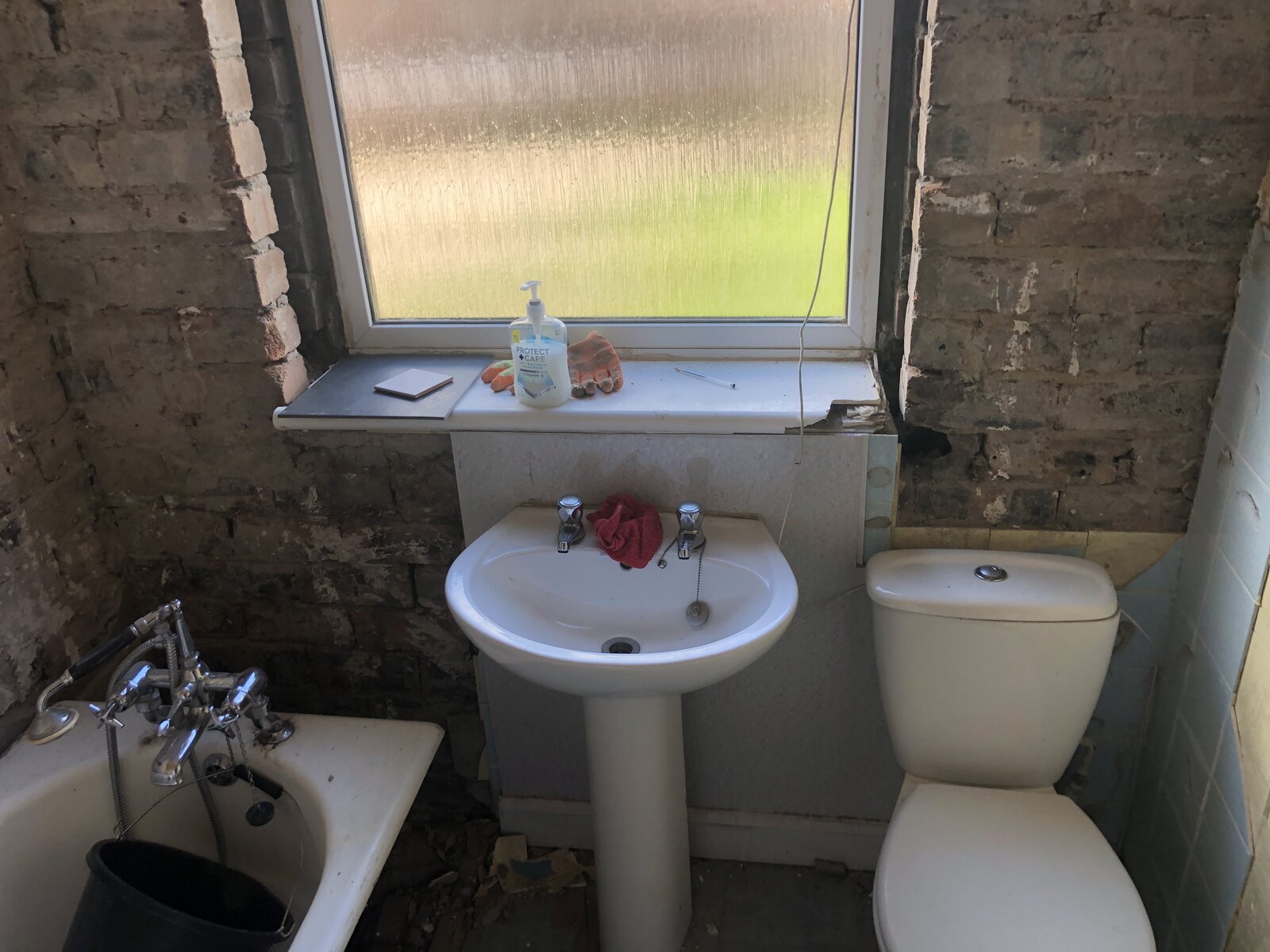

* Remove bathroom window and replace with window half the width - brick infill opening, render external.

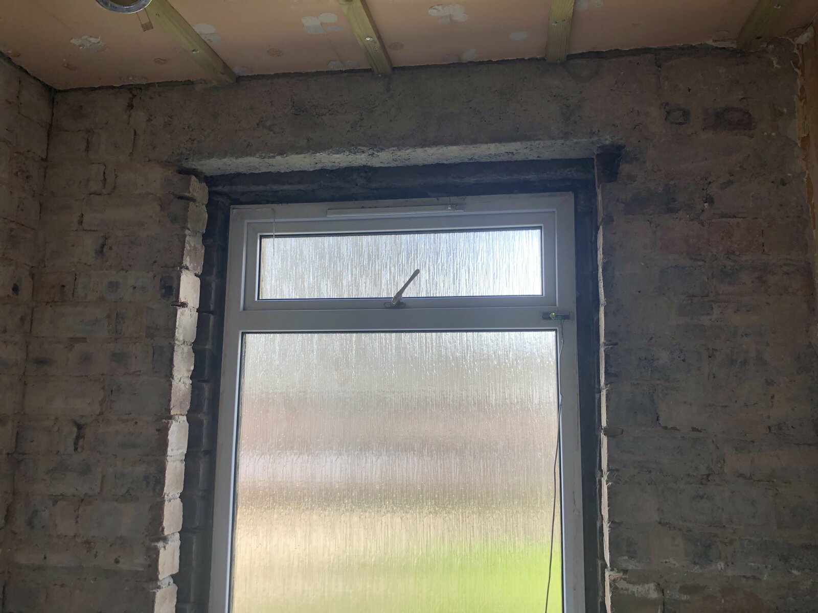

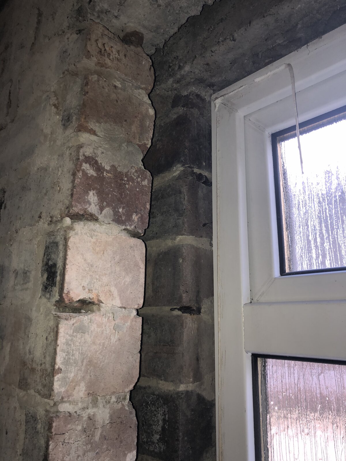

First up this week I have to go along to the supplier and pick up my window, I'm replacing the current 1300 x 1000mm window for a 1300 by 500mm and brick infilling the opening. he current wall construction is a brick cavity wall with an uninsulated 75mm cavity. My builder is coming around this week to install the window
I'm still not 100% sure of the detail to the perimeter of the window on the inside. The window is fixed within the zone of the external brick leaf, I have two concrete lintels at the head with a slight height difference between them, the internal is approx 25-30mm higher than the external.
The cavity is open as shown on this image.
On that inside wall I'll be building a stud frame from CLS set about 10mm in from the window. On that we have a 12.5mm moisture resistant Gyproc board, 6mm tile adhesive and 10mm tile covering ... so approx 102mm o/a from brick to finish face.
So I assume I need some kind of closure to the cavity (btw, I'm also pencilled in to have the bead cavity insulation in the coming months), timber supports, lining and then should I tile into the window or have a timber surround with a facing on the head and jambs and a timber window cill.
Dunno?!? Bit lost on that one to be honest as I don't know the typical build details for internal window surrounds.

As said earlier, that wall will be stud frame and all other walls will be stripped back to the brickwork and then dot-dabbed by a moisture resistant gyproc board, ready for tiling.

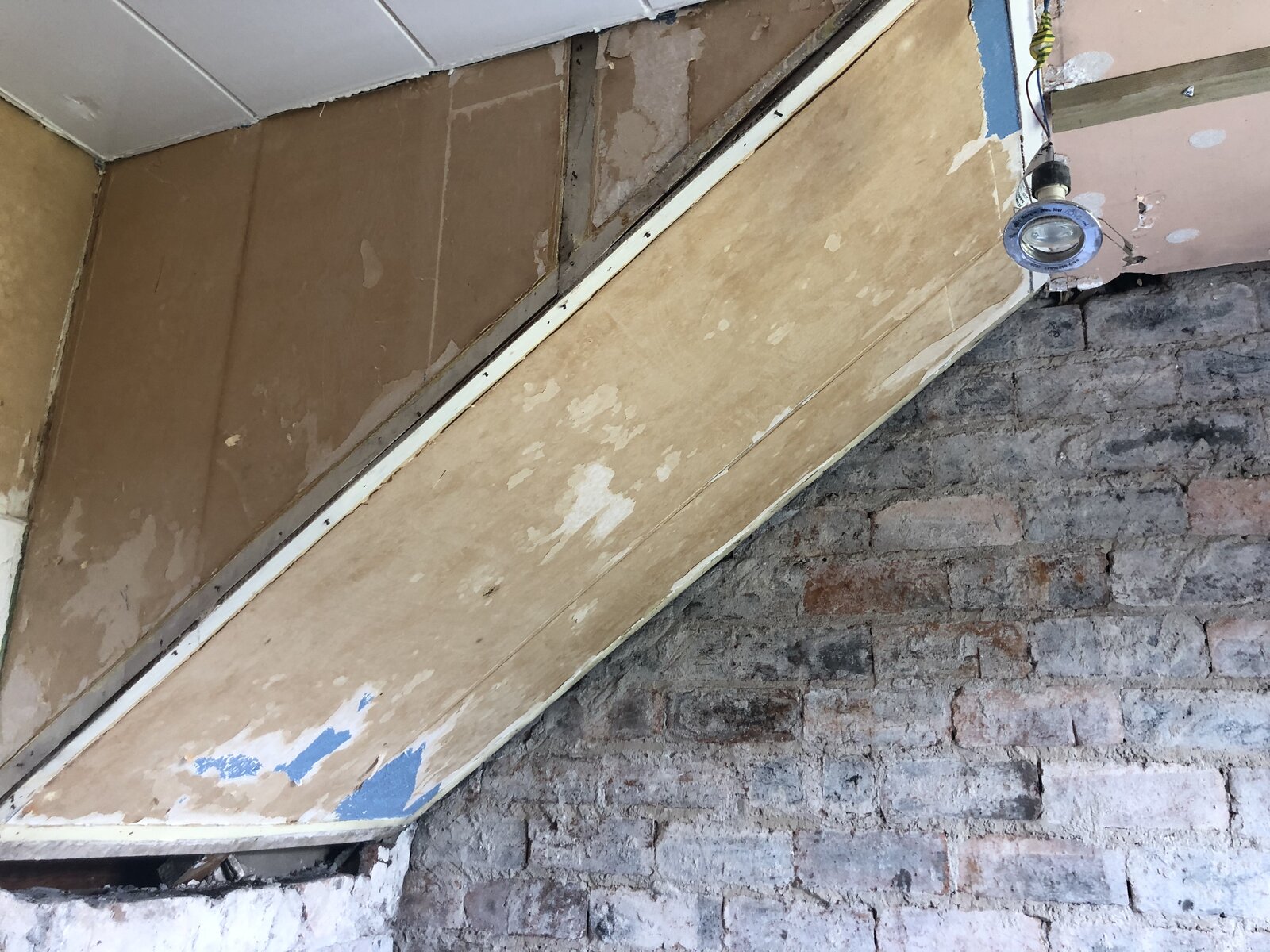

On this area where the stairs are shooting into the room.
I'm going to strip off that old plywood lining and install moisture resistant plasterboard and plaster finish, painted white as per the ceiling.
That ceiling you can just see there is a n existing wet board, fixed to battens fixed through lath and plaster ceiling into the joists. I am really torn as to whether it would make a better job to pull down that ceiling, expose the joists and fix my boards direct to them (which are at 400 centres) or would I simply be making a messy, unnecessary job for myself and potentially opening a can of worms.
My bathroom installers are in favour of just strapping it out with battens and boarding over.
