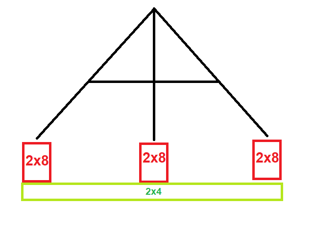

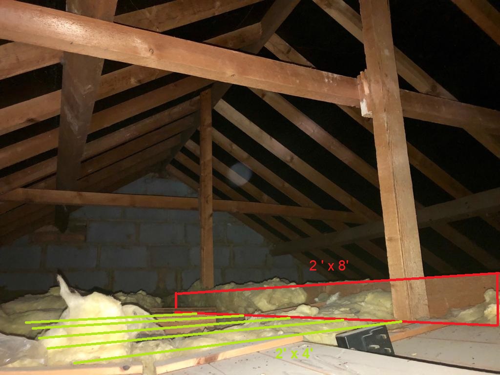

We had a quote to have once side of our loft boarded, so we can use it for (light) storage, i.e Christmas trees, few foldaway chairs for big dinners etc.
We've received a reasonable quote from a reputable company which I'm inclined to continue with, but I would like a common sense check prior to the work.
The first picture is of the loft space, with the main floor/ceiling beams depicted in colour. If it's not obvious the green 2x4's run 90 degrees to the bigger beam.
The second picture is a cross section, depicting the fact that there are 3 of the larger 2x8 beams, one in the middle and one at each edge where they meet the rafters.
The chap has said they would install timber cross bracing spanning the three 2x8's, so to my knowledge there'd be no weight on the 2x4's (am I right in saying they're just holding up the ceiling)? This seems sensible to me but I am ignorant to roof loadings and don't want to cock up.
Are there any issues I should be aware of? I intend to make sure;
- The boarding doesn't go right into the eaves, to allow for ventilation
- The boarding leaves an air gap above the insulation, to prevent condensation
