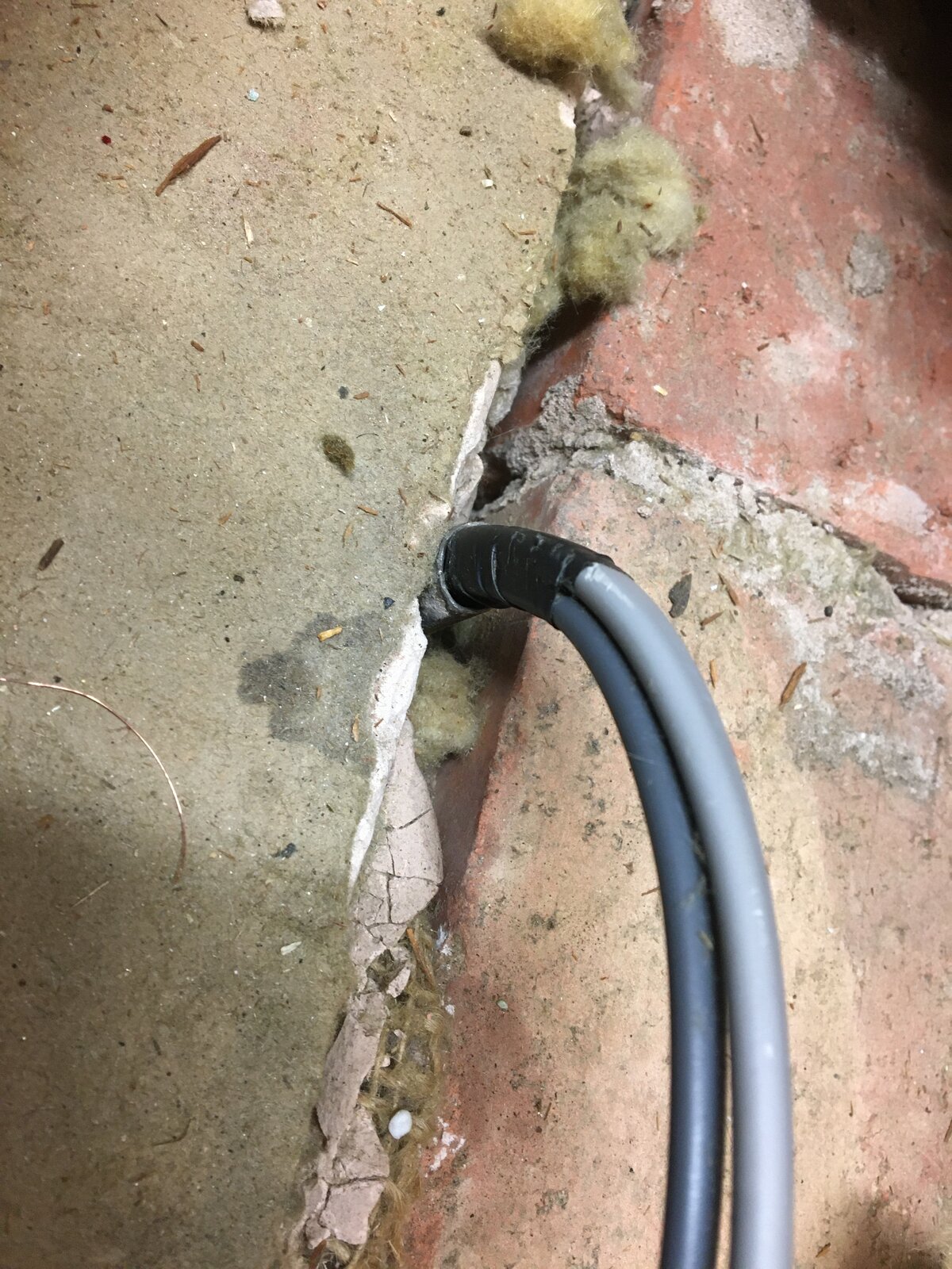

When he came to install the new cabling here found that he could not install the twin & earth cabling with the sheath attached as there was not enough room inside the conduit.
His solution was to strip the sheath from the twin & earth cabling and then wrap all the individual wires together in electrical insulation tape.
Removing the sheath created the room required to be able to feed the cables down the existing conduit.
Where the conduit ends in the loft space he left the sheath on the cables & the ran them to a junction box.

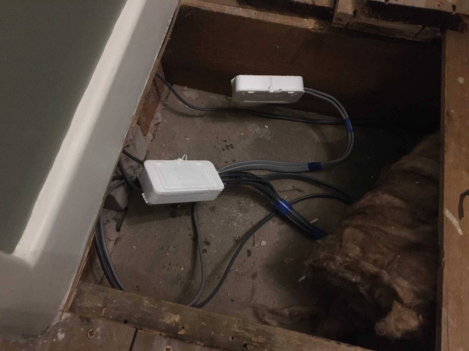

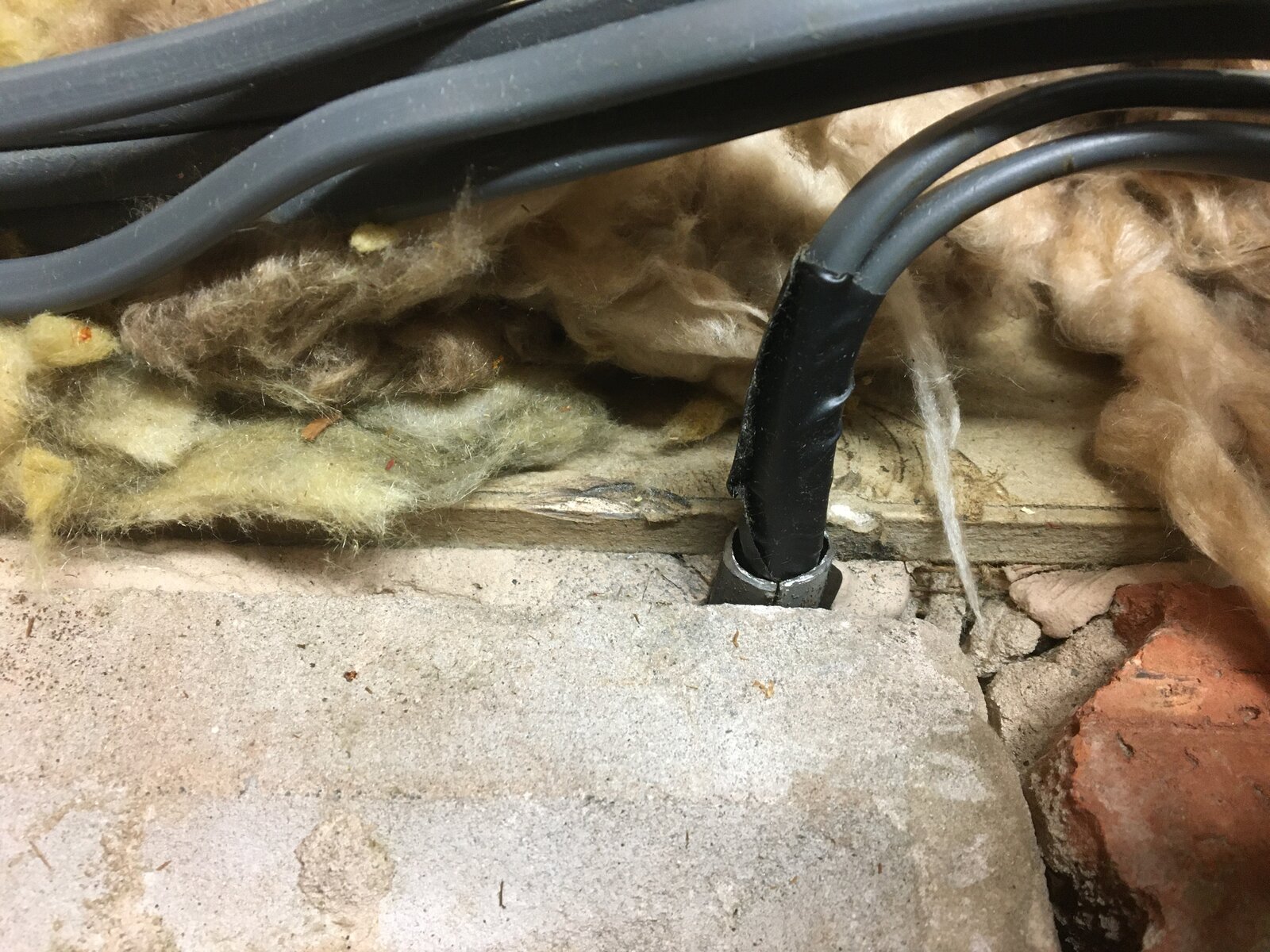

I have attached pictures to this post of the junction box in the loft space & the tops of where the conduit for the switch drops end.

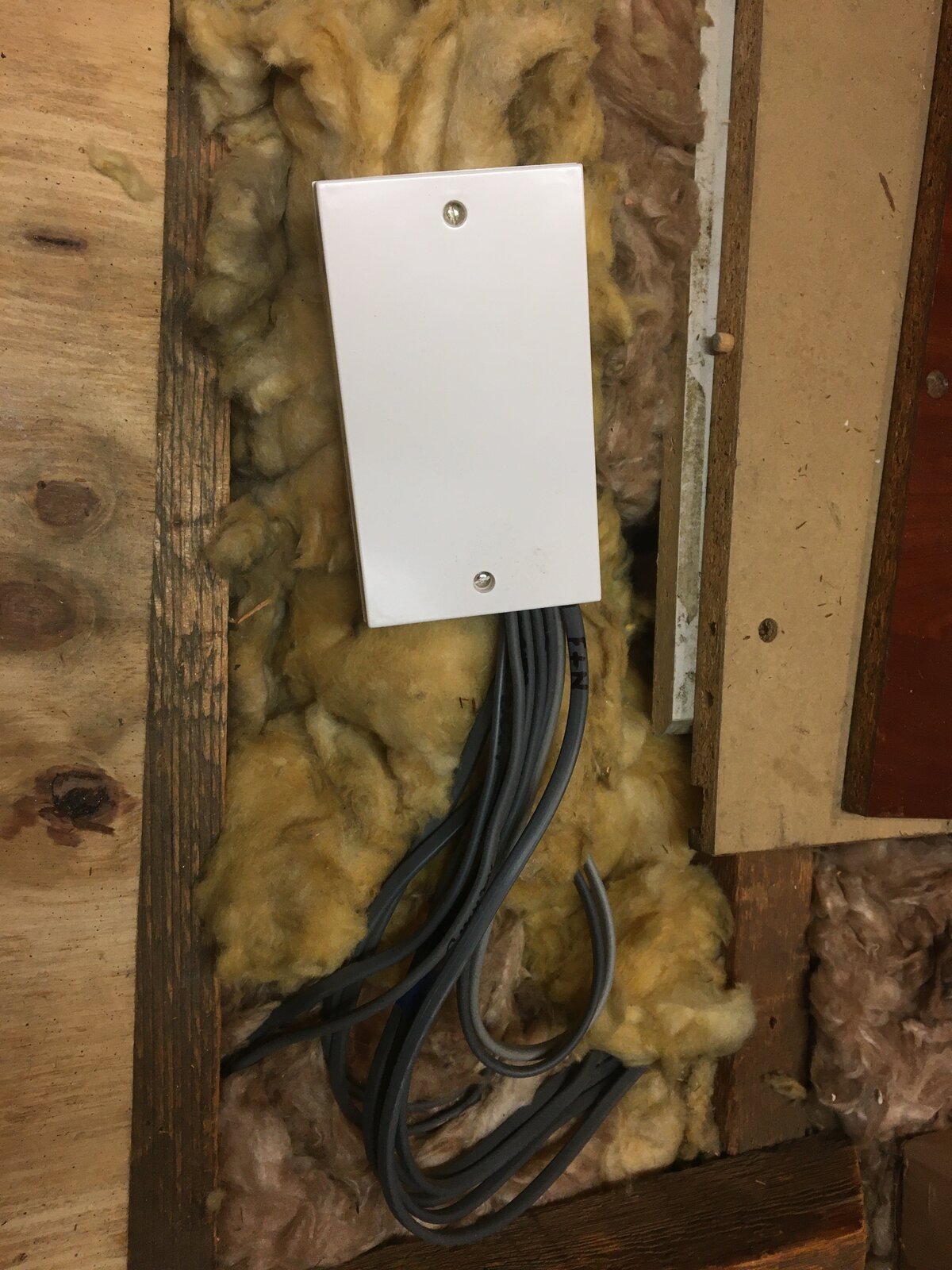

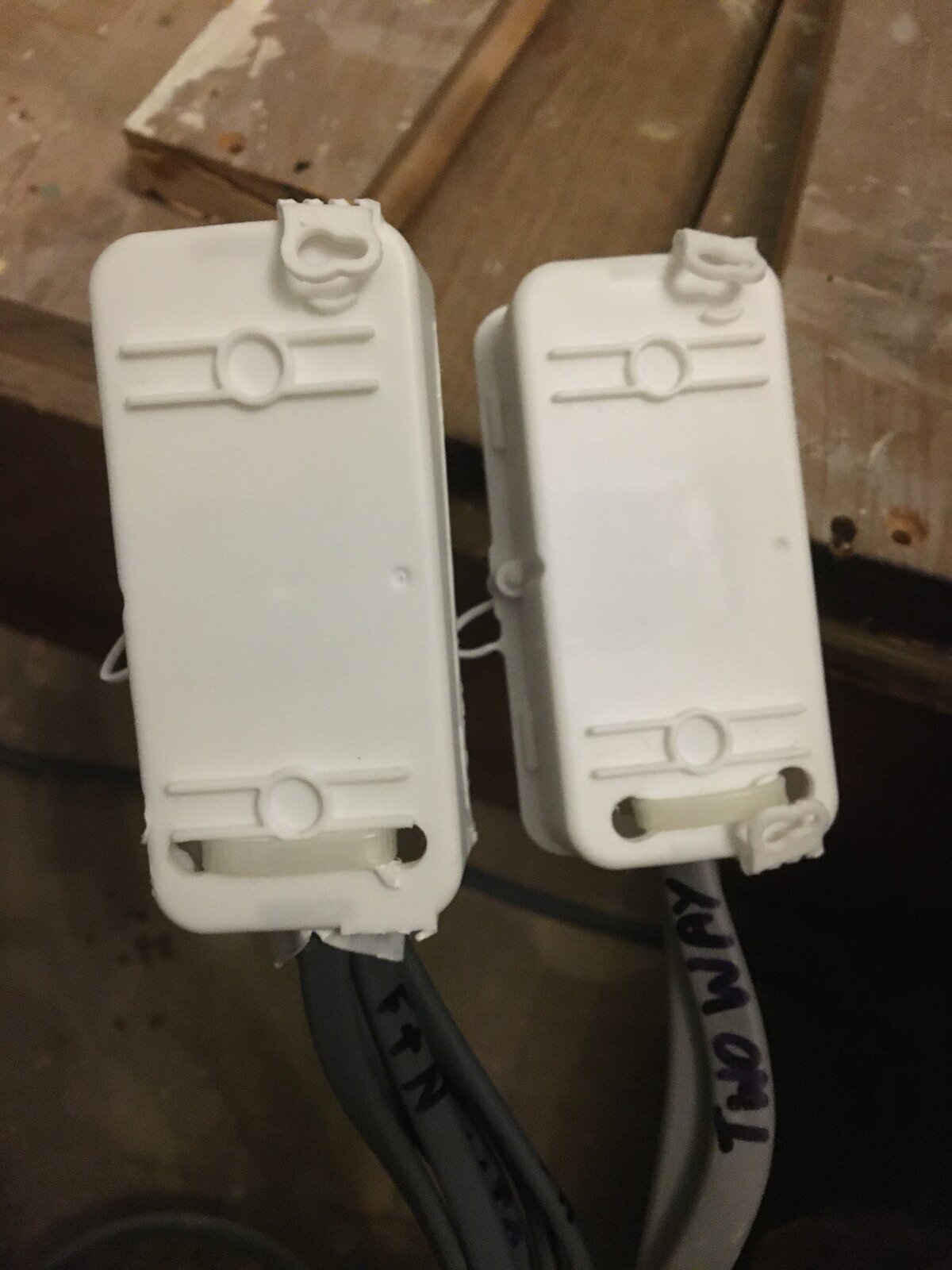

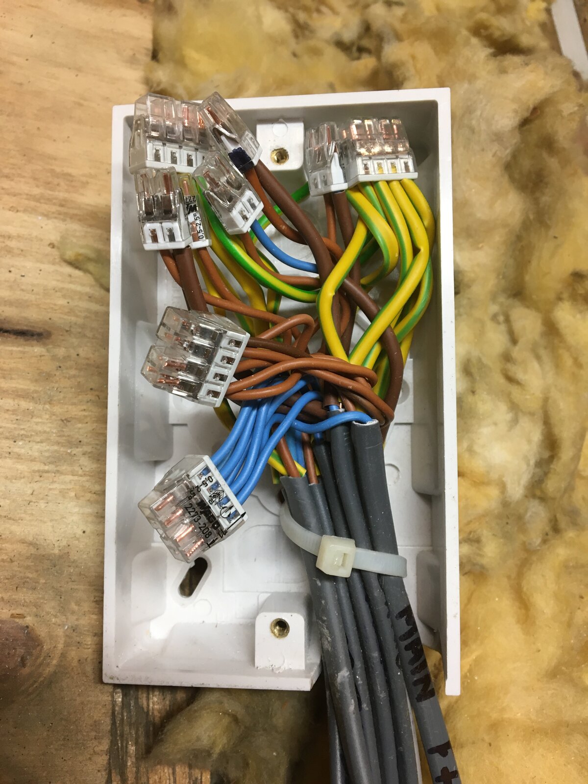

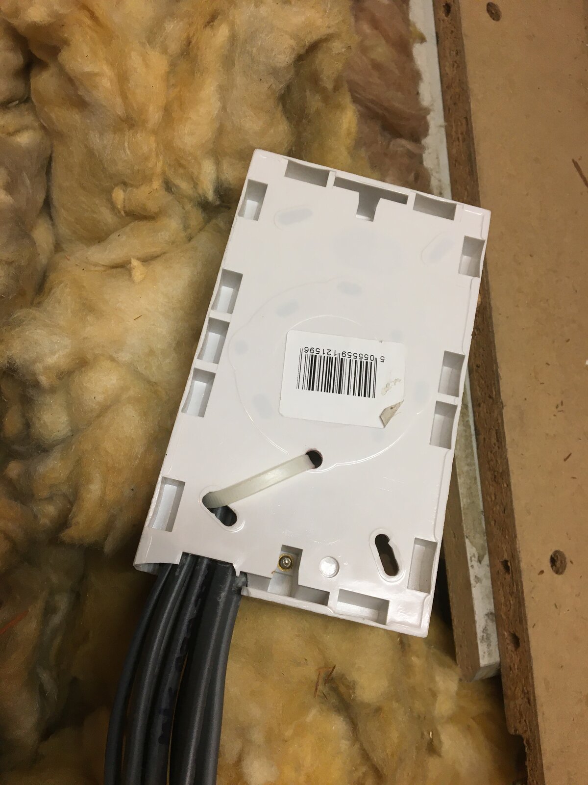

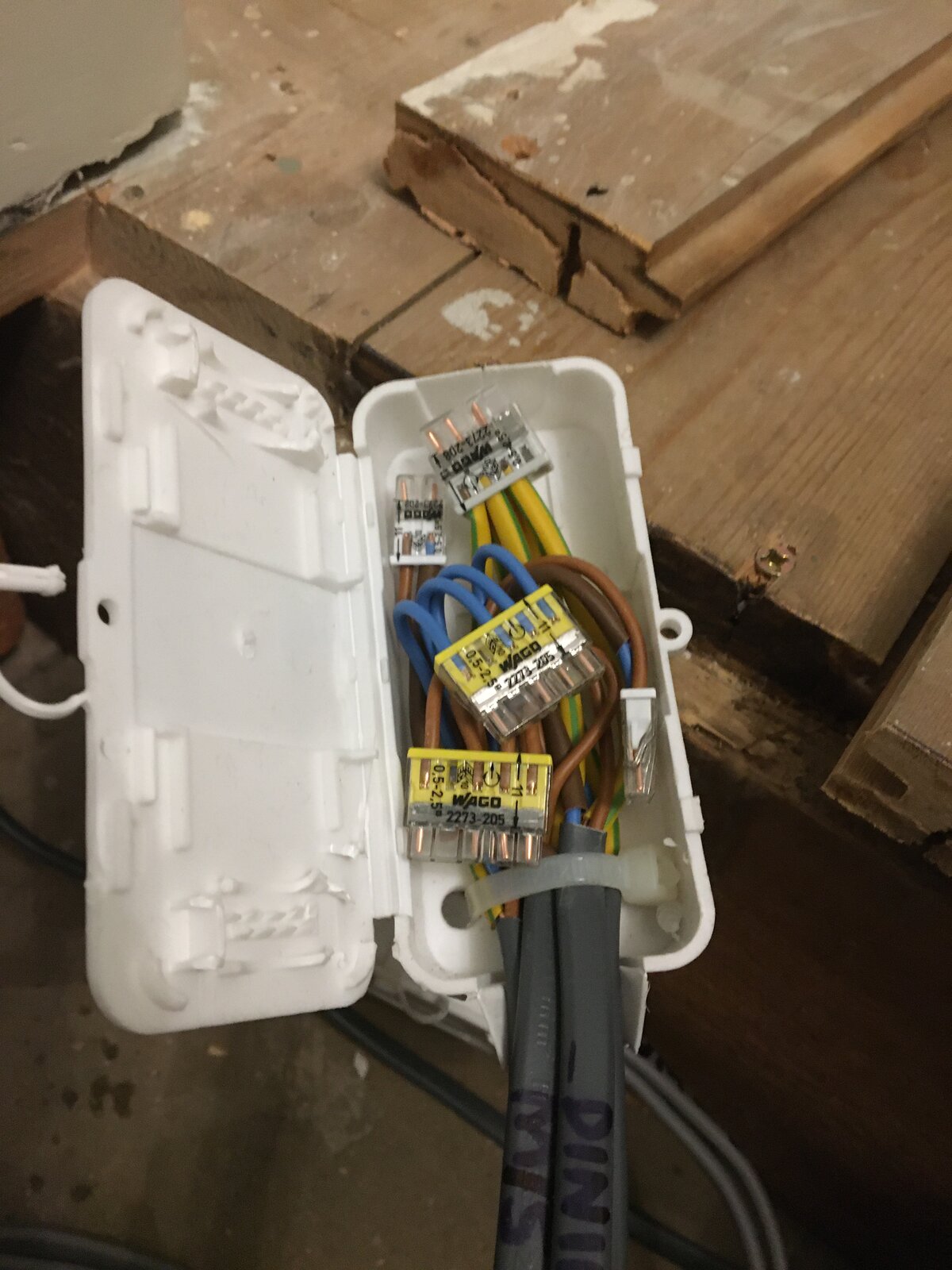

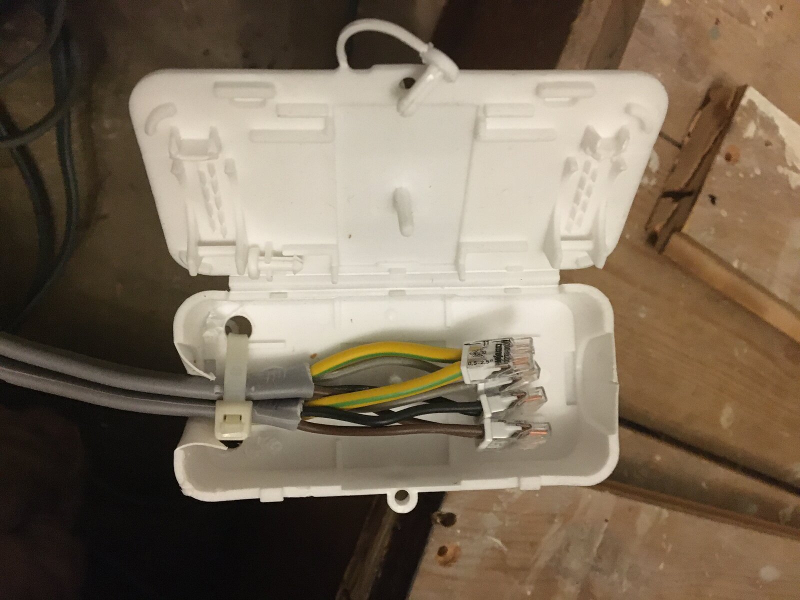

The same lighting circuit also covers not only the upstairs bedrooms but the landing, hallway & dining room lighting so cables needed to be ran under the landing floor boards & junction boxes installed.
I have attached pictures to this post of the junction boxes under the landing floorboards.
So my question is are there any issues with how this work has been carried out?

It's not particularly dangerous ,just hard on the eyes. I assume some junction boxes are going to be under floorboards ,and if so would be deemed not accessable. So they must be in maintenance free junction boxes to be compliant. It appears to me that some are not, although the electrician has made efforts to try to comply with the spirit of the regulations by adding cable ties to provide strain relief.
Although so many junction boxes are generally frowned upon ,there is no regulation that forbids them.
Taken into account your reluctance to have walls chased out ,and preferance for the conduit to be used ,the installer has probably had to work his way around this.
Taped up singles inside unearthed steel conduit is certainly not compliant with the regulations, nor are those joints flapping about in free air.
As the lighting has been rewired using the junction box method I’m unsure why the wiring couldn’t have been run in properly.
Thanks for your reply, so the junction boxes are none compliant as they are not maintenance free?
I agree, I did push for the existing conduit to be used but if this was not possible then I did say other options were on the table but he did not give me any other options.
Thank you for the information, other than converting to a wireless system like Quinetic to get round the conduit issue & not chase the walls out would the use of conduit cable have been an option to keep the work compliant?
I presume the junction boxes should be secured to the joists?
I presume when you say "I’m unsure why the wiring couldn’t have been run in properly" that the cables would be ran sheathed in the conduit?

AFAIK, that old split tube conduit was never intended to act as a CPC and was never connected back to the MET. In addition, the joints were not of a type where continuity could be ensured.

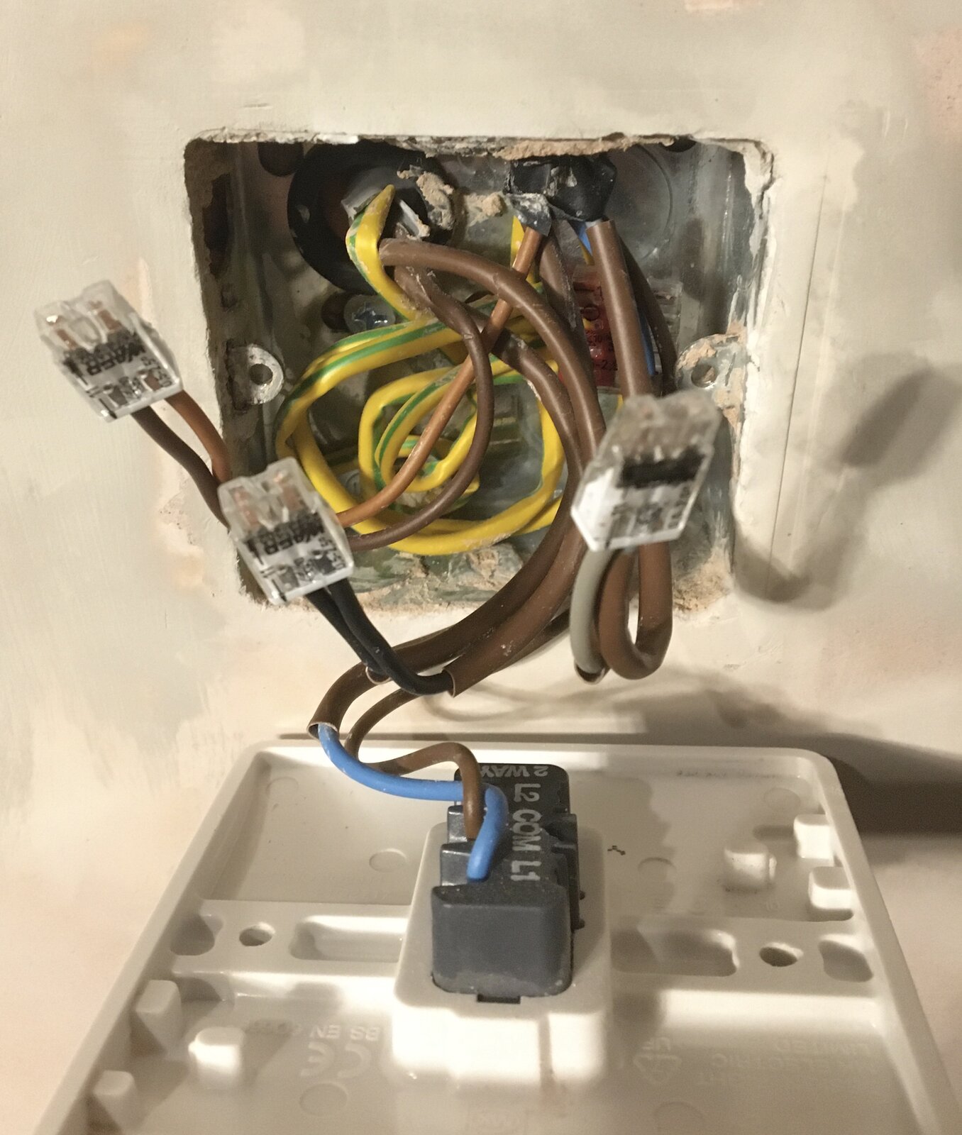

I suspect where he has attempted to get two twin and earth cables down one tube, he could have in fact used a 3 core and earth cable, and altered his wiring at the junction box accordingly.
He shouldn't have done what he did, the conduit should be earthed if it has single insulated wires in it, and the use of tape round the top of the conduit is utter rubbish.
Show us what's inside the switch where he has tried to get the two twin and earths down, and we may be able to think of something better.

Here is a picture of behind one of the light switches that is fed by the cable drop that has the three core with a twin & earth cable fed down it.
You can see the three core cable going through the rear of the back box to the two gang light switch on the other side of the wall.
The light switch on the other side of the wall is a 2 gang switch.
