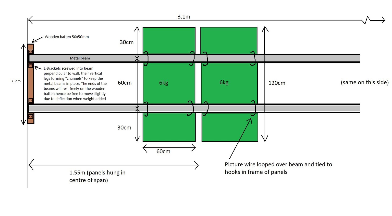

Apologies for starting another similar thread to the one about angle iron - but thanks to advice given in the previous one, the plan has significantly changed, and the main question is now different:

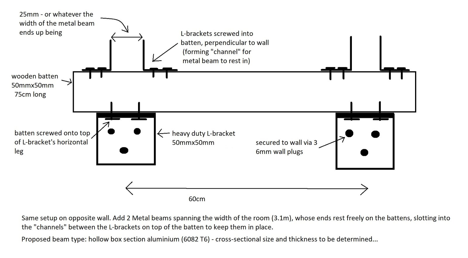

I have determined hollow box section aluminium beams are what I need for this project, and the basic question is, what cross-sectional size & thickness do I need to adequately support 6kg in the centre of a 3.1m span, "simply supported" at either end?
Have attached plans, and you'll see the overall setup is a bit more complex than that - i.e. two parallel beams collectively supporting 12kg spread over the middle-most 1.2m of their span - but to keep it simple, I think the problem can be reduced to a single beam supporting 6kg dead in the centre (which should also give a bit of a margin for error).
As I understand, so long as I choose a good grade aluminium (the ones I'm looking at are either 6082 or 6063, T6) then strength is unlikely to be an problem (due to light load), but deflection could be significant (due to long span). I have come up with a way of mounting the beams so deflection will not be an issue in terms of causing stress to any mountings, but would still like to keep the deflection to a minimum (say 1cm max), while also keeping weight down as much as possible. Keeping weight down is why I'm looking at aluminium rectangular box section (with larger sides vertical)
I'm looking at something like: 25mmx50mm, 3.2mm thick - with the 50mm sides vertical - several different AI models give me deflections of around 4mm for this. BUT, as discovered in previous thread, AI is not always that intelligent... hence would like some real-word input on whether this sounds realistic!

Plans below:

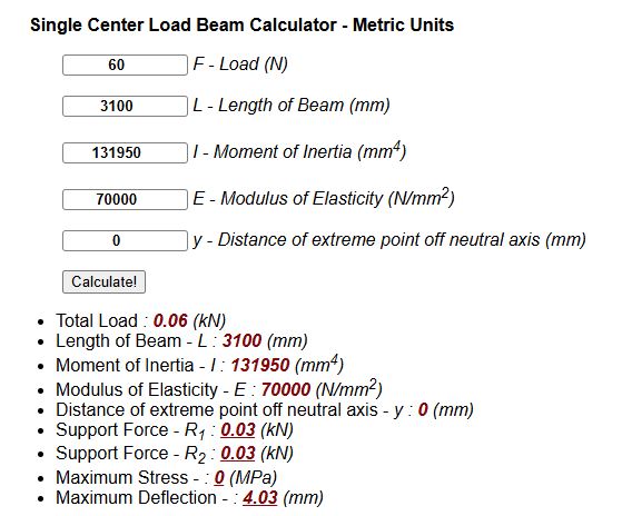

Using the Engineering Toolbox calculator:
F = 60 N
L = 3100 mm
I = 50000 mm4
E = 70000 N/mm2
y = 0 mm (????)
gives max deflection = 10.6 mm.
Now find an aluminium section with I = 50000 mm^4.
For a square tube of width and height a and thickness t, I = ( a^4 - (a-t)^4 ) / 12
So 50 x 50 mm with thickness 1 mm, I = 40000. Almost strong enough but not quite.
I hope you can work it out from there!

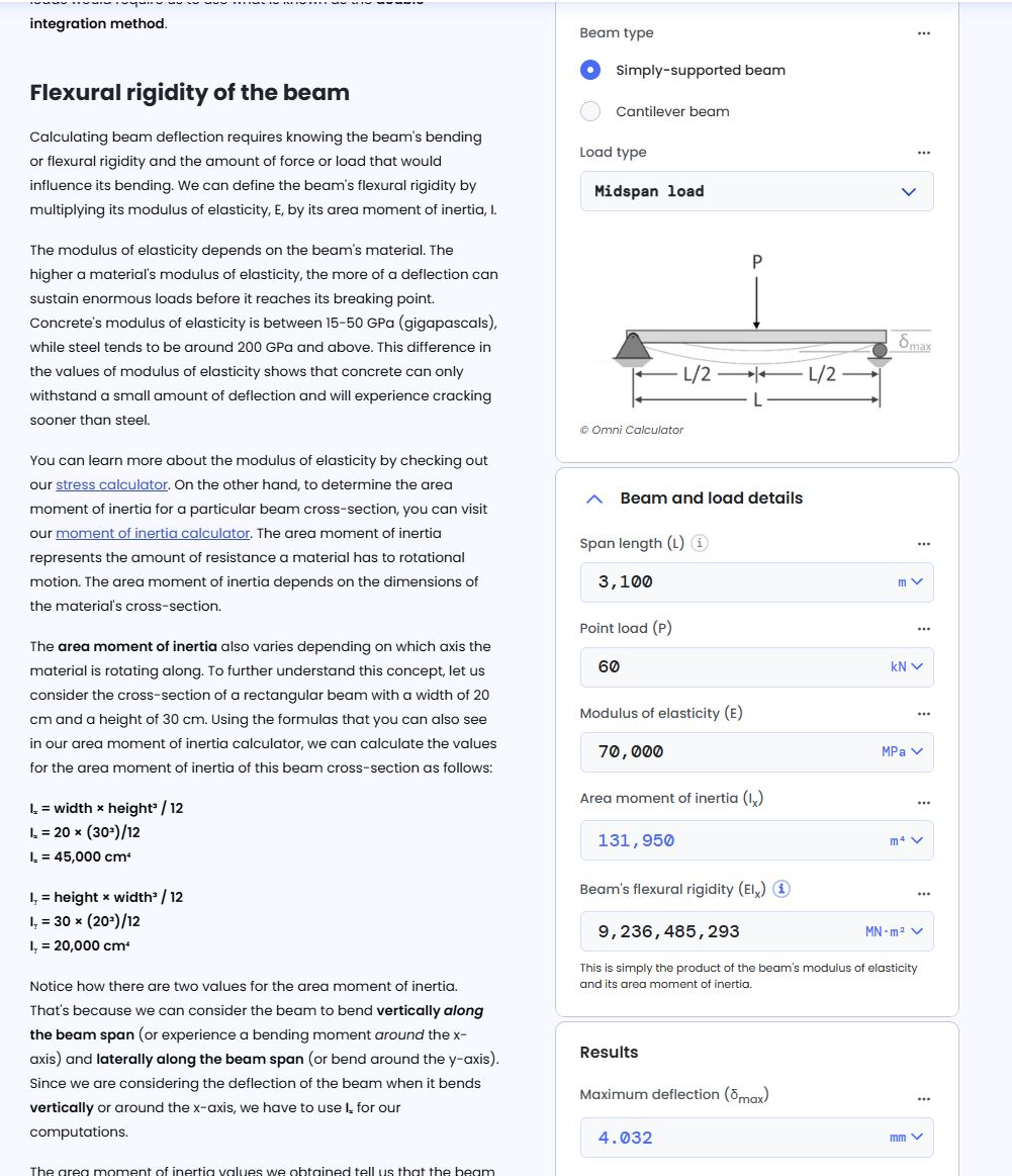

I referenced your data and formulas above, and I think I've got it figured out now - key part was understanding moment of intertia (had to find a slightly different formula due to rectangular shape), which is the only variable I need to change here when comparing different size beams. Have used the calculator you linked to, plus another I found, and for a beam 50mm x 25mm, 3.2mm thick (which I can get from Metals4u), I'm getting consistently around 4mm deflection. Of course I need to factor in the weight of the beam itself, and calculating this as a uniformly distributed weight I get 1.51mm. So 5.47mm total deflection. Which should be completely fine.
Can now run numbers for the different sizes that are available to e.g. check if a 40mm height would work. So thanks again for your help, the "teach a man to fish" approach is much appreciated. Should now be able to build the damn thing, which will probably take a fraction of the time it's taken to plan it out ;)
