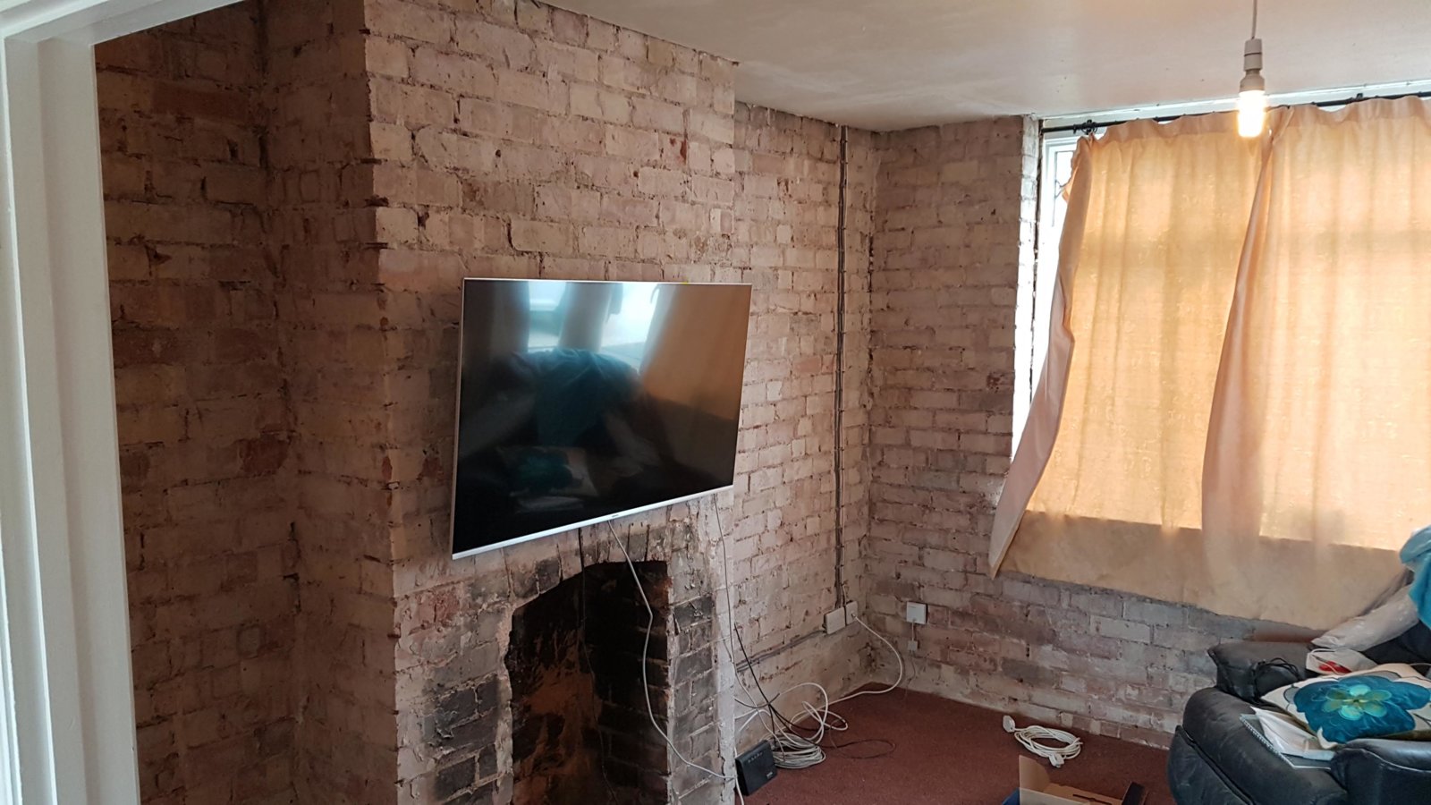

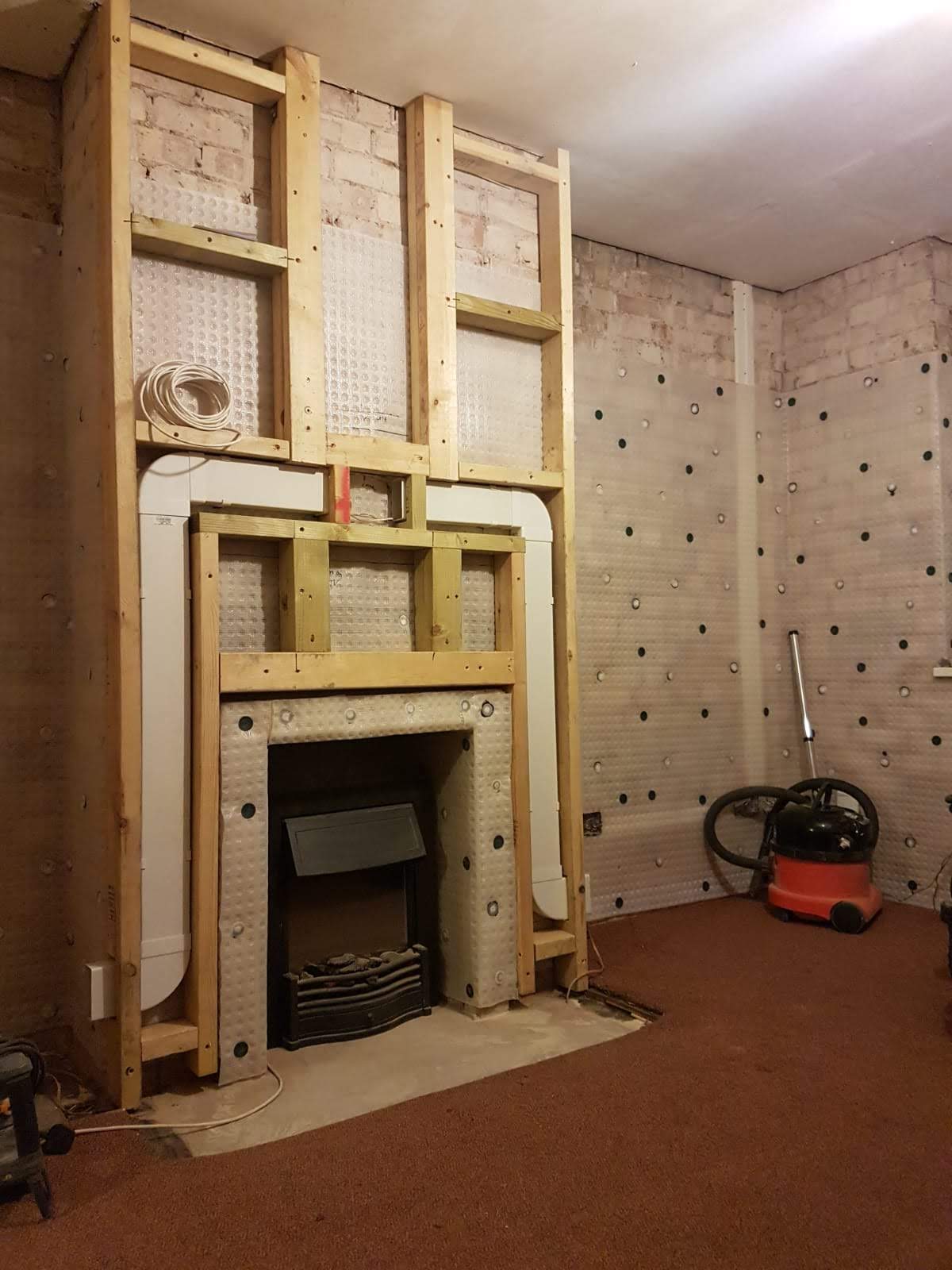

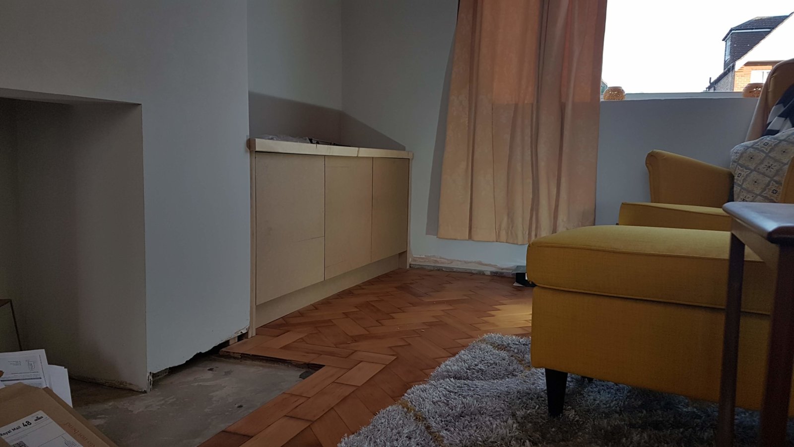

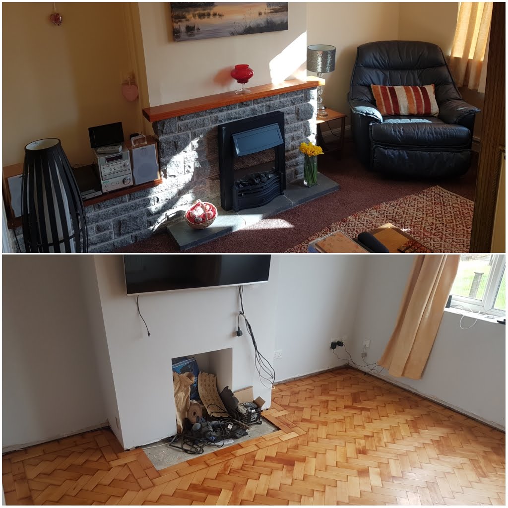

Probably not entirely relevant now but when I moved in to a 1930's house we had a few signs of damp mainly on external walls tiny bit where internal walls joined external ones.
Long story short we ended up going back to bare brick then using a mesh membrane then dot and dab on top see photos
Not sure ours is a true representation of yours as we had concrete floors with original parquet on top
Fire place was built out to give sufficient depth for the cupboard
The house has been plastered for nearly a year now with no signs of damp
