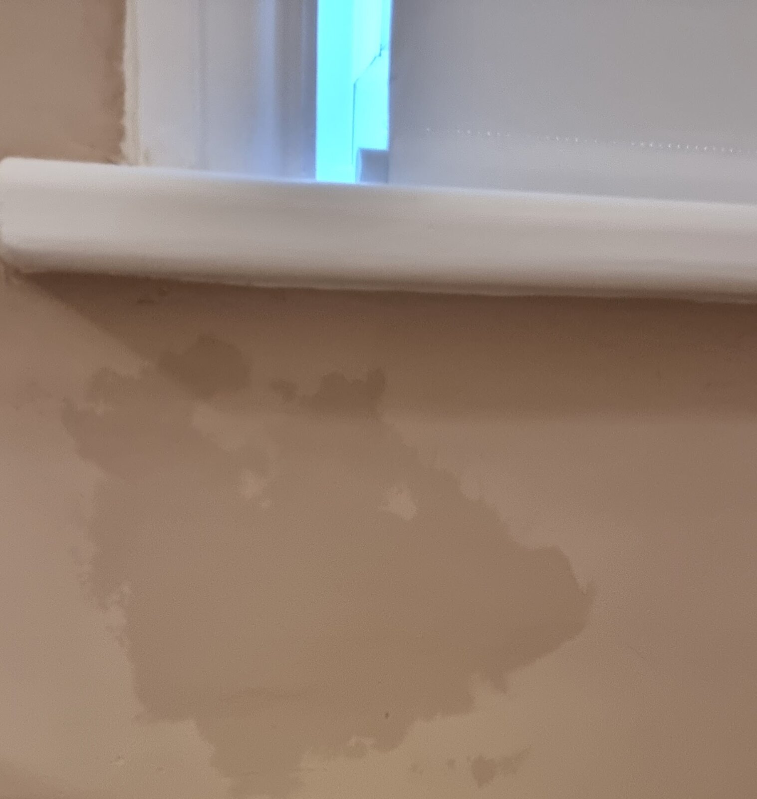

2 years ago I had a medium sized local / "reputable" company replace the windows in the house. They're a flush sash upvc profile.
I've had persistent issues with 3 windows. About once or twice a year, after heavy horizontal rain, I get damp patches on the bottom corners of the wall under the windows. Same 3 windows out of 20. Most exposed coastal corner of the house and receive a lot of rain battering.
They've been back 3 times now to remedy. However, it's impossible to test the repair until a few days of horizontal rain directed at them.
They're always polite and willing etc, however, after the recent rain the damp spots have come back. Again.
I suspect a decent repair may need more than 30 mins, some frame adjustment and sealant.

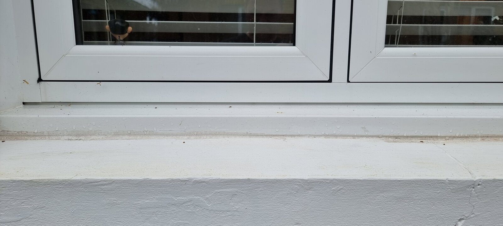

Does the window have UPVC cill sat on the stone cill or just stone cill?
Adding more sealant is not going to sort it, The trim looks like it spans the cavity and the plastic cill looks like it too spans the cavity.

So there are two potential issues...1. the windows are draining into the cill and out to the inner leaf. or 2 there is a leak above the window that is now running down to the cill and on to the inner leaf.
So when you open the window is there any wet in the window base and are there any drain holes leading down on to the cill...
Agreed
#1. Roof is fine, even checked.
There are drainage holes. Signs of moisture from dust marks but never seen any

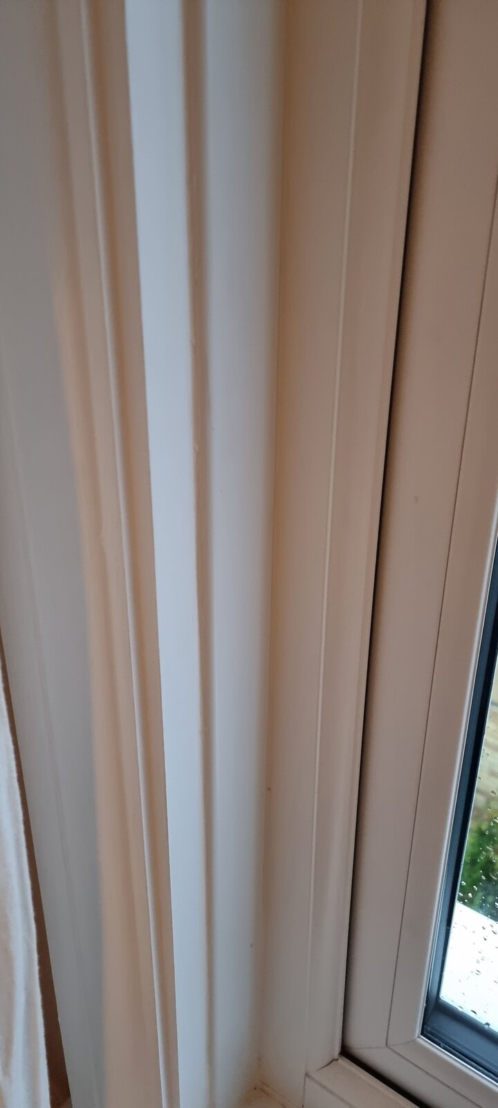

Take a photo of inside reveal please

It's possible the exterior glazing is being overwhelmed - do you know what size packers are around the glazing? (not the frame). Ideally these need to be at least 5.5mm they may not be - otherwise in heavy rains water can "bridge" and cross the gap via surface tension.

So stupid question: if I open the window and slowly pout water down the drain holes, I'd expect to see it run out of the upvc cill gap on the outside? And if it doesn't, does that mean the install is incorrect?
If you open the window, there should be some routed out drain holes, just behind the black rubber seals.
If you pour some water through these, it should come out on to the concealed cill, in reality if the window is not flat, some water will make it down to one end of the window. If you have spirit level, perhaps sit it on the cill see if it angles down to your wet patch (sounds wrongo_O).
As previous folk have mentioned, moisture/water is being carried over the inner brickwork, would have expected those windows to be brought forward. Some of mine are that far back, but I've got solid brickwork and rebated reveals.
